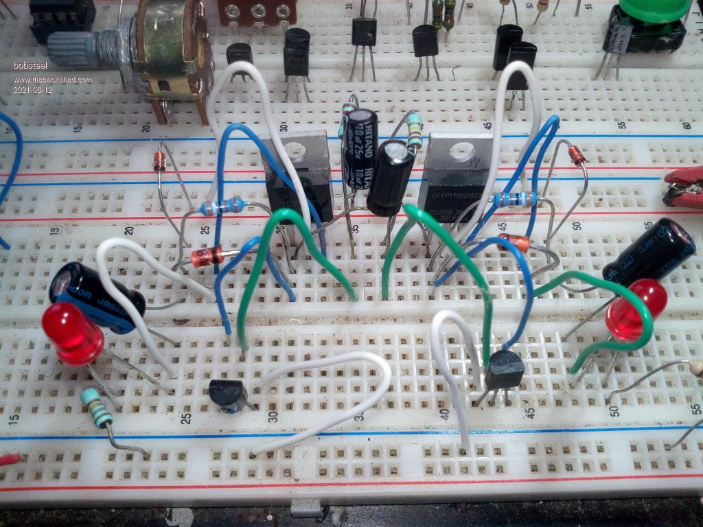

Ive spent days now trying to get this circuit to work and it won't .
Position is it flashes right led briefly then turns the left led on hard turning the right off.
As good as I can do .
Here it is on a breadboard , lets see if you can find a fault .

That was a good idea to send the picture. What are the small transistors are they the  C2655 - it looks like you have wired it as if they were 2N3904's ?
If they are C2655's swap the green and blue wires on both small transistors and try again. (ie blue to the centre green to outer).
If it gets too hard, maybe Ill go build mine again and take a picture of it.
The more than 1 function comment is described a bit better below:
The current limit resistors (3K9 on your board) for the FET gates are also the collector resistors for the multivibrator bipolar transistors. The zeners allow the 2 gate capacitors to charge when the transistor connected to its gate is on (they are forward biased  ~0.65V) and then hold the gate voltage to the value of the zener voltage when the transistor is off.  The 2 x bipolar transistors act as a multivibrator pair and also alternately control the connected FET to be on and off.

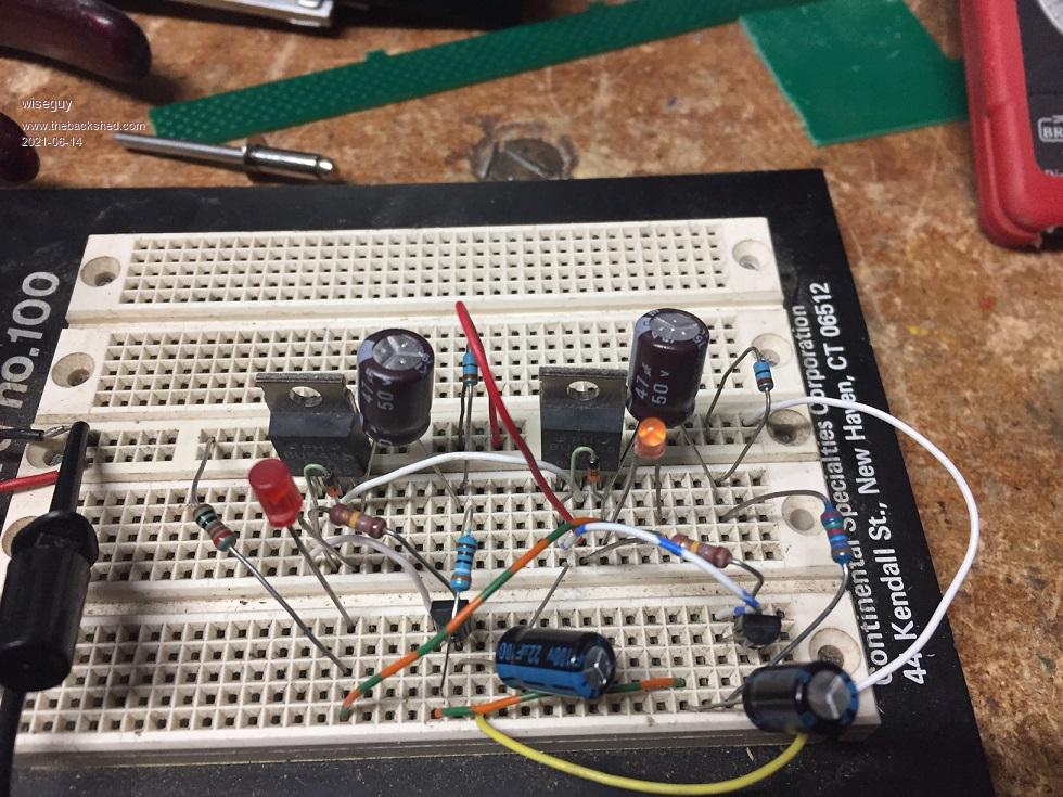

One of the first things I learned in electronics is hmmm its not working - where did I stuff up.

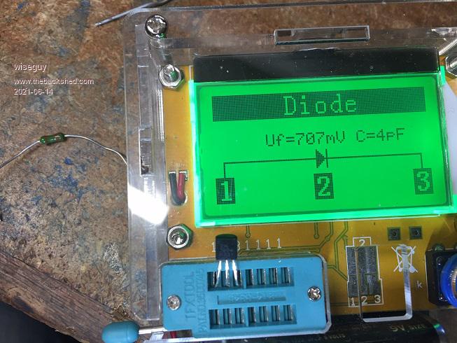

When it didnt work when I built it a second time I tested the transistors, one of the 2N3904's gave this reading from my tester:
another one gave this better reading:

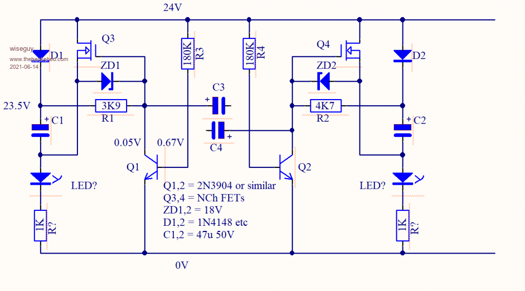

I wired it up as the following schematic with voltages shown,
note that C3 & C4 are not wired up yet:
Voltage readings are the same for both sides. When C3 & C4 are connected the LEDs should begin to flash - when its working voltage readings are now useless - they are all in motion/unstable.
Final wiring:

The component values are not critical to get it working, the 3k9s can be as high as 22K and the 180Ks can be from 100K - 270K Zener can be from 12V to 18V so don't get hung up on copying the schematic exactly.
At this point I cant help any further - you need to attack it with a fresh mindset and known good parts.

Peter is correct, for ~ 30 years I have tested FETs and Transistors with just a DVM on the diode test function and my tongue for confirming/testing gain....lol.
But since buying this tester I have never looked back it gives NCH/PCH, NPN/PNP, gain, pinout and also tests inductors capacitors diodes all in a few seconds. I have found it cuts down my time to identify & assemble something that usually works first time considerably.
I used it to confirm the first transistor, but not using it for the second transistor wasted ~ 15 minutes of my time - I assumed (Wrongly!) it was a good one being brand new.

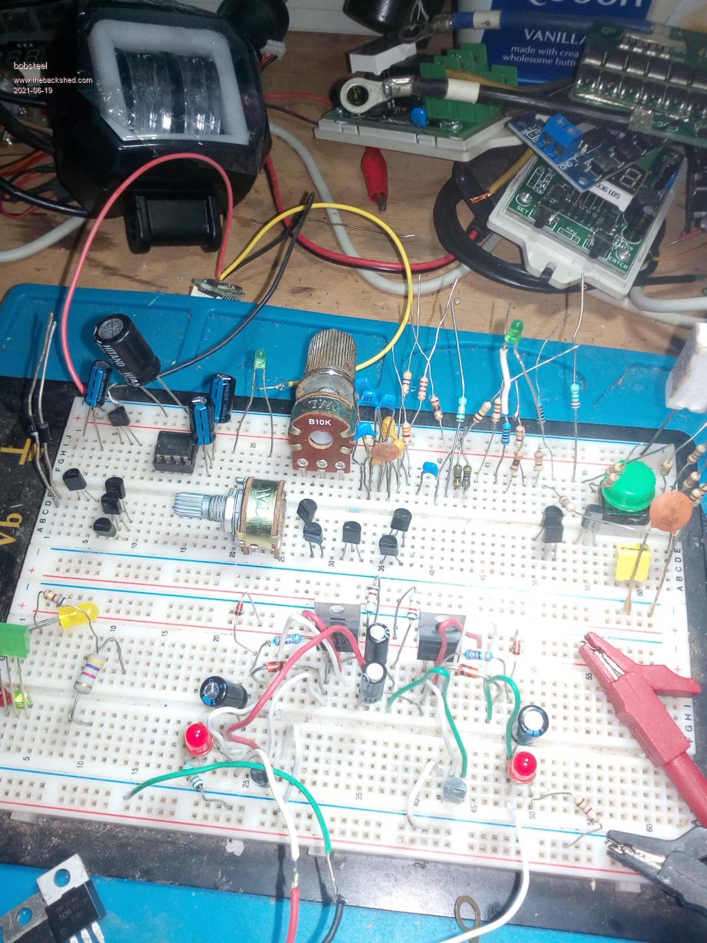

Well got it going . Thanks all.
I tossed about 4 transistors after trying your tests on them . Had a couple blown ,at least one that gave a very low reading .
I have a packet of 100 of them ,2655's so I'll have to go through them.
Video proof at Mega Site
This is with my actual LED dual lamp wired in as well.Next up that hard soldered board I made up. Tranies were shot so Ill put new in and check the board better.
