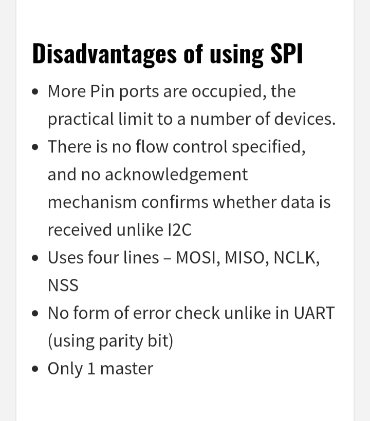

For master/slave, a simple checksum is all that's required. If not, then you have electrical issues that need to be corrected.
The vast majority of industrial CNC machinery and other motion-control applications, use quadrature encoders for feedback. These also use differential line transmitters/receivers and all these do is transmit 5v pulses to be counted by the controller. Any corruption here could result in destroyed machinery and possibly, personal injury.
And what about SPI?

  Quote  For master/slave, a simple checksum is all that's required. If not, then you have electrical issues that need to be corrected.
No self respecting SCADA system would use a simple checksum. Sometimes electrical issues are beyond your control, high voltage switching and lightening for instance. Proper earthing and shielding will help as will secure communications.
SPI, I2C and TTL rs232 should really only be used within a PCB or a shielded case. I know people use these for external communications and get away with it but it's not for me.

CRC is excellent - I'm not knocking it. However, if you are the type of person who would trust heavy rotating machinery to a RP2040 - especially at the present stage of its development - then I doubt if the extra security of CRC is really worth the hassle over just using parity bits TBH. They are both very bad ideas.
It's unlikely that most hobbyists will do much that's more dangerous than switching a light on (and the biggest risk is probably that they'll use a 30vDC rated relay to switch 240vAC) so I think there's plenty of justification for keeping things as simple as reasonably possible, initially anyway.
There's no real reason not to use i2c over most domestic distances and forget having to use drivers etc. It works well enough if you only need a single talker and avoid running the wiring in electrically noisy environments. You can also use logic level UARTs for multi-drop if there aren't too many stations.
SPI is great - especially if you can daisy chain devices. *Very* fast. Not a lot of use for off-board communication really though.
