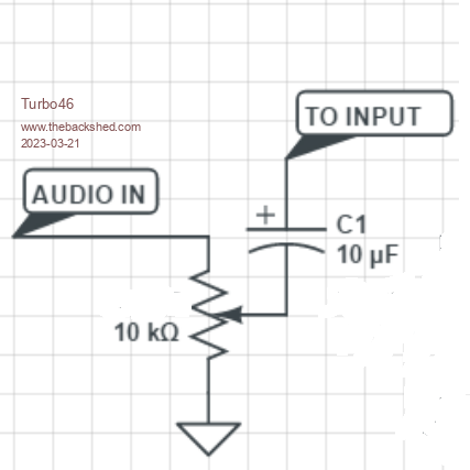

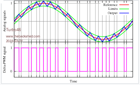

Can I summarise a few points here.

- There IS audio at the output of the filter - see the attached diagram:
The output is the blue jagged line. The more aggressive the filter is the lower level of 'jaggedness' there will be in the output. This is why I asked Volhout for a two stage filter cutting of a around 5kHz. Notice that there is a DC offset in the audio signal.
- The volume control pot for an amplifier must never pass DC. This causes a scratchy noise particularly when it is turned. See the attached circuit:
The capacitor needs to be reasonably large because it needs to pass the audio signal frequencies recovered from the PWM.
