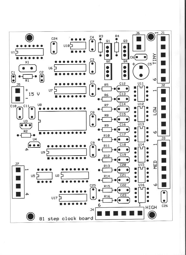

What I have at the moment is one fully functioning 27 step inverter, plus one bare empty spare circuit board.
My 2.9 Kw 81 step inverter is now complete with metalwork, transformers and wiring, but without any circuit boards for it.
I have the artwork file here ready to go, but just have not got around to getting any boards made. There is always something more urgent to spend money on around here.
I am about to pull the trigger on buying a 6Kwh Lithium battery which will wipe me out financially for a while, so no plans to get any of these boards made in the very near future.
If a few people are interested we could share the costs on some boards and do it that way.
Also, I can program anyone's 27C16's with 81 step data if they supply the eproms and return postage, and I will toss in a 3.2768 Mhz crystal for free as I have a hundred of them here I will never use.

The logic behind the transformer design will go something like this.
For 5Kw we are looking at creating 240v rms at say 21 amps rms.
That will require a peak output voltage of 340 volts.
To generate 340 volts, the combined voltages of all our secondaries must add up to 340 volts when all the inverters switch on together in the same direction.
Our inverters need to have output voltages where each successive inverter has exactly one third the output voltage of its predecessor.
So for four inverters the voltage of the largest will be X volts.
The next stage down requires 1/3 X or 0.333X secondary voltage.
Third inverter will be 1/9 X or 0.111X secondary voltage.
Fourth inverter will be 1/27 x or 0.037X secondary voltage.
If all four inverters switch on simultaneously the output voltages all add together.
1.0X + 0.333X + 0.111X + .037X = 1.481X
Now we know 1.481X must equal 340 volts
So X needs to be 340/1.481 = 229.6 volts.
(If there were only three inverters 1.444X would equal 340 volts.
And X would be 235.4 volts).
For four inverters the largest transformer will need a square wave secondary voltage of 230 volts and a rated current of 21 amps for 5Kw.
The next stage down will be 1/3 of that or 76.666 volts, also at 21 amps rms.
Third stage 1/9 of 230 volts or 25.56 volts at 21 amps rms.
Fourth stage 1/27 of 230 volts 8.52 volts at 21 amps.
We are dealing with only square wave voltages, so rms voltage is not applicable. We just use square wave peak voltages for calculating the transformer ratios.
But the secondary current will be a sine wave !! And that current will always be there in each secondary, even when a particular inverter is outputting zero volts (shorted clamped output) so we must use the 21 amp rms secondary current for calculating secondary wire sizes.
The largest transformer with 230 volt secondary is most fortunate, because we can use an existing transformer primary as our secondary. And with luck we might be able to use the second original winding as the clamping winding. That then only requires the addition of a new low voltage primary to suit our battery voltage.
The problem might be that there is simply not enough room left for a heavy enough third primary winding. In that case we may be stuck with having to use just the original 230v winding already there, and our new big welding wire primary, and put our fully floating zero volt clamp right across the 230v secondary where the current will only be 21 amps rms maximum.
All this should be pretty familiar territory, and if you already have a failed PWM project, the chances are that the transformer you already have will work with just some additional primary turns added to it.
The PWM transformer needed to generate 340 volts peak from the original battery, we only need to reach 230 volts peak from the same battery voltage, so about 40% more primary turns will be required than on an Oz inverter transformer. This is very good, because it reduces the flux swing in the core by 40%, and that will be hugely beneficial to reducing inverter no load idling current.
All this is the very first thing to do. Get just the big inverter going by itself, and test it with a 20 amp load so you get a 230v peak square wave output, and make sure all is well. I would expect the idling current to be very low, and that will be a very interesting thing to see.
I will go into details of the other transformers later. The big one is going to be the most difficult only because of its size and weight.Edited by Warpspeed 2017-03-20

Posted: 11:20am 19 Mar 2017
  Tinker said
May I ask for a schematic what is connected to J1 to J4? I know its the mosfets but I like to study how you did that.
Oh sorry Tinker I almost forgot.
J1 to J4 are the outputs to each of the four inverters.
Pins 1 and 2 provide +/- 15v at 50 Khz continuous square wave power to provide isolated dc voltages for the mosfet gate drivers via small pulse transformers.
I did it that way because I already have a quantity of suitable pulse transformers I wished to use up.
There are different and much better ways to do it, but it suited me to do it that way at the time.
Pins 3 and 5 are drive to the inverter which could be half bridge, full bridge, or push pull topology.
Pin 4 drives the zero volt clamp, it provides the third "off" state for the inverter when it is not being driven "on" in either direction.
The whole thing has been an evolving project, and originally I planned to use push pull inverters with a floating clamp winding. That meant all my mosfets would have had grounded sources, and this clock board could drive the mosfet gates directly.
A much safer way, especially for higher voltage or higher power, is to use the outputs of the ICL7667 mosfet gate driver chips to drive opto isolators, they are perfect for that. and that is how I recommend all the mosfets be driven.
If every mosfet gate has its own fully isolated gate driver, it solves a lot of grounding and noise problems. It also minimises fault escalation if something blows up.
Nothing worse than having +48 volts find its way back to the +5v rail through a chain of exploded chips. If the power stage is isolated by optos or pulse transformers, any destruction stays pretty well localised.
I tried to post the schematic of my power board, but the server comes up with an error.

Posted: 02:24pm 19 Mar 2017
Those 7667's are really good to use, the input logic threshold is 1.5v not 2.5v as is usual for most 5v cmos logic chips. That enables us to use a simple RC integrator to generate dead time without needing a diode. The output switches very fast rail to rail and has a ton of drive capability. They do however invert the signal, so data in the eprom has to be the compliment (inverted) to what we eventually require.
Output at the J1 to J4 connectors is the more useful logic hi = mosfet on.

Posted: 04:33pm 19 Mar 2017
Those 7667 chips also have a Schmidt trigger input for jitter free dead time.
Cross conduction is only likely to be a problem during power up and power down, when the various power rails are slowly changing in an unpredictable manner. Undervoltage chip U4 holds the main counter in reset at 4.2 volts and under. Do not leave this feature out !!!
If doing all this inside a microcontroller, power up and initialisation of the port should be pretty straightforward. But powering down may have some hidden problems.
Careful thought needs to be given to what happens if you reset the microcontroller with the software running. It should be o/k but it is something to think about.
I found a sneaky way to add cross conduction protection to the opto isolators on the FET board.
Will try again to post the circuit.
I think the Forum server needs its nappy changed.
Edited by Warpspeed 2017-03-21

Posted: 07:38am 20 Mar 2017
Tinker,
We are connecting four different "power sources" in series to drive a load. By switching them on and off in a particular sequence we can make them add or subtract to generate voltage steps.
But we cannot just open circuit the individual supplies we do not need when they are connected in series. The unused supplies must be SHORTED OUT to provide a continuous current path through the series string.
The basic building block to do this, is a bi directional ac on/off switch using either mosfets or IGBT's. Both the sources and the gates are tied together.
When both mosfets are off, the switch is open circuit in either direction . When both mosfets turn on together, we get current flow in either direction with one diode voltage drop.
For higher voltages IGBTs are preferred over mosfets, but the particular IGBTs must have the inverse diodes fitted. Some have these internally, some do not. Mosfets all have internal inverse diodes.
Still cannot upload pictures.................

Posted: 07:59am 20 Mar 2017
O/k I will try doing this through Photobucket.
Hooray it works.
Now one of the three (four) power boards.
Notice that the opto isolators are connected in inverse parallel between the +ve and -ve drivers. It is impossible for both to turn on together. The NAND gate U2 on the clock board pretty much guarantees that the clamp cannot operate if either +ve or -ve driver is active. Its the last line of defence for a spurious cross conduction accident if the eprom data corrupts.
Here is the 81 step schematic again, it might come out a bit higher resolution.
