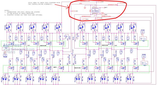

checkout " A newbie ozinverter build" by tinyt
on page one tinyt has produced a very good schematic pdf file of
both the power board and the control board .
As Revlac has said the gate source paralleled bleed resistors
my power board gate source has a effective bleed resistance of approx 3k3 ohms
cheers john

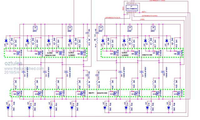

Pins 3 & 8 are the low side gate drive, I have not put a meter on it but I would have thought they would be closer to ground than 50V. Mark what voltage do you get on pins 4 & 7?
2018-05-03_220947_2018-02-16_025148_EXP_POWER_BOARD_SCHEMATIC_P1.pdf

Pins 4 and 7 nothing, only pins 3 and 8 do I get voltage and of course the two parallel pins at either end, between 1,2 and 10,9
cheers john
Thanks for pointing that out John, I must have missed the original posting.
Now I can see what you guys are talking about
That schematic version mad posted is a bit confusing with all these gate diodes, I think one Schottky diode is plenty here .

Posted: 03:20pm 03 May 2018
  Tinker said  .......
You are right to use the schottky 1N5817 instead of the signal diode 1N4148. Even though the schottky has a higher leakage current and slightly higher Trr, I think it is better for this application because of the lower forward voltage drop at higher forward current. The 1N4148 is a flow down from the EGS002 schematic and I just kept it.

Doubt the forward voltage is important, as the HY4008 turns off below 2-4v, so the extra .5v is not material.
I would keep the 4148 and throw away the schottky. 4148 is 250% faster, so any hysteresis in the system will come down faster.... ie we are closer to real time.
Forward current pulse is 2000ma for the 4148, repetitive is 500ma.... and we are only getting rid of 31nC of charge... in parallel with a 5r6 resistor.... and we only need to get it below 2-4v for full turn off.
The EGS002 folks think the 4148 is fine.. and I think so too.

So pos and pins 3,8 gave 50v.

I think this is my latest circuit trace of that design. This now has that missing capacitor.
2018-05-04_074827_Oztules_Control_PCB_and_Power_Board_Schematics.pdf

Revlac
Joined: 31/12/2016
Posts: 1310
Posted: 11:12pm 03 May 2018
Mark I found a short on my board that i didn't see in the dark last night
So it's worthwhile checking every thing through, is it easy enough to take the fet out and try the voltage again?
Putting the battery leads the wrong way around gives me that result as well without the fets in
Nice schematic there tinyt. Edited by Revlac 2018-05-05

Nice work there Tinyt....
I will steal this for my files... ... even if I think better with the circuit board view.
