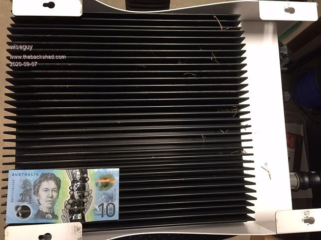

Thanks Poida and Mark, I was given an inverter yesterday "Solar River" that was certainly up the creek.
It provided some donor screw terminals so thanks for your offers but I have enough for my board now. It also had the biggest most generous heatsink I think I have ever seen.
I'm guessing ~ 300 x 350mm. Unfortunately transformer-less, lots of good capacitors etc but everything is glued so rigidly to the board and Im not sure I can be bothered, maybe the 2 x  current sensors but I think the rest might just be binned, I'm slowly learning to be a much more selective hoarder.....

One of the happiest sights for me now is to see a big heatsink.
A big, zero cost heatsink. OH yes.

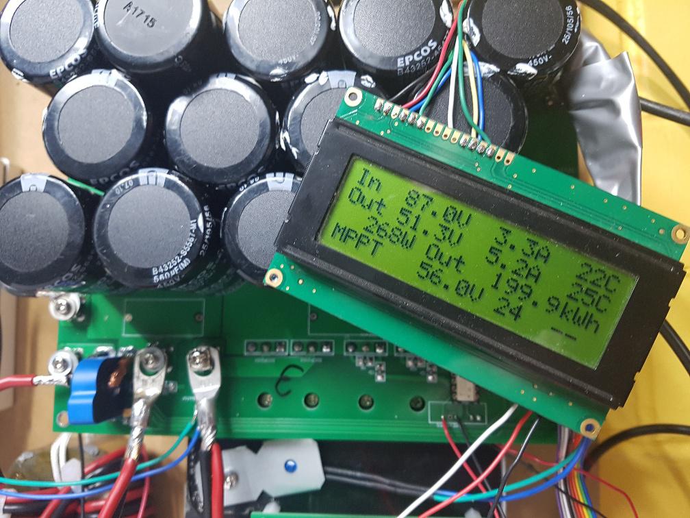

Posted: 11:56pm 12 Sep 2020
It's got to 200kW.hr
No problems at all.

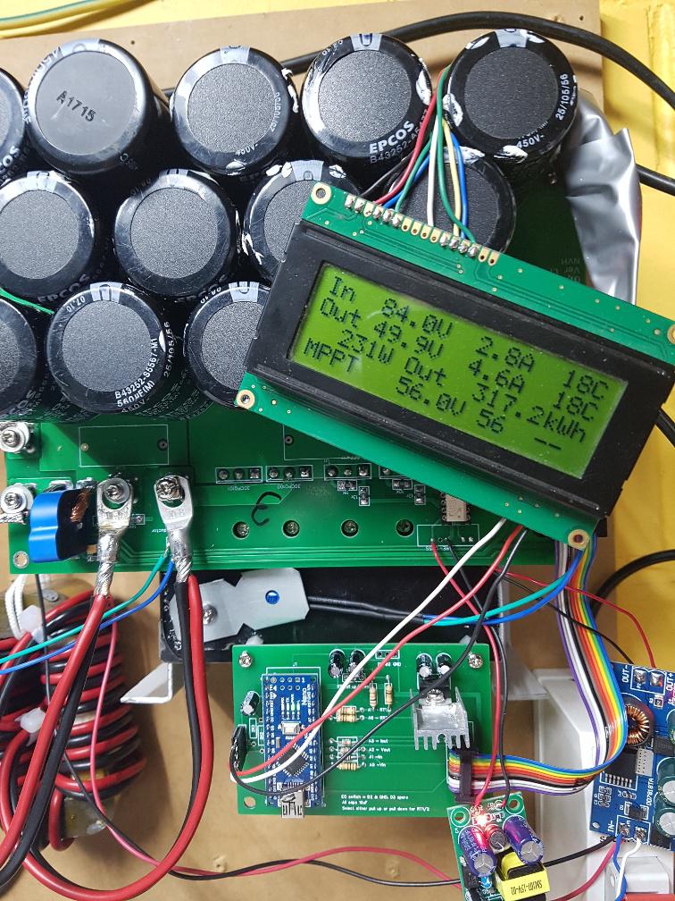

Posted: 09:54pm 06 Oct 2020
Now exceeded 300kW.hr
This is board number 3 which I built with whatever was available.
In particular, I used a small isolated 240V -> 12V supply that runs
down to 40V since I used the proper 12-12 isolated supplies on previous
boards. And I had no screw terminals for cables left so I soldered plain
washers onto the ends of cable. A rather rough and ready assembly.
This design will do the job for me.
In the near future, I will make small changes to the code to support
battery temperature compensation. The thermistor derived temperature is
always going to be a bit out so an offset trim value will be added to the menu.
And some limits to the temperature correction function.
