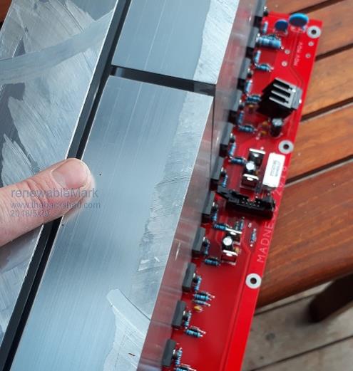

Posted: 05:15am 29 May 2018
Hey guys, is this far enough apart?
I had the Clockman one set up a bit further apart.
Just wondering if any wierd interference can float from one to another if they are too close?
Cheers Caveman Mark
