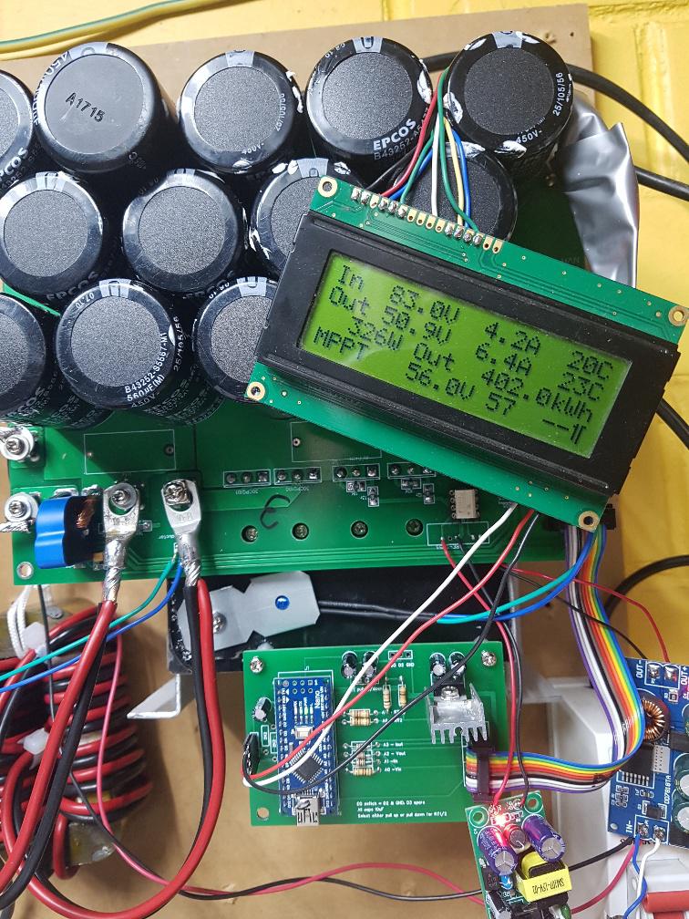

400 kW.hr
all good.

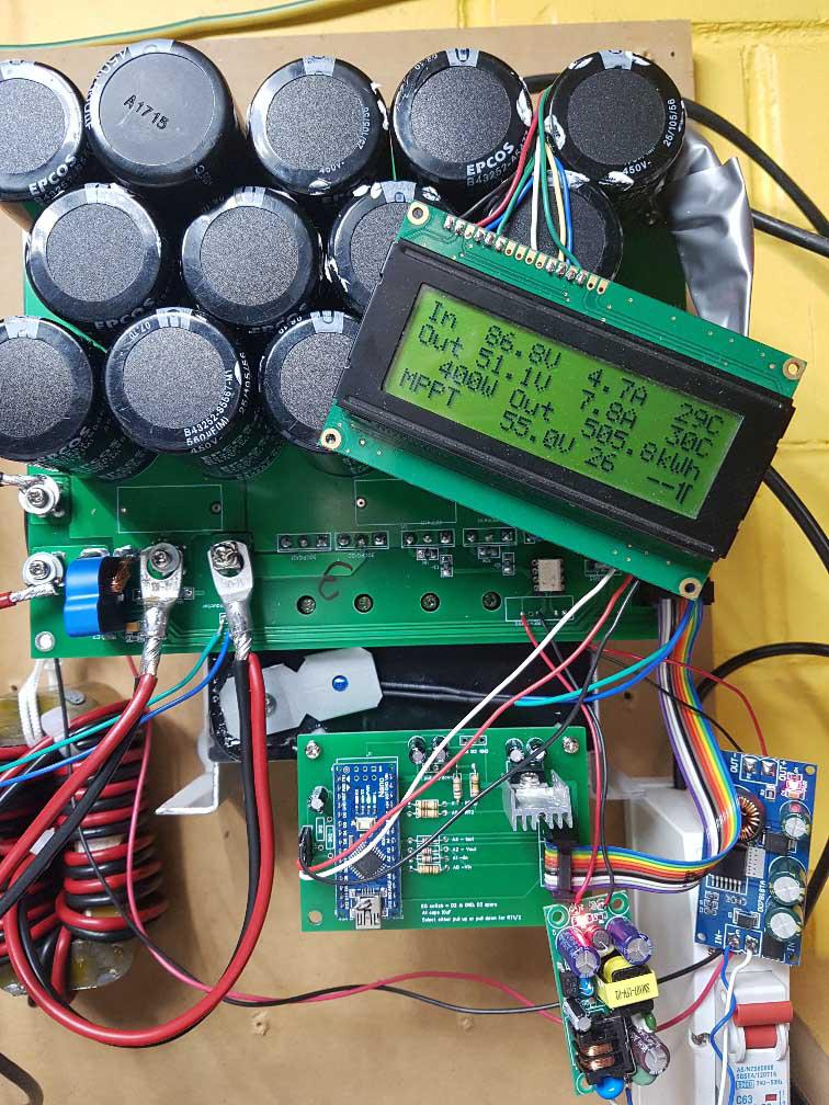

Still running perfectly. 500kW.hr
The only problem which remains unsolved is
how to pack all this into an enclosure but keep
the size of the box small.

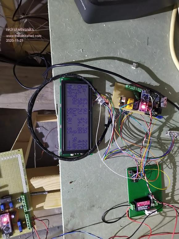

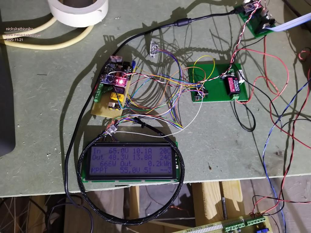

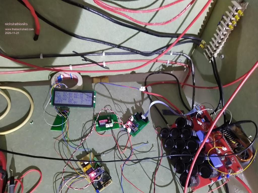

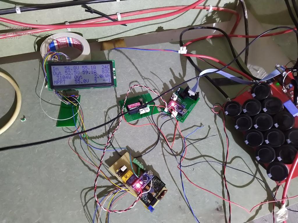

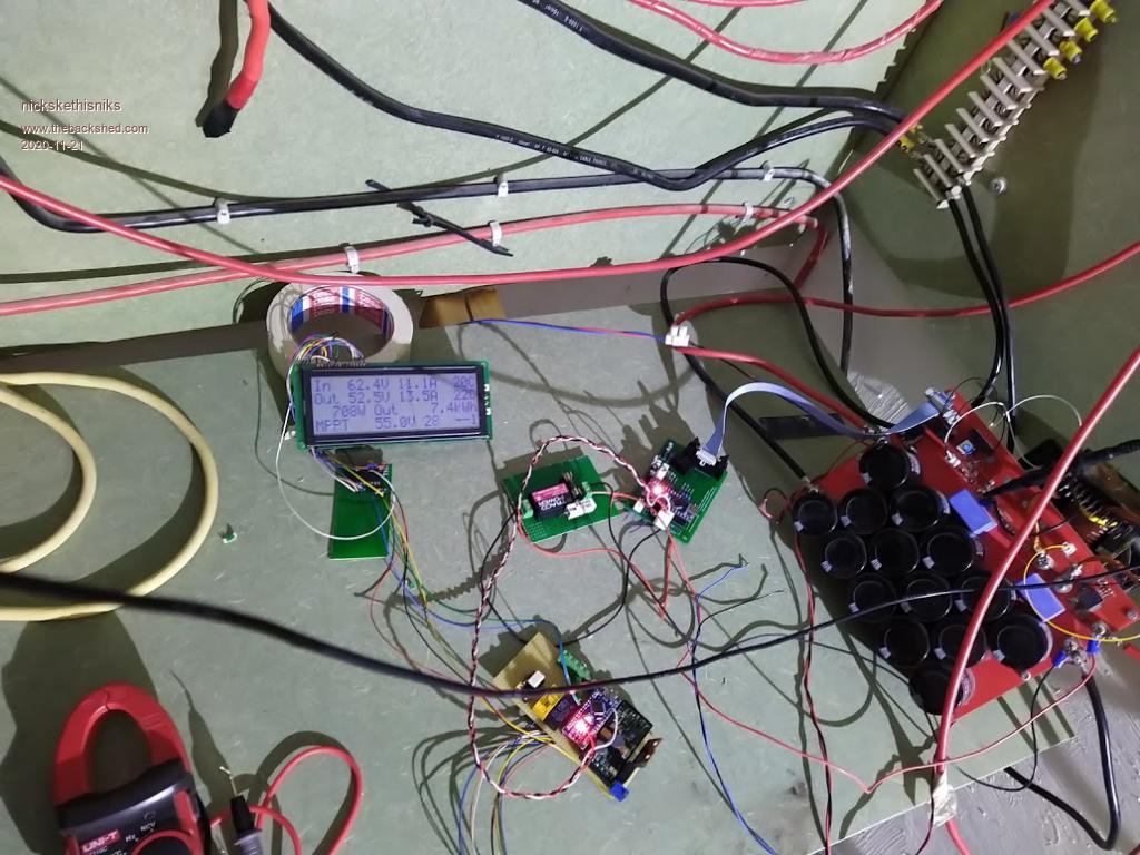

So today I had a little time to test Peter’s brainbord on my main solar controller. Exciting…. :p
Because I took another power pcb, so other component tolerances I had to do the calibration all over again, but I’m trained now. It’s actually going verry smooth now I know all things I need to think about now. Even when full solar and battery were connected I could set all the parameters without things blowing up.
Yesterday I had problems with my LCD screen, very sensitive. But as expected my wires were to long between my lcd and pcf8574, added 100nF to the 5V line on the LCD, and 100nF + 1µF close to the pcf8574, all problems solved.
You see a few boards but it's because I reused a board from another project.

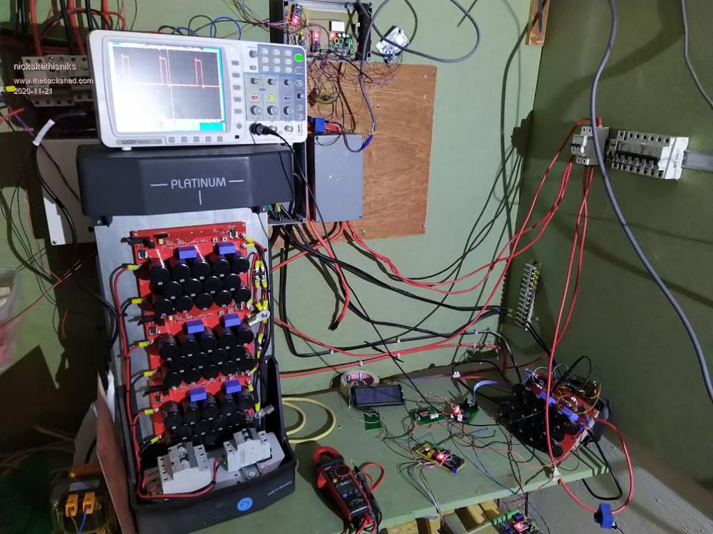

This is my testing setup, yes there is some work left to make everything a bit euhh... :p
Early morning testing with low battery, here an mppt controller makes a lot of sense, 10A in almost 14A out...
1700W going in the battery:
Power keeps climbing, temperature of inductor was climbing under those currents so I switched on the fan. I need to figure this out.
This was about maximum power level for today, that is for a +-6700Wp array.
Evening energy harvest:
One thing I noticed was that the voltage-in was dropping under high power, I think this has to do with some things:
--> voltage drop in the cables + brakers, my testsetup is not well dimensioned
--> there is a lot of 100hz voltage ripple in my system, there is also the backfeeding and loads that are creating voltage ripple and maybe upset the program.
--> the inductor is not really designed for more then 30A, so it's probably saturating at this point.
--> There is some ringing around the mosfet, about 15V-20V at high power levels on top of the input voltage.
--> the driver power supply is providing more then 15V, so I probably need to adjust the gate resistors or lower this voltage.
--> I need to check the resistor before my gatedriver, 1100R is to high, should be more like 390R for the FOD3182
--> the inductor is making a bit of noise when looking for the mpp, but I guess that's something physically.
--> There is little time during the day my panels are not shaded, that's why I will use 3 controllers for the roof of my house.
Votage and current readings were verry stable, and the acs sensors were consistent,  and need a stable voltage, I think there will be some drift under temperature changes, but it wont matter for the algorithm.
For the record I'm using 1000uF capacitors, I know the program was written and based on other parameters but it's really working great.
I'm using a traco TEN-3-4812WIN power supply powered by my battery, it has 18-75V input range and 12V 250mA out, it's not cheap (12.5€) but should be reliable.
But the brainbord is realy a great thing, this makes my powerboard a very powerfull and programmable device, I'm verry verry satisfied with the performance!
Edited 2020-11-21 06:24 by nickskethisniks

Hi Nicks!
I'll try to answer some questions and comment on things. This is a big post of yours.
  Quote  For my first version I had to place the ribbon connector 180° twisted, not a problem. I don’t know how it is with Peters and Wiseguy’s version?
Yes, that is the way it is. For those of us using Wiseguy's board, the ribbon cable
is located normally with the notches as indicated on the silkscreen. You and I Nick need to rotate one end 180 deg.
  Quote  In my first design there was no 10uF capacitor for the mosfetdriver, only 100nF, with the TLP250 this was not a real problem, with the FOD3182 this caused instability problems in the gate drive and gave rubbish in the µC.
not a problem, I put 4.7uF cap across the TLP250 supply anyway. SMD sometimes allows
piggyback components so it's easy to do on your board.
The 5V supply needs to be strong enough to do all the jobs needed:
power uC
power LCD and nano for LCD
and give a repeatable and reliable 5V reference for ADC channel conversion.
I always calibrate with the external power supply via the 12V input of the brainboard
present. This ensures 5V reference is available and good.
It's great to see you using the brainboard software. I am not surprised the LCD is unhappy with all the long wires and strong EMI.
The reason Voltage-in was dropping is due to the power verses voltage curve of solar panels. When taking small levels of power from a panel or array, the panel voltage will be nearly as high as open circuit. Once we take a lot more power from it, the panel voltage will drop to near maximum power point for that array.
As the sun changes angle to the array, this power/voltage curve changes too
So early in the day, max power is found with higher panel voltages (65V) for these low levels of power available. Midday is max power so things change and max power voltage for the panel is lower.
I do not think is has much to do with the things in your list above but then
the truth will be come evident in the fullness of time.
I do not like the 85C inductor temperature. That is a lot of waste energy heating
the inductor.
Lastly I am very pleased to see that the program is working well.
It appears this design has a large scope for varying key components and still
operating well.
Feel free to alter the firmware to suit. In your case I would do tests for both heatsink and inductor temps and run a fan when limits are exceeded.
The ticking noise during the MPPT scan is when the firmware ramps up the PWM in steps
from 5% to 95%. The step changes are sudden which excites a bit of high freq. oscillation of bits.
Edited 2020-11-22 08:45 by poida

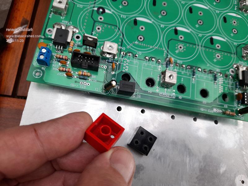

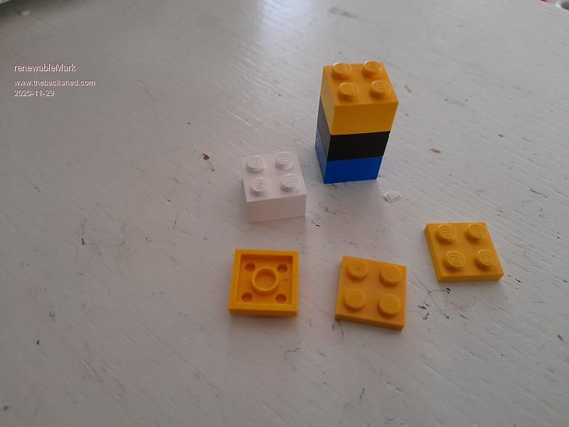

renewableMark
Joined: 09/12/2017
Posts: 1679
Posted: 11:24pm 28 Nov 2020

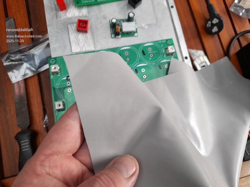

Finally putting this together.
I found 2x2 lego blocks with the interlocking studs cut off make a nice stand off.
They have an inner cylindrical sleeve too.
Cheers Caveman Mark

Posted: 11:36pm 28 Nov 2020
Lego is probably a good idea as you can make up whatever height you want too.
Cheers Caveman Mark
Off grid eastern Melb
Posted: 12:15am 29 Nov 2020
Now that is really clever !

Peter, I gave you some of this stuff, is it OK to use for isolation?
Cheers Caveman Mark
poida
Joined: 02/02/2017
Posts: 1515
Posted: 09:31pm 29 Nov 2020
I used it for isolation of the 2 FETs and the two FET/diodes.
It worked fine.

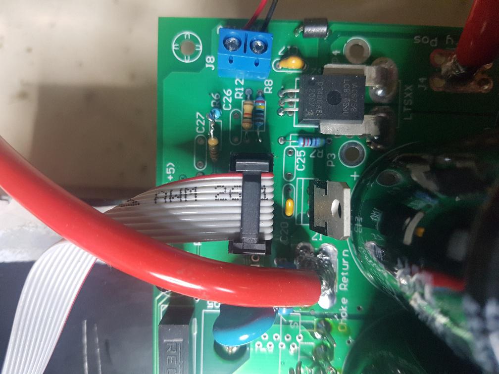

renewableMark
Joined: 09/12/2017
Posts: 1679
Posted: 09:15am 30 Nov 2020
Cheers mate, so no need for a copper bar?

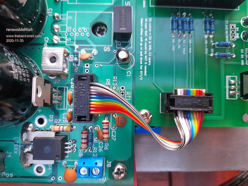

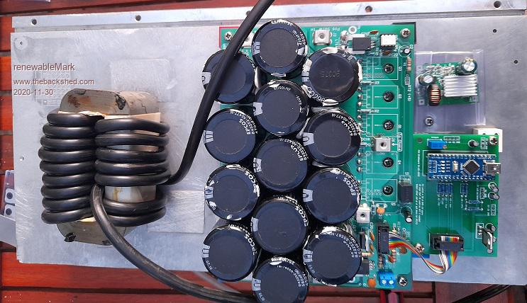

I'm getting closer to finishing, is that cable oriented the right way?
I kept the same colour where the arrow goes on the plug when you make it up.

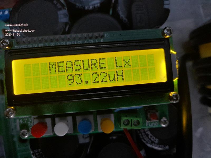

I found some 6 B&S or 13.5mm2, and got 17 turns, I can't find my inductance tester though. That size cable should be fine yeah?
Cheers Caveman Mark
renewableMark
Joined: 09/12/2017
Posts: 1679
Posted: 09:23am 30 Nov 2020
Found it.
I squeezed in one more turn and got 102uh
Edited 2020-11-30 19:42 by renewableMark
Cheers Caveman Mark

poida
Joined: 02/02/2017
Posts: 1515
Posted: 10:17am 30 Nov 2020

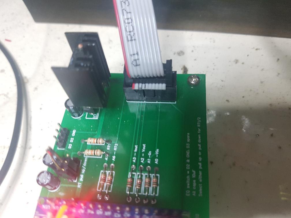

when using wiseguy's boards, as you are Mark:
make a 10 pin IDC cable. Pin 1 goes to one end, as does pin 1 go to the other.
Note how the locating notch fits on the powerboard and the brainboard.
On the power board, the red wire is pin 1 and on the right. The locating notch faces
LEFT in the photo.
cable is now illustrated connecting to the brainboard.
See how the notch is on the side leading to the nano.
It appears you have the cable orientated correctly.
If there is any doubt, use the multimeter and determine 12V and ground pins
and see which pins are 12 and ground for both brainboard and powerboard.
Getting 12V pins correct is all that is needed to get all the others correct.
No need for copper bar. Things do not get stupid hot, just warm.
Edited 2020-11-30 20:26 by poida

Hey Peter, I'm a bit confused.
Earlier you tested a large aerosharp core with 16 turns and got 133uh.
I wound 18 turns and got 102uh.
So either my POS chinese meter is in fact a POS, or we are referring to turns a different way.
I have been defining it as one pass through the centre.
Is that how you define a turn?
Cheers Caveman Mark
