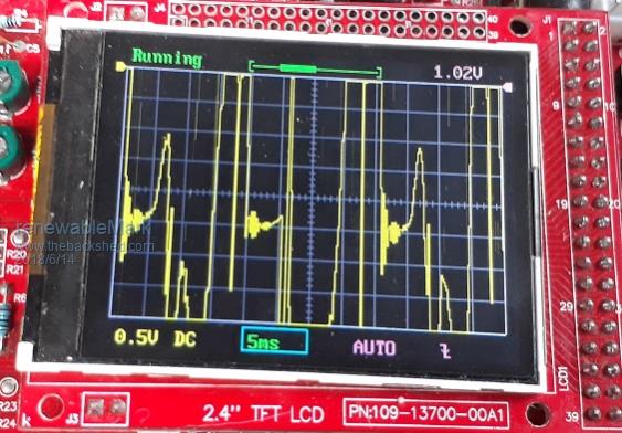

Posted: 06:37am 14 Jun 2018
OK I found why it only gave one quick buzz and stopped last night, the control board lost the 18v, so after the zener was fixed it worked again.
Did all the other tests and it appeared to be ok so hooked up the toroid with a resistor set and fired it up.
There was a terrible buzz and the wave looked like spew.
Tested the resistance of the fets after that and the ones connected to the big heat sink are all fine but the ones connected to the two smaller heat sinks all show 180k.
Reckon I'll de solder one and see if it tests the same off the board.
Don't understand how they could be damaged only a couple of amps could have gotten to them.

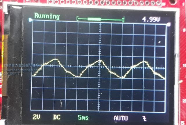

Well I found the 8010 had fried.
I replaced that and tested it with resistance fed power.
Got a reasonable wave so then went to test with no resistance and the square wave fets on the small heat sink went BAM.
Got me stuffed why that happend it looked fine under resistance.
Checked the conrol board on it's own again and it was ok.
I'll test the totems tomorrow and fit new fets.
Might be an idea to fit new driver chips in case they got compromised.
This was the wave under resistance fed supply.
Cheers Caveman Mark
Off grid eastern Melb

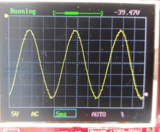

Madness
Joined: 08/10/2011
Posts: 2498
Posted: 08:24am 17 Jun 2018
What did the SPWM and square wave look like, the picture above doesn't look right to me. The voltage levels are lower in the pic above but should be more like this one you posted a while back.

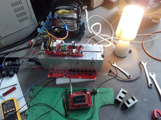

Posted: 03:59am 18 Jun 2018
Persistance finally paid off.
Need to fit caps and do a proper power test, but I'm happy it's running!!
Voltage is a tad high @280, I put in a 10k resistor instead of the 7k5 but will need higher? Or is something else wrong?
