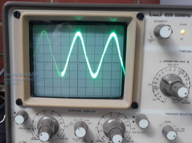

Ended up having to go down to 5k1 and it's happily running @227v
Finally got a newer scope, bit late but will help on build no 2.

Posts: 2498
Posted: 04:59am 18 Jun 2018
That scope is much easier to compare that looks good. Without the choke and cap on the Toroid primary you get a wider trace due the 20KHZ from the SPWM not being filtered out.
That wave looks excellent .
Do yourself a favour and look at the waveform on each side of the IR2110's, then at the 20 Ohm resistors on the power PCB and then at the 4 sets of MOSFET gates. Know what the should look like will be helpful later on.

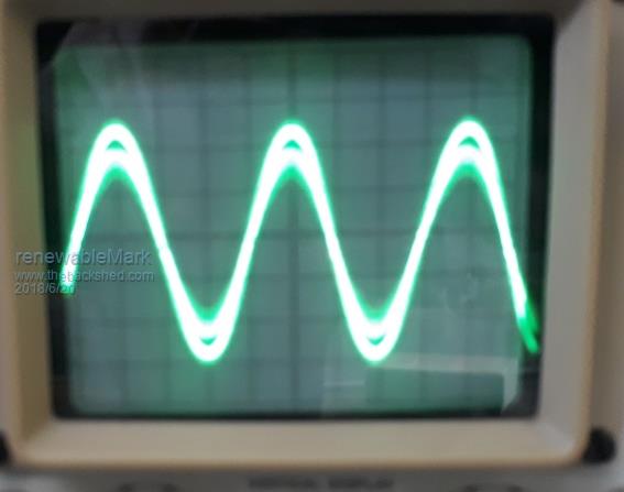

Posted: 06:12am 20 Jun 2018
OK got it running on no restricted power and with caps.
Did a 1200w test then 2400w test.
@2400w the wave went a little bit funny as per pic.
Also no load draw is 1.4A so something is not quite right.
I'll play around with the choke tomorrow and use the infra red heat gun to look for hot spots and scope the signal through again.
But it ran the blowheater without going BANG.
Cheers Caveman Mark

Madness
Joined: 08/10/2011
Posts: 2498
Posted: 06:24am 20 Jun 2018
Have you got the Choke, capacitors and filter in circuit?
Also are you using just one channel on the CRO?Edited by Madness 2018-06-21
renewableMark
Joined: 09/12/2017
Posts: 1679
Posted: 06:31am 20 Jun 2018
Choke and caps no filter.
And yes just 1 channell.Edited by renewableMark 2018-06-21

renewableMark
Joined: 09/12/2017
Posts: 1679
Posted: 07:43am 20 Jun 2018
with no load the wave did look different, it wasn't as sharp as it was before I put the caps in.
Perhaps one of those is dodgey.
Cheers Caveman Mark

Madness
Joined: 08/10/2011
Posts: 2498
Posted: 08:11am 20 Jun 2018
I doubt it is a capacitor, never seen anything like that, what does look like on your LCD CRO?
Also what is the Idle current?Edited by Madness 2018-06-21
renewableMark
Joined: 09/12/2017
Posts: 1679
Posted: 08:31am 20 Jun 2018
I haven't tried the lcd cro, will do tomorrow.
Idle is 1.4A which is a tad high, can't remember what the other one was doing, but I'm pretty sure it was a lot less.
With no load, just the machine turned on the sine looks different than it did before caps.
The only changes I made were adding caps and putting on heat sinks to tip 35's on control board and power board.
The heat sinks shouldn't effect anything, but I'll take them off, then maybe swap the caps from the other Clockman inverter.
That might be a long shot (and a pain in the ass) but they are known working parts.
Cheers Caveman Mark

Posted: 08:51am 20 Jun 2018
Mark, a tip for your CRO:
turn the brightness way down for taking pictures, you can then adjust the focus very sharp. If your camera has it, use a night shot setting.
Handheld camera is always tricky, best on a tripod.
Also, take pics in a darkened room so the screen reflections are less.
About your trace, you should have that 2uF mains cap (next to the little tranny) in place. Take your CRO probe from there. Double check the second channel by turning its input select switch to ground.
Madness
Joined: 08/10/2011
Posts: 2498
Posted: 09:04am 20 Jun 2018
Have you tried the other control board you have? Idle current should be around 1A. Can't help thinking there is something in the way you have your CRO set.
I find best results like Tinker says with the camera is turn down the CRO brightness, I find works best with my phone with it so low so you can barely see it. That makes the exposure time increase so I can get a full sweep of the trace in the image.
I would be leaving the caps alone for now at least, see what the LCD cro gives you.
renewableMark
Joined: 09/12/2017
Posts: 1679
Posted: 09:26am 20 Jun 2018
OK, thanks guys, I'll do that and report back.
Cheers.
BTW the torroid did hum a bit with no load, but went nice and quiet @2400W so it kind of tells me it was happy, but that wave looked funny.
I was checking the wave from a 240/12v transformer that was connected at the torroid. That was an extra one I fitted on the torroid itself, so I should be measuring it from the control board, ok, I'll do that tomorrow.
Edit, checked last unit and it had a no load draw of 0.48A, so with the same torroid it should be similar, something is a tad amiss.Edited by renewableMark 2018-06-21
