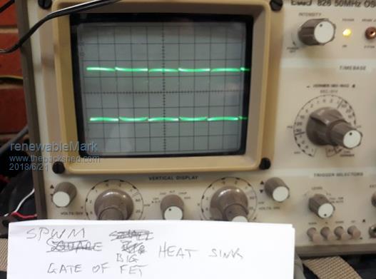

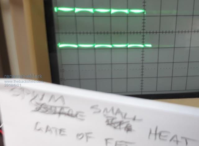

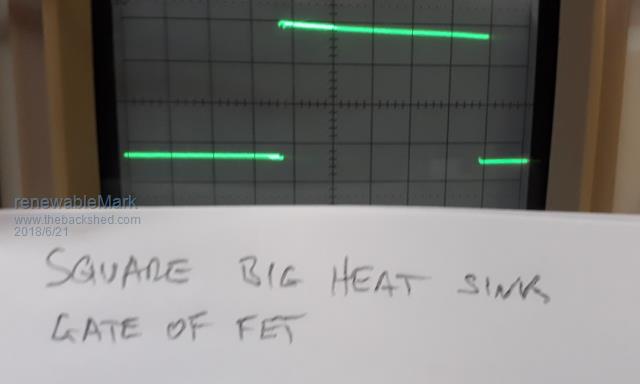

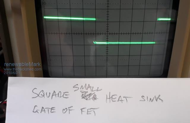

Ok I put the Clockman control board on the Mad power board and it still did the same thing, 1.4A no load.
Ran the Clockman control and power board on my torroid and it was fine, no load was 0.7A, looking back in the thread it was 0.48 but that was before caps got added.
Anyway that tells us the torroid should be fine and control board also.
Looks like something in the power board.
I tested the gate of every fet and they all looked the same as the other ones in their sets.
Pics of signals as follows.
Cheers Caveman Mark
Off grid eastern Melb

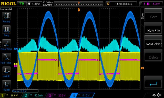

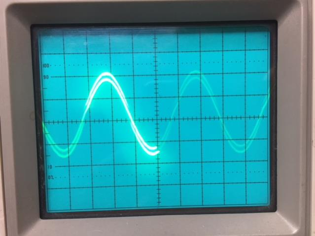

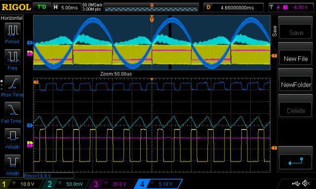

Mark,
the the doubled sinewave trace you see on the output is related to the
SPWM. The voltage of the DC bus is switched into the primary winding 24KHz.
I have a nice illustration of this
Pink is 50Hz output into the primary winding,
Yellow is 24 KHz PWM switched DC bus voltage into the primary winding,
Light Blue is primary winding current and
Dark Blue is primary winding voltage.
here it is zoomed in in the lower window
You can see clearly the inductor current increase linearly when the
DC bus is switched in, and the current drop linearly when it is connected to ground.
This happens at a rate of 24 Khz - the PWM freq.
This results in two primary winding voltages, rapidly changing between one and another level.
The DSO (digital storage Oscilloscope) of mine can capture events in time and freeze them for examination.
The CRO you have can not do this and so it shows two traces superimposed on one
as it were.
I fed the primary voltage signal into my Tektronix 2235 CRO and I see a trace like yours.
The double sinewave trace you have is probed at the secondary I believe and this indicates to me you need more inductance in the primary choke and/or more capacitor on the secondary.
In all of my inverters I have built I never see the double voltage trace on the secondary.
When probing these things I use a differential probe, which permits both + and - probe terminals to be any voltage, not reference to earth.
In the case of your testing, I think you need to be careful to allow for the fact that the probes ground clips are connected to the 240V AC supply earth. And these are then connected to 240AC neutral within the meter box.
(I can loan you my DSO and differential probe if you like)

Thanks for that info poida, I will file it for my future experimenting. It looks like my two primary chokes (one in each primary leg) do something beneficial.
I have never heard about differential probes, are they an expensive must have?
On my CRO there is a switch on the back that disconnects the mains earth. Its always set to disconnected when messing with mains equipment and saves me an embarassing short via the earth clip if my brain is not in the right gear .
I do like the idea of differential probes though.

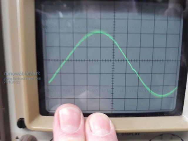

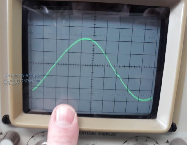

Well bugger me!
I put some more inductance on the primary, that dropped the no load to 0.9A
Idle hum was slightly less.
Added the big cap from the Aero sharp directly across secondary and it dropped the idle to 0.75A Idle hum still there.
Wave has some ripples in it at idle.
wave really cleaned up with 1200w blowheater running.
Turned it up to 2400w and it looked like it was trying to do that funny wave but there wasn't two separate traces, the one just looked a bit blurry at the peaks.
Don't have time for photo's right now but I'll post them up later.
Thanks Poida, need to find a bigger/better inductor now.
Cheers Caveman Mark

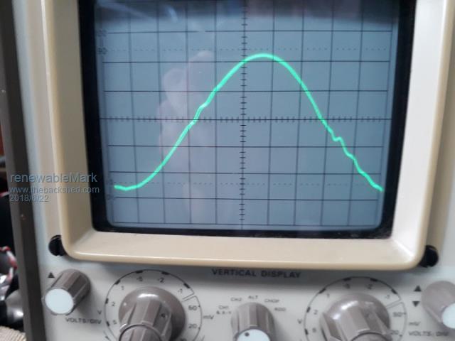

renewableMark
Joined: 09/12/2017
Posts: 1679
Posted: 06:37am 22 Jun 2018
Idle below
1200w below
2400w below
It's still too noisy at idle for my liking, when at 1200w it's almost silent.
Cheers Caveman Mark

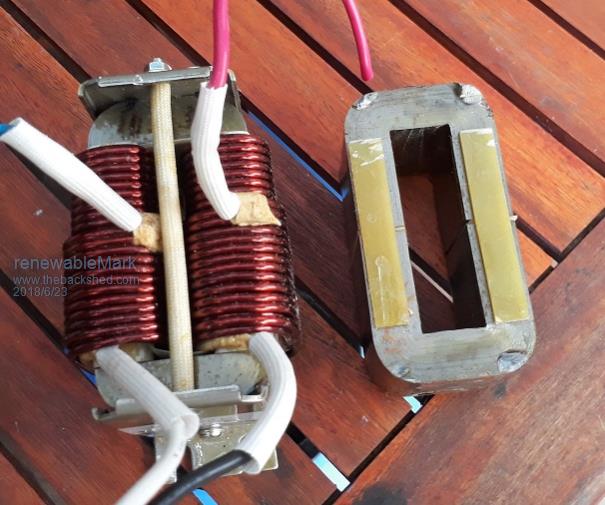

Posted: 11:02pm 22 Jun 2018

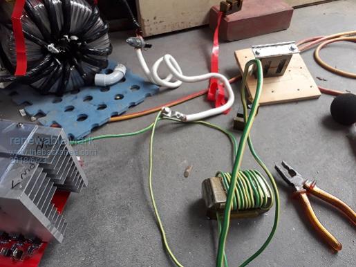

Klaus used two of these cores glued side by side and wound layers of thin copper on them and soldered the ends together.
Could you instead wind on welding wire like we do with the E cores and get a decent result?
Can adding more caps on the secondary be of benefit? Or can you have too much capacitance there, it would be a shame to blow the thing up now.
Mad warned me about putting on too much inductance but I'd really like to try and reduce this idle hum. It does sound pretty loud and couldn't be good for it.
When it had a tad more added yesterday the hum did reduce slightly.
Cheers Caveman Mark
Madness
Joined: 08/10/2011
Posts: 2498
Posted: 11:14pm 22 Jun 2018
The easiest way for you to try different amounts of inductance is to use the e cores you have. Use a smaller diameter wire which will be fine for testing with less load and try increasing and decreasing the number of turns.

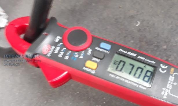

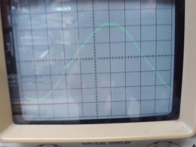

Posted: 01:08am 23 Jun 2018
Thanks Mad, the E core can only fit 6 turns so I gravitated to the Aerosharp core as it's a lot bigger.
Using just 1 core I did 10 turns and it was very quiet, sine removed the pronounced ripple but it still had some distortions, idle was 0.85A
12 turns on the same single core gave perhaps even less noise, almost silent.
very similar sine wave but 0.7A.
6 turns was back to the horrible noise the E core was doing, so the two appear to have similar characteristics at idle.
So assuming 12 turns on one core gave a good result, then with two aerosharp cores side by side wound 6 turns would give a similar result to one with 12 turns.
Or perhaps stack the cores the way we do the torroids?
12 turn wave below @idle, no nasty blips.
Edited by renewableMark 2018-06-24
Cheers Caveman Mark

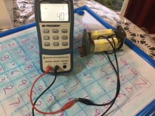

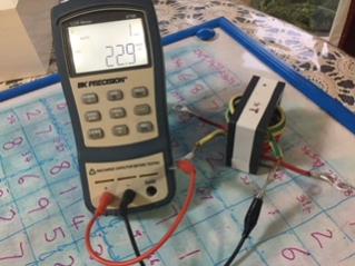

f' instance, here is a nice TDK ferrite E core with a small air gap.
3 1/2 turns, depending how you want to count it.
the LCR meter shows 22.9 uH
Compare it with the Areosharp choke core with 3 turns
4.0 uH
I put 6 turns in it (double the E core) and I got
10.8uH
12 turns give me 40.7uH
Notice how the inductance increased by x4 when I increased turns from 6 to 12?
This is to be expected. It's how things work in inductor-land.
Inductance is proportional to the turns squared.
I have a 6 1/2 turn winding on the E core, inductance of that is 67.4uH
67.4 uh x (3.5/6.5)^2 = 19.5, the estimated inductance for 3.5 turns when given it for 6.5 turns.
I measured 22.9 so whatever. Near enough.

OK thanks Poida, well at least I tried, I thought since the good result of the wave and lower draw with almost no noise I was onto something there, but if it let's nasty frequencies through that won't be good long term by your findings.
This is the one I used with 6 passes/strands through the core, but the torroid hummed too bad.
I'll get another, would it be better to have two in series, stack them or makes no difference?
The E core isn't that dear, I wonder why the manufacturers use the Iron type, simply cheaper?
Why would it be that they don't make grid tied inverters fail, something to do with the grid absorbing nasties?
Anyway, just ordered another RS one and will post results when I can.
