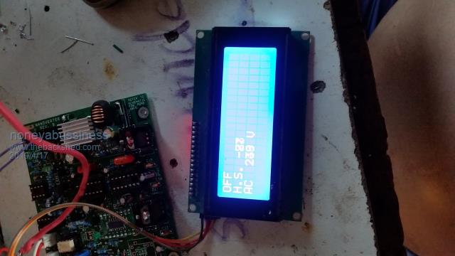

noneyabussiness
Joined: 31/07/2017
Posts: 527
Posted: 07:28am 17 Apr 2019
IT LIVES !!! well sort of... poida, as a semi learner on coding... where have i gone wrong with lcd... there is a lot more information to show, it seems to be outside of lcd screen, i have set some of the calibration info...
Ive tried to have a play around with positioning of characters but im unfamiliar with the particular library you have used...
Thank you in advance

Posted: 12:16am 19 Apr 2019
You probably have done everything right.
The problem might be due to differing LCD controllers.
I have coded things using the Arduino LCD library, making calls to
lcd.write(), lcd.setCursor(), init, begin etc.
This means it should work in most cases.
I'll bet there are detail differences in the LCD controllers and the I2C devices
we need for this to work.
I have some custom functions programmed into nano2.
One function lets you see in the serial console what is supposed to appear
on the LCD. At the menu, type ^33 and press return
The LCD text should be printed underneath the menu.
I find that when setting DC current calibration, you don't immediately see the resulting change. I needed to restart the nano2.
Sorry if it's a bit of a fiddle.

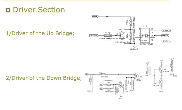

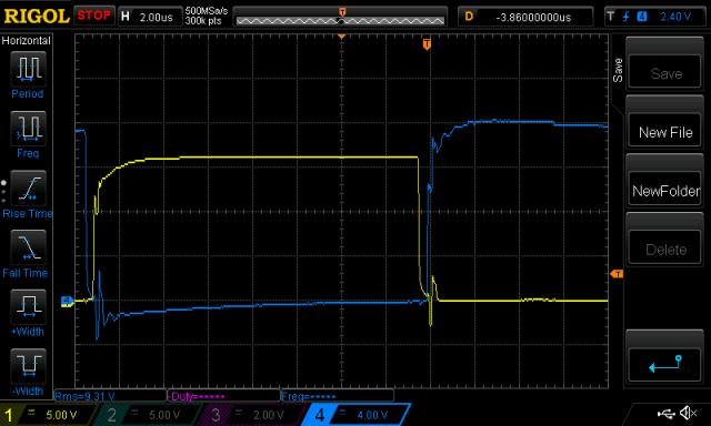

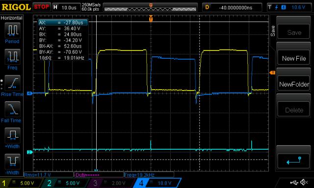

Part 31: Gate voltages observed on a Powerjack LF inverter
I have a PJ "6000W" inverter gathering dust here.
Since we know it has quite interesting gate drive circuits for low and high side,
I wanted to have a look at what is going on.
here is the low and high side schematic:
The high side is opto isolated, using a TLP250
The low side is totem pole, using 2SA1213 & 2SC2873 transistors.
Testing was done with 52V DC supply, into the same choke/toroid/cap combination
Idle current is 0.38A. This ran very quiet too.
OK then, let's see the DSO captures.

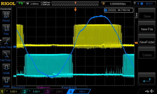

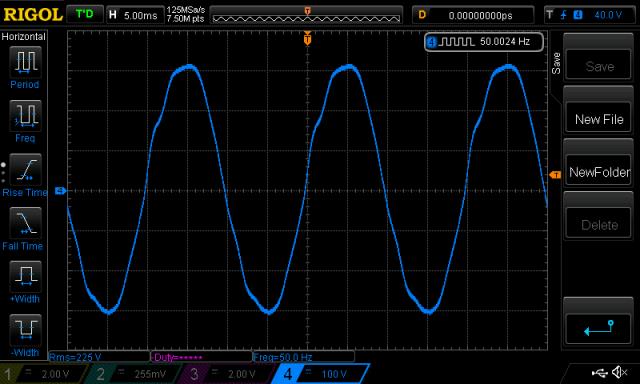

Here is the PJ control and powerboard AC output:
But anyway, Gate to Source voltages...
This shows the two low side drives. The PJ system drives a full PWM sine wave into both outputs. Not like the EG8010 which does a 50Hz square on one output and a sine PWM on the other. The nanoverter does it different, alternating sine and ground combination, on one output then the other.
Yellow = one low side, light Blue = other low side.

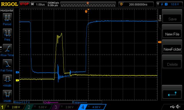

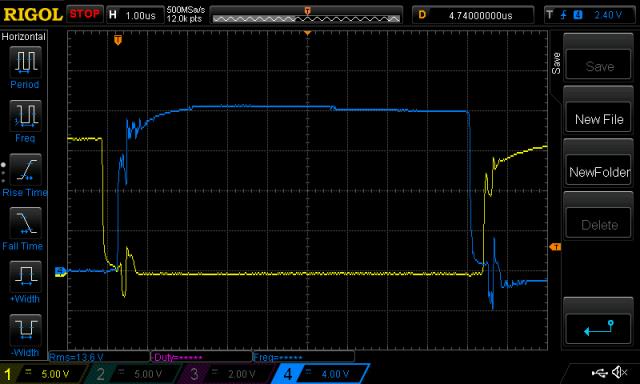

What about low and high side? This is the key area to my mind.
Yellow = lowside Vgs, Dark Blue is high side Vgs
Nice. highside Vgs Vertical scale is incorrrect.
Still a tiny bit of shoot through, but not too much.
Clearly there is some but not too much shoot through.
The dead time is 2uS, quite long compared with the usual settings we
have with the EG8010.

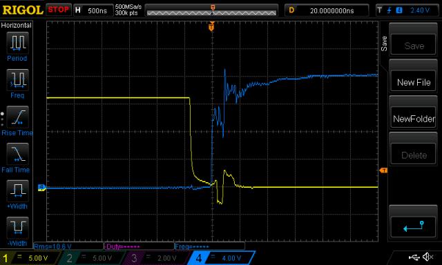

Here it is under load (170W)
Very clean gate voltages. No ST here. But there is some elsewhere..
A little clearer capture shows the short duration of the event.
All dv/dt caused.
This is curious. The high side has a short pulse, well into gate threshold territory.
But it's a short period of time when ST occurs.
All OK.

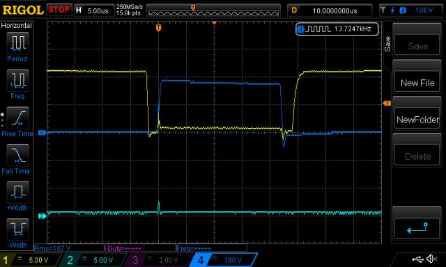

The PWM frequency was determined. May as well while I can.
It's 19kHz

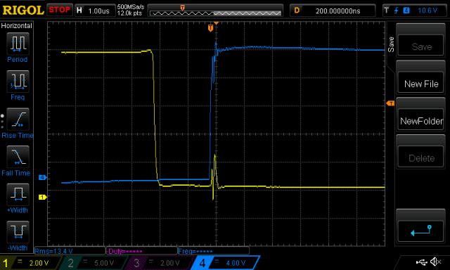

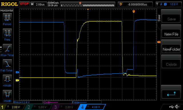

Using the same setup, but substituting the Mad control board with the PJ control board yielded lots to think about.
Same testing conditions as above.
Immediately we can see the 500nS dead time.

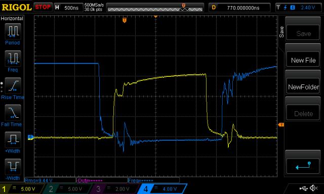

And significant periods of time in dv/dt caused shoot through.
closer in time..
This is ugly. The low side gate is pulled up, well into Vgs threshold
and stays there. The board uses IRF3710 MOSFETS and Vgs threshold is 2 - 4V.

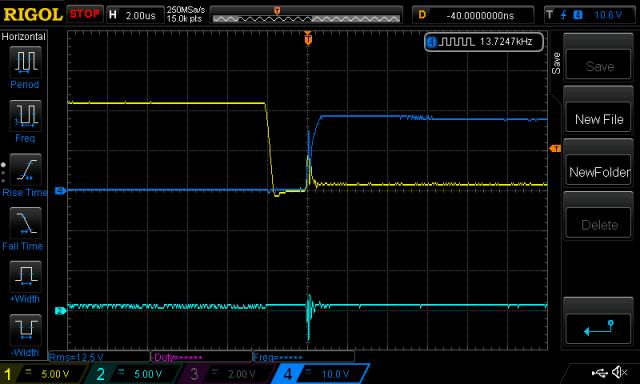

Did I tell you the test setup now is making a bit of noise?
Not good. Shoot through is happening on both LOW->HIGH and HIGH->LOW transitions of the 1/2 bridge.
The final one here was enough to cause my post recommending Ben and Amber don't run this board on a PJ power board.
And no prizes for guessing the idle current was high.
1.51A at 52V
I did not want to test this under load. No point and I don't want to break the nice PJ power board.
Thoughts and comments welcome as always.
Oh look, I see it's Beer O'clock.

poida
Joined: 02/02/2017
Posts: 1515
Posted: 08:03am 06 May 2019
  renewableMark said   Interesting, so how does the Mad control board perform on the Mad power board?
much better than the PJ power board.

poida
Joined: 02/02/2017
Posts: 1515
Posted: 10:02am 06 May 2019
  renewableMark said   The slow totems protect the fets?
More like the totem pole drives protect the gate drive IC outputs.
Not as a primary function, but as a very useful side effect.
noneyabussiness
Joined: 31/07/2017
Posts: 527
Posted: 10:58pm 06 May 2019
I know the original PJ board had 47ohm gate resistors, maybe that is slowing down the transition enough to clean up waveform. However greater dead time is needed to compensate.
More, combination is the key than anything
