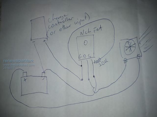

Sorry Mark probably my fault the resistor goes from Gate to Source the 2 outside legs.

Nah Mad, that was my fault.
Third time's a charm.
I wish we were able to edit posts, those previous drawings are wrong and confusing, and I just worked out you can't report your own post to get them deleted.

Just to confuse you a little more, you don't have to but probably a good idea to include a 47 Ohm (or close to it) resistor between the + output of the CC and the MOSFET gate.

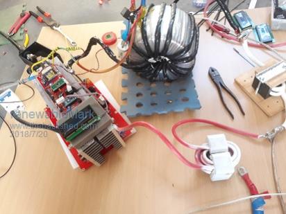

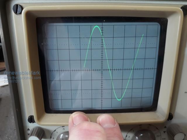

Had a fiddle with the choke I did with Warp the other day.
I put it in series with the 2x stacked ferrite.
Got 0.6A No load draw, pretty happy with that.
Nice clean wave.
NO hum from torroid at idle or any load.
BTW when I just used one ferrite it hummed really bad, two ferrites and still hummed but not too bad, the difference with both ferrite and big iron core is amazing, you can't hear the torroid at all.... nothing.
I could have tried it without the ferrite or less winds but hey, if it aint broke don't fix it.
Time to cram it in a box and hook up to the transfer switch plug on house.
The one that is painted white is the aerosharp one, it's made from two of the bigger ones stacked side by side and glued/clamped together. They tend to give nasty friggin metal splinters the little rotters so I painted the little dog so it wouldn't do that.
Why both? I remember Poida was saying the ferrite cleans up high frequency mess so I added it to the iron core that won't saturate.
Warps calculations and testing showed that the double stacked ferrite (4x halves clamped together)saturated at 40A.
The Iron core was well above 100A, not sure how mugh higher as he couldn't test any higher, but it had no signs of signal altering, could be 150?? so I'm well above any load I'll ever place on the machine.

Posted: 07:22am 20 Jul 2018
Looking good there Mark.
It should run much more happily now that it has a decent non saturating iron choke, and the transformer has been tuned to 75Hz.
Well done!
Posted: 07:31am 20 Jul 2018
Nice job there Mark. I confirm your findings with the choke core splinters, ouch .
My non saturating iron core choke, like yours, saturated at 130 Amps with 18 turns and a 2mm gap.You could perhaps guesstimate the figures for your choke from that.
Also confirm your findings about using two chokes. See my post later today, I'm using a different ferrite choke.
