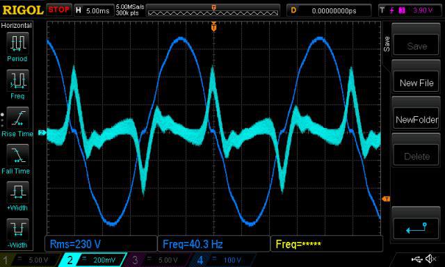

Mike, first the distorted output:
It could be due to Vfb signal quality.
PWM duty % is adjusted at about zero crossing of the 50Hz output, so it occurs
just before each of the 1/2 wave outputs. One output looks OK and one does not.
The adjustment is a single change to the amplitude of the pwm scale factor that is
applied to the 200 pwm cycles.
The code you are running (v7_no_bessel_mike) has no low pass filtering on Vfb.
It expects a clean signal and this signal to have a DC component mainly, with much smaller AC parts, eventually getting to near zero signal at 20-50Hz.
The nanoverter design includes an active low pass filter on Vfb.
I have not characterised it yet.
(hang on..)

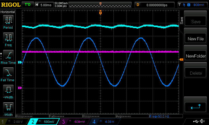

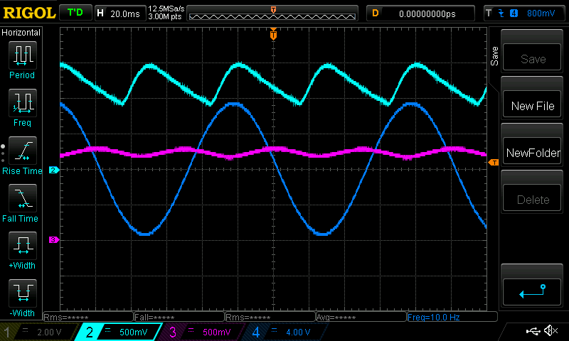

Here is 15V at 50Hz, the AC Vfb in, what results after full bridge recification and smoothing (i.e. input into the active filter), and finally the filter's output.
Dark Blue is Vfb in, Light Blue is after the diode bridge/filter input and Pink is filtered output which is what nano1 ADC channel sees.
when fed 10Hz, a lot more comes into the filter input and some passes out.
This is why the nano1 code works well without the digital LF filter.
It gets a clean signal.
What does your Vfb signal look like, after all conditioning, measured at the same
signal potential as the ADC input pin?
I found it a little tricky to get the above 2 DSO captures.
The function generator references signal ground to 240AC supply EARTH.
And the DSO references it's input grounds to 240AC supply EARTH.
This means for 1/2 of the input AC (+15 to -15V) fed into the diode bridge, it will get shunted to signal ground.
I avoided problems by using an isolation transformer for the 240V supply of the fun-gen. This way I could bring both Vfb input wires below ground while having CRO probe grounds connected to the nano's signal ground.

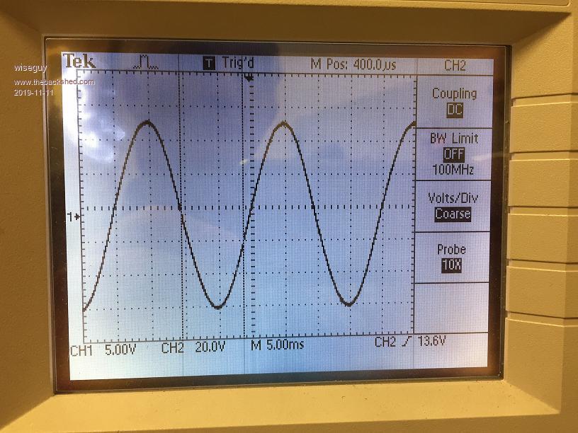

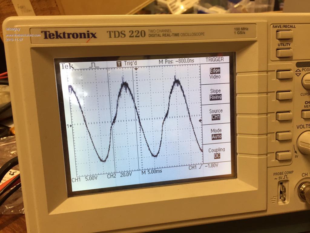

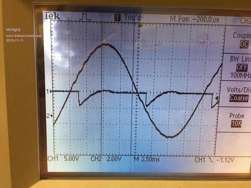

poida
Joined: 02/02/2017
Posts: 1507
Posted: 06:36am 10 Nov 2019
"Is the integral set too high ? would having a rolling average of the previous 4 or 8 reads (cycles) help?"
I'm not sure of the signal conditioning you apply to Vfb.
Let's look at a known setup where Vfb is sent into a diode bridge, smoothed via a 10uF or so cap and then straight into the ADC port.
This is much like what I used when developing the nanoverter code (prior to the great work of tinyt)
I used a digital LF filter and saw it could improve stability of the control loop to near perfection. If I used filter values such that too much time delay was present, then the control loop grew unstable. Too much delay is like a LF filter with Fc set to about 2Hz. From memory I think I settled on an Fc of 10Hz, Bessel 2 pole LF filter.
An average of the previous 4 or 8 samples might help. But probably not.
The average of samples is a low pass filter too, but a poor one.
Sample rates are important too.
The code you are using samples Vfb at about 4KHz.
This is happening continuously and then a flag is set to run the control loop code
which occurs once every 10ms. The latest value of Vfb converted from the ADC is used.
If you average the previous 8 samples, you will get a value that won't have as much noise of frequencies like 2KHz or 4Khz. This 8 value sample will still let through
gross changes in signal of 50Hz or there about.
My inverter code works with the assumption that when the control loop runs, the value of Vfb is a noise free and true value.
When using zero filtering, I sometimes got something like what you have got.
The control loop was doing it's best to produce output given a rapidly changing input
from Vfb.
I must repeat that over the course of a 50Hz output waveform, adjustment to the output amplitude is made twice only, just before the start of each 1/2 wave. This adjustment is used to scale (to make the output AC more or less) the subsequent 1/2 wave.
Looking at
I think the closed loop control is arriving at the point where it needs a large scale factor for the 1/2 wave that is positive. The 1/2 wave that is negative appears good enough for now.
I wonder if Vfb signal at the ADC input is not very smooth.
The shape of the positive 1/2 is very reminiscent of what I saw when I ran a test inverter with 40Hz output, sending the toroid well into saturation.
Dark Blue is AC voltage, Light Blue is primary winding current.
My guess is the positive 1/2 wave is using an amplitude control value of near maximum. And after then it becomes a more reasonable value for the negative 1/2 wave.
When developing the inverter code, I had my MOSFETs saved many times thanks to a current limited bench supply & small bulk caps. I could get away with murder time and time again. Clearly to me you need to keep using current limit devices until we get to the bottom of this.
Could you stick a probe on Vfb as it is sent to the ADC input, DC coupled?
We might learn a bit about what's going on.
Also, obtain the output of D7, the signal I use all the time to synchronise the DSO.
This short pulse is output just before one of the control loops is executed.
You can use horizontal delay to check out what is on Vfb right when the control loop is run for both 1/2 waves.
Edited 2019-11-10 17:05 by poida

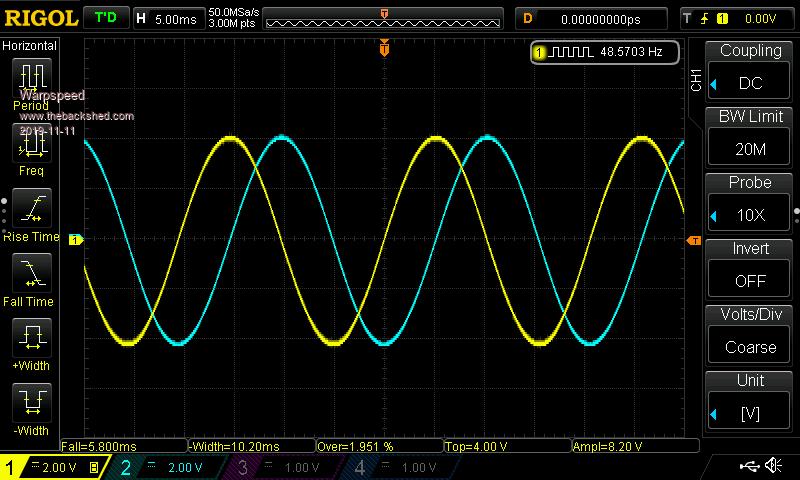

Posted: 07:10am 10 Nov 2019

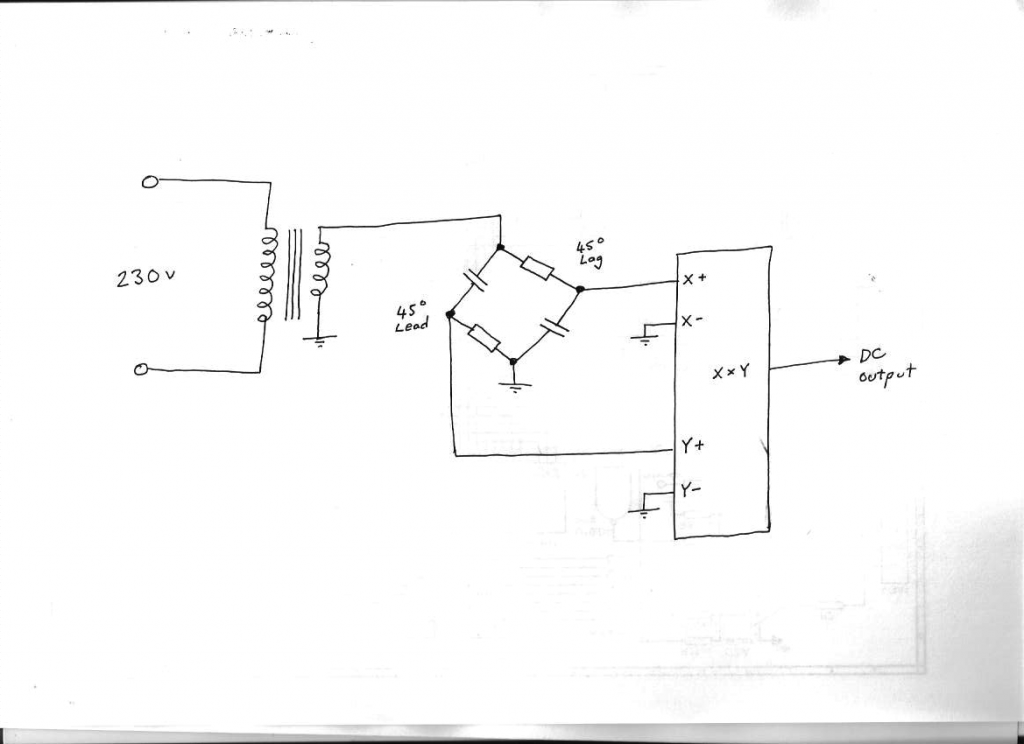

Poida, one rather sneaky technique I remember (not my idea) to generate dc proportional to amplitude of a sine wave, is to  multiply the sine wave with a cosine wave of identical amplitude in an analog multiplier.
The cosine wave could be generated by an all pass filter of some kind, to produce two outputs with 90 degree phase difference and identical amplitudes. That should be fairly easy as our 50Hz frequency is constant.
Any residual ripple produced by harmonic distortion should be of a much higher frequency and lower amplitude, and should be easy to get rid of.
No rectifier required to do this either.
As you will already know, Sin x Cos = 1
The big advantage of this method is speed of response to amplitude changes without the heavy low frequency pulsing that rectification produces, or any long time constants.
That is the sticks and glue analog way to do it.
It may be possible to do something a bit more clever in software, I really do not know.
How about a rotating stack with ninety degree length. Then multiply the current instantaneous measured sine wave value, by the ninety degree old historical stored value in the stack.
This will need to be proper four quadrant multiplication, and the output should be a steady constant positive value proportional to amplitude (plus any inherent noise).
Edited 2019-11-10 17:54 by Warpspeed
poida
Joined: 02/02/2017
Posts: 1507
Posted: 11:35am 10 Nov 2019
sin(x) + cos(x) <> 1 for all x, maybe only when x = 0 or pi,2pi etc.
sin(x) * sin(x) + cos(x) * cos(x) = 1, for all x on the other hand.
So I need 2 more multipliers if I want to go analog.
But I could use stored samples, and do the sum of squares thing.
I will experiment maybe.
Edited 2019-11-10 21:37 by poida
Posted: 07:42pm 10 Nov 2019
Its well worth a try.
I know that its already been successfully done in analog, and used in a commercial product, but have never seen an actual schematic.
I  have only read about the concept a very long time ago and the exact details are all rather foggy. But the possibility is there.
Posted: 08:53pm 10 Nov 2019
Yes you are quite right.
sin(x) * sin(x) will produce a sine wave of double the frequency with a dc component.
If you do that again with the same waveform delayed by ninety degrees (cosine) that too will generate a double frequency waveform with a dc component.
The ac components of each will be in exact antiphase, and will cancel when the two waveforms are finally added together leaving just the dc.
The sum of squares using a delayed value and a current instantaneous value should achieve the exact same result in software.
Posted: 10:40pm 10 Nov 2019

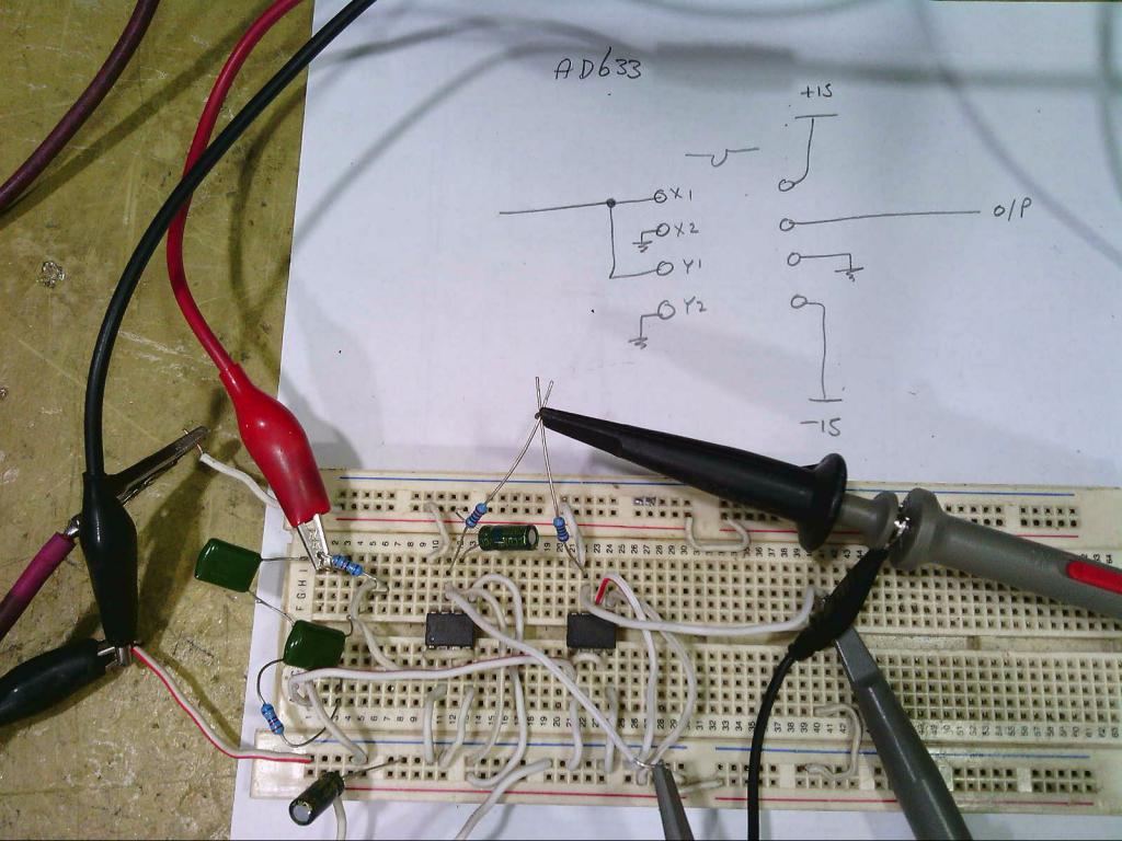

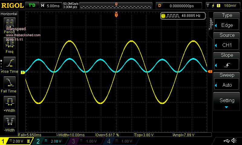

I am so very intrigued by this idea, I simply had to have a go.
So I connected up an all pass filter consisting of two 47nF and two 68K resistors in a bridge (Xc = R  at 50Hz).  That produced two 50Hz sine waves with ninety degree phase difference and equal amplitudes. My capacitors were both closer to 48nF than 47nF so I lowered my frequency a bit to compensate.
I then breadboarded up an AD633 analog multiplier connected as a squarer, and did indeed get a twice frequency sine wave output that has a dc component.  It clearly sits above ground with a positive dc offset as expected.
Added a second squarer to the cosine waveform, and combined the two antiphase waveforms together with a couple of resistors.  The purple trace shows a slightly wobbly dc voltage. The purple trace is one volt per division not two, so its about +1v volt dc.  I could have varied the scale factors of the multipliers to get more than that, but did not bother. This is just a rough test.
So it does in fact work, and should work much better with real numbers in software rather than having problems with 50Hz hum, dc offsets, and component tolerances.
This should convert ac into dc as a steady continuous process, without the violent pulsing produced by rectification.
And it can be done without adding any significant delays or long time constants to filter out the resulting ripple of rectification.
Edited 2019-11-11 10:59 by Warpspeed

  Warpspeed said  I am so very intrigued by this idea, I simply had to have a go.
This should convert ac into proportional dc as a steady continuous process, without the violent pulsing created by rectification.
That is important for stability and response when optimally tuning a PID feedback system.

Just had a look on e-bay, five for twenty dollars is not too bad.
https://www.ebay.com.au/itm/5pcs-AD633JN-AD633-Low-Cost-Analog-Multiplier-DIP-8/251919464577?hash=item3aa791f881:g:cO0AAOSwBLlVLTuO
I don't imaging anyone would ever build an analog version of this into an inverter, it could be done far better and much more easily in software using the same basic principle. Feed the ac voltage direct into the a/d converter through a transformer, and just crunch the numbers.
A sudden step amplitude change (in either direction) should be fully recovered in ninety degrees or 5mS.  It requires that for the "historic" delayed cosine data saved in ram to correct to the new changed amplitude setting.
That should really tighten up the achievable stable response of the PID control loop.

My concerns are related to the fact that the AC voltage output from an inverter
when powering real world loads is not a pure 50Hz sine.
There are other frequencies there.
How does the sin^2 + cos^2 approach work with not insignificant harmonic components?
The active low pass filter of the nanoverter crushes all (to insignificant levels
above 50Hz.
Maybe put a few harmonics in there with the 50Hz. 20% of the 3rd, 15% of the 5th.
See how it goes?
I know the digital approach will fail when there are harmonics present.
My mantra is:
Low pass filter then process.
That is, remove all more than 50Hz but the 50Hz and then process.

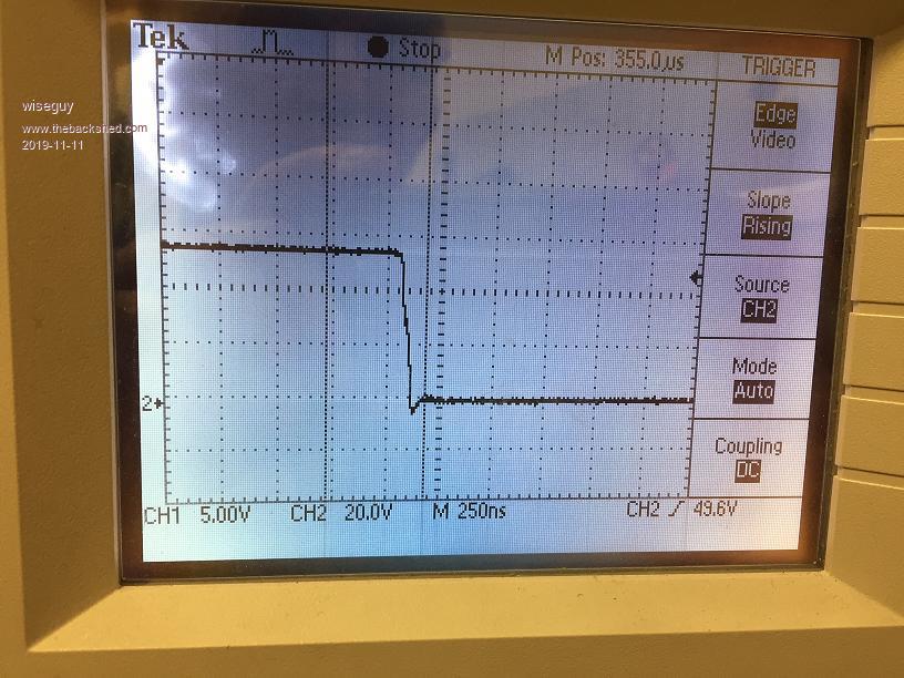

Tony - I like the multiplier rectifier - a unique approach - but Im fresh out of multipliers in my goodies box right now, need to order a few more.
Poida,Thanks for your replies and comments, I had forgotten that you had created some code for me to try just before I had to put the project aside for a while - and it remained untried until today when i found it again. The code was 2019-05-28_100414_v5-wg.zip.
The inverter behaved much better with some relatively small distortion on the 50Hz waveform.  Now that I could run the inverter safely I was able to scope Vfb, and what a fine mess it was !
Here is where I lose some (all?) credibility, but it has to be called as it is.....do I really have to post the waveform...........ok here it is warts and all.
This is not how it behaved during bench testing, not sure if I have phasing wrong or what. The sample and hold is supposed to hold the peak value until about 3+mS after the zero crossing whilst you read it (2ms after zero cross?), before enabling it again for another few milliseconds until after the next peak. Instead what we see is about 1.5mS after the zero cross the sample and hold becomes live again.
I will look into this probably Wed - busy until then. Another few pics, the next one is one of the bridge drive output just before the choke, rise-time is quite snappy.
Now the fall waveform.
And finally the waveform driving 1KW.
I think as soon as I sort out Vfb it will be a goer.
Poida I am a little confused at the Vfb. I thought I read that it is updated at I think it was a 4.5khz rate, then somewhere else I thought it just sampled once or twice depending on the code for each complete sinewave. Then I read that we want to remove everything except the 50Hz component & process, somewhere I dont think I understand the correction process after Vfb is sampled.
I found the original part and quote "An important point on the digital filtering:
Since we are sampling Vfb at approx 4500Hz" - why do we sample so fast?
I was expecting to read a DC voltage proportional to the output peak or rms and it would be re read and updated once each cycle and applied to a complete waveform.
I hope you can help clear up my confusion for me.
Cheers Mike
The harmonics will be "stationary" and should add some up and down humps and bumps  to the dc, but should not effect the overall average dc value. That should have little or no effect on the integral part of a PID, but the proportional part might introduce some unwanted harmonic distortion. Don't really know for sure, but it might still be worth trying.
above 50Hz.
That would be the way to do it, have a fairly steep low pass filter to clean up the measured inverter waveform. It cannot be any worse than the raw 100Hz ripple output of a rectifier !!
My mantra is:
Yes absolutely, agree 100%
the function "loop()" is executed as fast it can be. It works out to be about 4kHz.
There are two versions of nano1 code. One low pass filters Vfb, and one does not.
But both sample Vfb at 4KHz and store the most recent value.
Now, when it comes time that the AC output crosses zero, a flag is set to enable
the closed loop control PD code to execute. This will use the last ADC conversion of Vfb. Depending on which versions, Vfb will be low pass filtered or not.
The current or latest nano1 code has no LP filtering and so it requires a LP filtered input (which is obtained from the active LP filter design on the nanoverter board)
Some may think it's wasting time to needlessly convert Vfb each time  loop() is
executed. This not a problem, nano1 code has plenty of time to do this.
Now that the current code has no digital LP filter, the continuous Vfb conversions are not needed. But when I was digitally LP filtering Vfb, I had to have a good long history of Vfb samples ran through the IIR low pass filter to ensure that when the time came to execute the closed loop PD control code, a good and filtered Vfb value was available.
     Page 4 of 6
