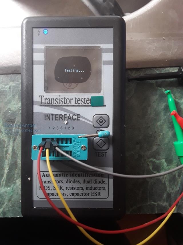

Another thing I'll be needing when mosfets come in I bought this off eBay for under twenty bucks it's very light feels very cheap made but it seems to work well
I was pretty impressed that tells you the pinout tells you the voltage capacitance and tells you what kind of component it is
I'm not understanding how the mosfets work
I'm getting confused with the source and drain
It don't take much by the way
I'm going to look for a class or two on mosfets to take
Then I'm going to get started right back on this little board
I want to make sure that I get it up and running right and have a good understanding before I go to the big boardEdited by BenandAmber 2019-03-29

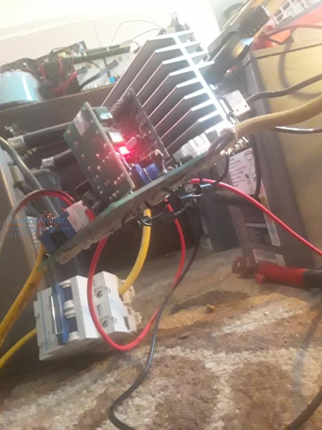

Success
We changed out irf p 2907z to hy4008
We put 14 gauge wire overall input and output traces soldered it all in where no bare wires showing
We are using the 15v tvs zener diodes that the one and only alsome Poida instructed us to do along with all the other modifications he suggested
poida wasn't the only one that we got good advice from and we appreciate all of you guys and gals that gave us good advice along the way without all you guys this wouldn't have been possible for us
We really like this forum and the good people on it and hope 2 have more successes in the future and maybe one day get good enough to give a little advice ourselves
Peace love and good health to all

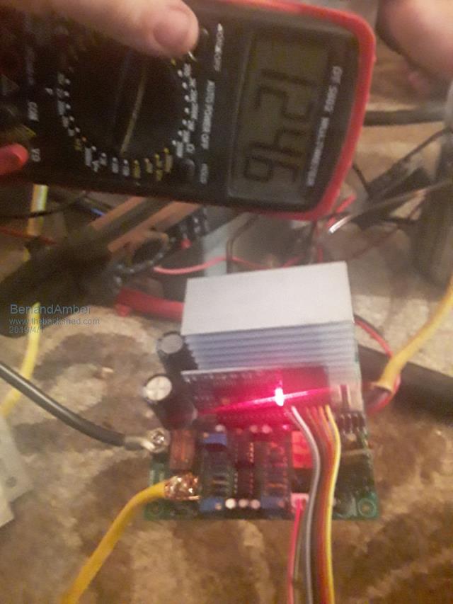

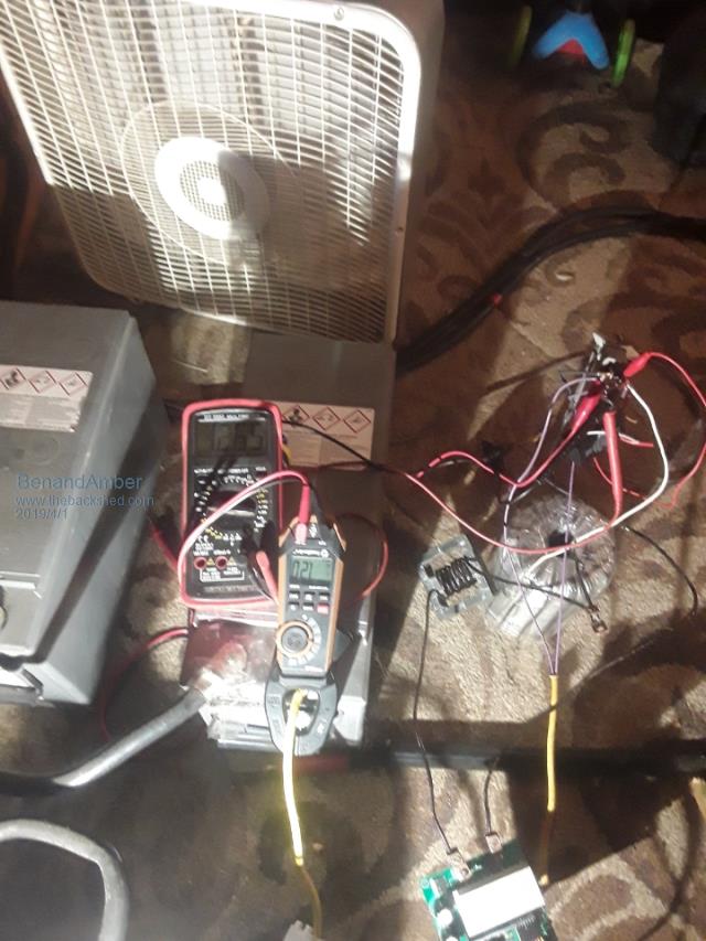

Running a light
Running a box fan
This is the little tiny not worth buying screen that comes with EGS 002 card
none of the information on it is the same as my multimeters the temperature and Hertz is right
my voltage is a little high I need to set it down a little bit more 126 volts at end of testing
the idle current is below half a amp o.39
the temporary inductor filter makes a
funny noise
I didn't run it very hard tonight
I did let it run for a couple hours
During testing the mosfet stayed room temperature without a fan on themEdited by BenandAmber 2019-04-02

BenandAmber
Joined: 16/02/2019
Posts: 961
Posted: 12:56pm 02 Apr 2019
Amber built the Transformer ladyN and we did everything except for the low side
Winding over a year before we got on this form
and guess what we are going to do a warp speed inverter as soon as we get a chance happy happy joy joy
Warpspeed is pretty awesome guy I think you already know this though kind humble generosity would be just a few of the words to describe the man
We have been testing this little board and it seems Rock Solid so far
We are trying to figure out why it kicks off and starts blinking the little light twice after we run Amber's hair dryer and my heat gun at the same time
Amber's hair dryers pretty big one
The reason I'm confused is because it has no 393 chip on the little board and we did the modifications that poida the great recommended
We didn't know it had any onboard current protection after modifications unless it's shutting off because of battery current
We only have four batteries currently hooked up there are 144 amp hour batteries
We have bigger capacitors to put it on on it also after testing is completeEdited by BenandAmber 2019-04-03

BenandAmber
Joined: 16/02/2019
Posts: 961
Posted: 09:44pm 02 Apr 2019
Okay I guess it was just a simple as turning a potentiometerbr
Boy poidas design is better than what I thought
I thought with the upgrades that part of the circuit wouldn't work anymore it does
I got it set up to about 16 amps AT 120 volt
I'm very happy with this IT is literally 4in by 4in inverter board
a fan would probably have to be ran if you was going to pull that much amperage MOrE than a couple of minutes
