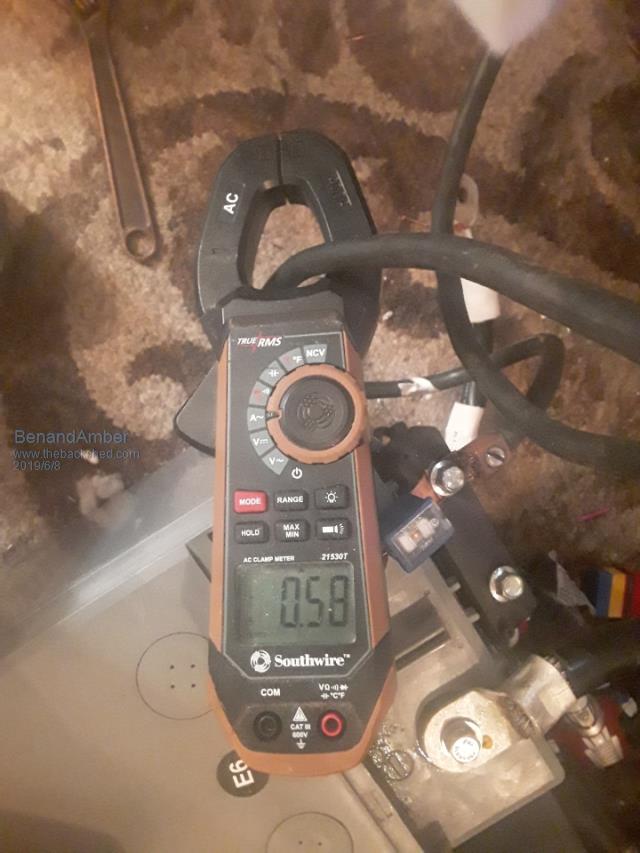

Still waiting on the 48 volt fans
The one fan that is in there as a 12-volt and I didn't hook it up for this test
It will be replaced with a 48 volt
Looks like I'm going to have to change out a couple resistors
The pot is turned all the way
I pretty much already knew this though
Everything seemed to run pretty cool
The highest temperature on the board was the front right totem pole drivers and they were like 80 degrees Fahrenheit
Would love to see the sine wave out of this machine
that big choke was originally made for a inverter
it had a lot more turns on it though I rewound it
I'm hoping the idle current will go down a little bit when I replace a resistor and turn the voltage down to around 120

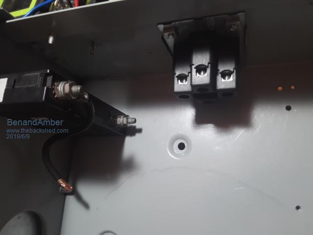

I really do not like that DC breaker it came from AliExpress
I just do not trust it
I cannot get the cables tight enough no matter how hard I strain
breaking the thing apart and still not tight enough for me
I have a hundred amp fuse in line with this also just in case
Not sure it has big enough capacitors on it either

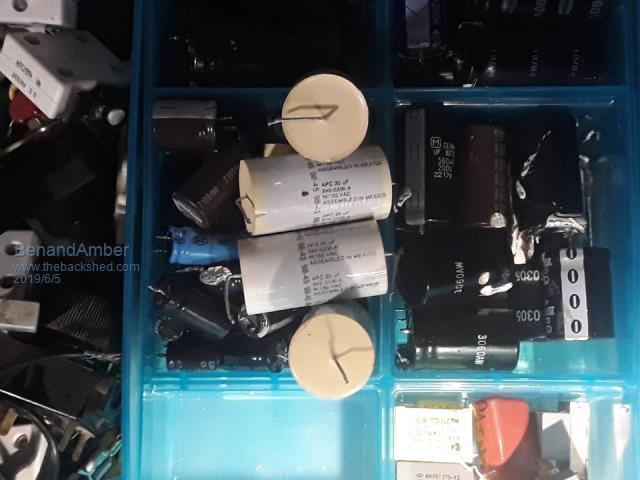

I would also like to know your guys's opinion on those film capacitors at the top of the page
I have four of them and they're out of two different APC UPS

For your comparisson, (my)the 6kw OZinverter has 8pcs 100v 10000uF capacitors.
It's not always the bigger the better, you need to have caps that are rated for high ripple current.
For those foil capacitors, looking good but you know that most of us use between 2 and 5uF, 20uF would probably be to high. I only use 2uF in mine, it depends a little bit what's best with your transformer. I got higher idle currents and misforming Sine WAVE with more then 5uf. Edited by nickskethisniks 2019-06-09

for the tuning capacitors on the secondary output I have used very different values for two different torroids that looked and were wired identically.
The first one needed 6uf to obtain the 75hz tuning, the second one needed a whopping 12uf to obtain the same tuning frequency.
Commonly if not tested, 4uf seems to be a standard number.

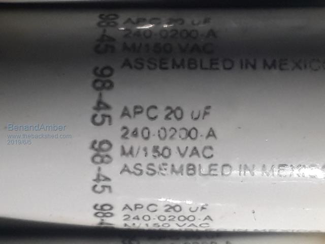

Thanks for the info Nick and the one and only mark
The APC capacitor say 20 if but they measure around 18
I was hoping not to have to buy any more capacitors
I have a 5 UF on it right now but I'm running out of the smaller UF capacitorsEdited by BenandAmber 2019-06-10

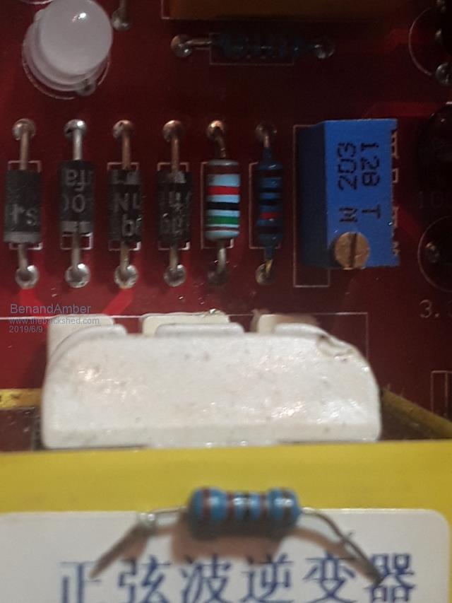

This picture shows the 21 k resistor I took out
it is on top of the Transformer
It also shows in the circuit the 15K resistor I replaced it with
This gave me a lot of leadway both up and down on the voltage feedback
I put this up in case anyone else decides to get this board
and needs to change it to 110 volts instead of the 220 volts

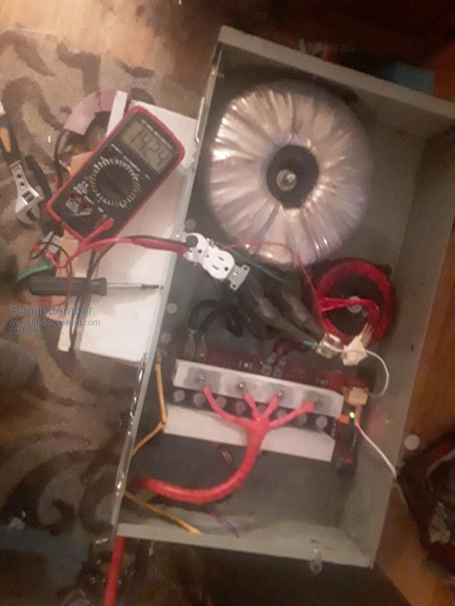

Now that's a little bit more like it
And completely silent
if you stick your ear literally against the big Transformer
you can barely hear a little hum
The choke makes no noise at all
Took it all apart today and gave it a last good cleaning and installed the 48 volt fans
Still haven't wired them up yet
I also put a breaker in it and a Giant RV plug
I will run a female end of a RV plug
From my RV breaker box and plug it into the side of this inverter
If I ever need to plug into a RV hookup I will unplug it and plug it into my 50 ft long RV plug
I will be putting a female plug-in on one side of it
With doing it this way there will never be an accidental plug-in while the inverters running

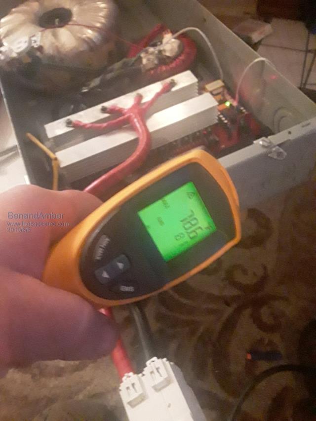

A mosfet on the right side front being the side with feedback Transformer is 2 to 5 degrees hotter than all the rest
I didn't run it hard tonight just mainly small loads
During this time all mosfets stayed at 79 degrees except for that one in the front and it ranged from 80 to 84 degrees
Is this something to worry about should I change it
I plan on running that hard tomorrow or the next day
don't want to run it hard till I hear back from you guys

It looks great to me. I would try larger loads in increments.
eg a 500W, all OK? then a 1000W all OK? 1500W? etc
I would not just go nuts and "see if it breaks when I do this to it.."
like on the Little China Board.
I find I can hear it when things are not happy.
Did you protect the IR2110 outputs with TVS diodes? Maybe in the case
of this board with the totem pole drive, it's completely unnecessary.
I would not fit them if it was me. But that decision would be made after I examine
the gate drive outputs with a CRO to prove they never go into potentially damaging
voltages (less than -0.3V or more than 12.3V)

That choke was originally made for a large inverter
I unwrapped two of them and use the wire from both of them on the one that's in this inverter
It makes absolutely no sound at all
the big Transformer barely hums if you put your ear down to it

Been testing a little bit more today
hooked a 15000 BTU window air conditioner
and a 1500 watt heater and other things I could find a plug into it
All at the same time
Everything seems to run great
I don't have anything bigger than hook into it
I guess I'll just keep on adding stuff to it
the big Transformer does make it louder humming sound with the air conditioner running
it's still very quiet
No noise at all out of the choke completely silent
No fans hooked up mosfets up to about 90 degrees and settled in there
The 20 amp receptacle got a little bit hot the touchEdited by BenandAmber 2019-06-12
