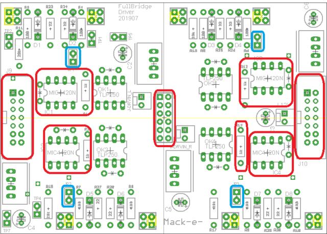

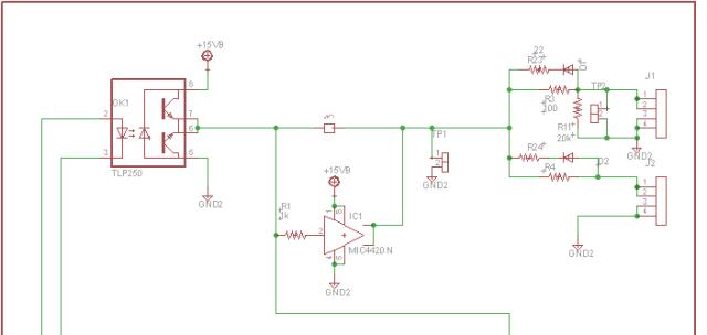

12v is fine if you use TLP250 or that other Opto driver someone found. The MIC4420 will work at 12V also.
RS does have the MIC4420 and the IR4420. There are other PIN equivalents like the heavier TC4452 (its not required).
MIC4420 AliExpress Just the first one I found - I haven't bought from here.
I am using 15V parts in those little DCDC converter - mainly because I have a mixture of optos.
Not all your driver Boards will need the MIC4420.
If on a given Full Bridge driver board you have no intention of expanding to Half Bridge Boards then you only need the Opto Driver and place the Jumper on, and leave the MIC4420 out altogether. The Half Bridge boards obviously need the '4420s.
J11, the 12 pin IDC in the middle of the board can be omitted unless you intend to use it - and the 2 pin testpins TPx can be omitted - I used them for quick access for my CRO probe (I've made a cro lead going to a 2pin socket)
The 100k SMD pulldowns on the Mosfet board aren't necessary as there are pulldowns on the driver board. However if you power up without the driver board the FETS will likely blow. They are a larger SMD (1206) and should be able to hand solder it. (none of my Mosfet boards have these pulldowns - just thought it was a good idea)

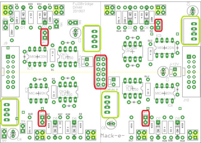

Full Bridge Driver Board - Assembly
- Omit these Parts
- Optional
- Include Part
The 2 pin headers labelled as TPn are test points and are also optional.
Standalone
Driver Connected to Half Bridge Boards
If the small B1215 PSUs are used on the half bridge boards it would be advised to also install them on the Full bridge Boards.

G'day Andrew,
where you say jumper, you mean to short those two pins, so I could just solder in a wire across them yeah?
Cheers Caveman Mark
Off grid eastern Melb
mackoffgrid
Joined: 13/03/2017
Posts: 460
Posted: 05:00am 29 Jul 2019
yes indeed.

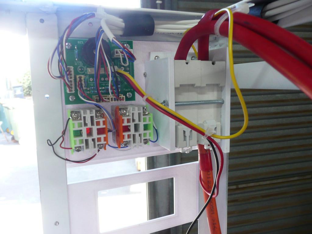

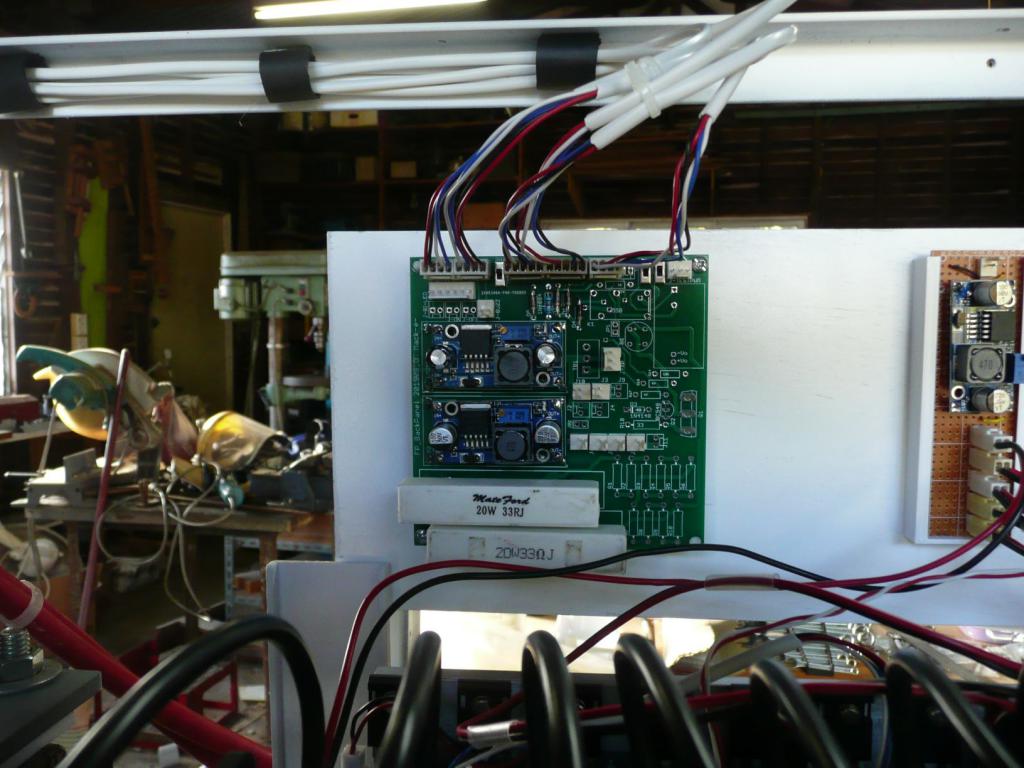

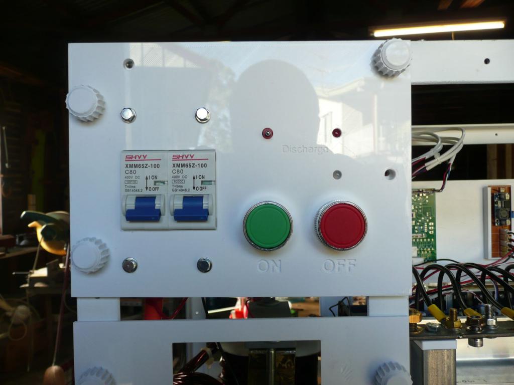

I am not by nature a tidy person.  All the wires leading to and from the Front panel were very untidy and apt to get tangled up etc.
My solution was to make a front panel PCB and a rear panel PCB.
The Front panel has the Charge - Discharge Toggle switch, Bi-LED for Charge / discharge, ON and Off push buttons with a Bi-Red-Green-LED for inverter State, and a Buzzer.  It was a real mess.
So now the 2-way toggle switch, the two Bi-Leds and the buzzer are PCB mount.  Power from either side of the circuit breaker are feed into the pcb along with the two push buttons switches.
I then run power and signals back to a rear panel PCB which has the Charge - discharge resistors, 12V power supplies for the WarpVerter electronics and 12V to feed the isolated power supplies.
This back panel PCB can take the LM2596 power supplies like I have done but can also take the ACDC power supplies.  I've got the circuitry there to test an active charging circuit for the 100+Volt inverter.  There's a jack to provide for Fan power.  I've also included some small switches and jacks for testing purposes.
I haven't tested all the modes yet but I'll put these PCBs on Github when I'm satisfied.
Very pleased with the tidy up,
Andrew

That looks fantastic.
The front cover looks amazing, I just noticed you have ON/OFF and discharge inlaid into the panel.
That's 3D printed yeah?
Didn't realise you could come up with a glossy finish like that.
Cheers Caveman Mark

  renewableMark said  That looks fantastic.
Thanks Mark.  Yes, 3D printed.  You get the gloss finish on the surface that is in contact with the heat bed, the first layer.
