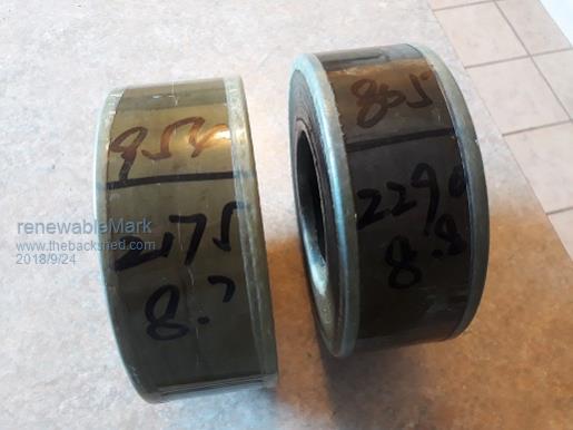

On another note, I finished unwinding the second 3kw core just a few min ago.
Never notice these markings on the previous cores.

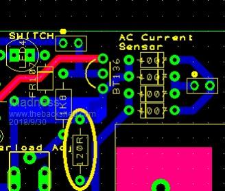

Mark I am still a few weeks of getting home and will try it then, also I will be trying 5V direct to Pin 6 and use the faulty temperature input to turn off the Inverter and see how that goes.
FYI Mark here is the Burden Resistor that you supposedly don't have.
Here some detaila about why it is there.
