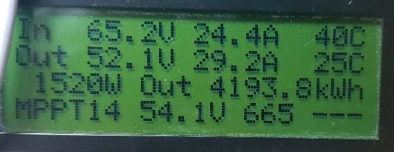

Hey Pete, finally got some time to play around with this again... problem I'm having is when I try to load the code on the arduino i get this error .. Im assuming its something to do with there latest compiler as I have had this working earlier.. at the moment, it will load but with the errors ive pasted, but no serial data is coming through...
thank you in advance... hope all is well ...

I think it works !!

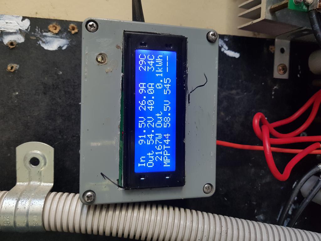

Hello All
My grid inverter MPPT's have a minimum of 150V, and the home-built one use <100v.
Now I have a 3 x 3.3kwatt solar array, basically 12 panels for each array.
So for my Grid (Mppt's) 2 strings of 6 panels (180V open circuit) and for my home built I have 4 strings of 3 panels (90v open circuit).
So basically what I would like to do is if my battery is not fully charged I can add another solar string to charge the battery and if I don't need the extra string (ie during Summer, feed back into the grid), Come winter I will want all string into the battery's.
What I was wondering is if can I use home-built (mppt) PCB with different components for my Grid (mppts) panels.
I understand I would need to change the Power Mosfets and Diodes to take the large voltage, as well as the Inductor size to make it work.
I have found these items to replace the components.
MBR40250TG
https://docs.rs-online.com/7950/0900766b814b2dca.pdf
IRFB260NPBF
https://4donline.ihs.com/images/VipMasterIC/IC/INFN/INFN-S-A0012490438/INFN-S-A0012837889-1.pdf?hkey=6D3A4C79FDBF58556ACFDE234799DDF0
Andy

bugger ... sorry it still wont access serial data... just comes up blank... Ill try some things today encase thee is a weird library messing it up... Thank you in advance for helping
I think it works !!
noneyabussiness
Joined: 31/07/2017
Posts: 527
Posted: 04:05am 02 Jan 2023
ok.. this is weird... loaded up the ino and it would still not access the serial data, respond to " ? " etc... so i left it and came back 5 mins later.. now it is working, its uploading fine so " shouldn't " be the cable but... really strange... it seems to be responding now, so thank you again Peter, ill let you know how i get on..
I think it works !!

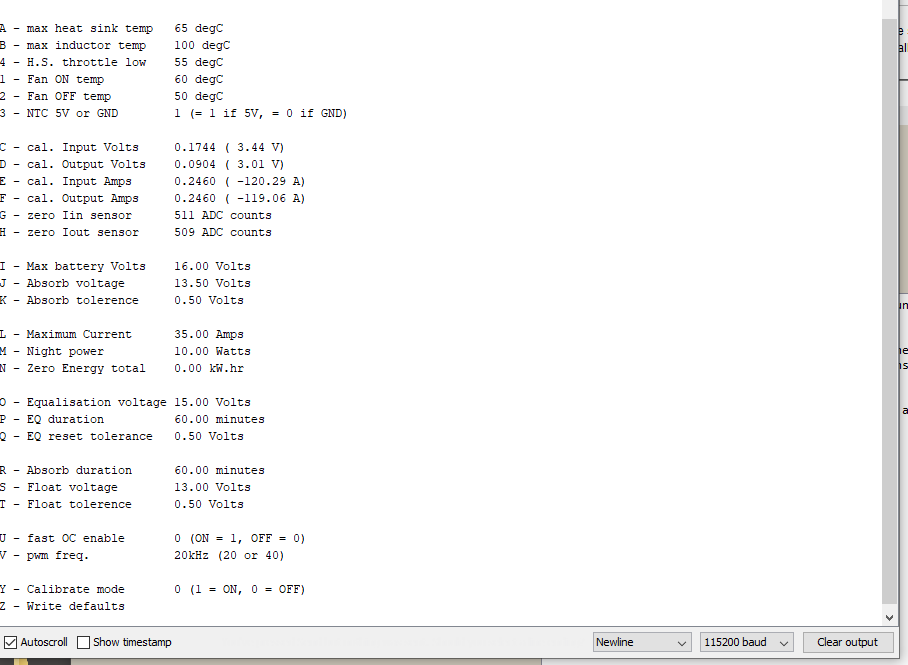

poida
Joined: 02/02/2017
Posts: 1507
Posted: 08:15am 03 Jan 2023
this version of mppt code uses 115200 baud to communicate via nano serial port
I use 9600 and 115200 interchangeably or on a whim
So to see what speed the mpptv5_highside_NTC code needs
I first try to connect using 9600. no response means
maybe it's 115200
As always, you need to send a newline to terminate all commands sent to the nano.
noneyabussiness
Joined: 31/07/2017
Posts: 527
Posted: 09:25am 06 Jan 2023

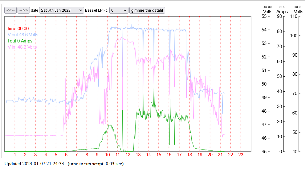

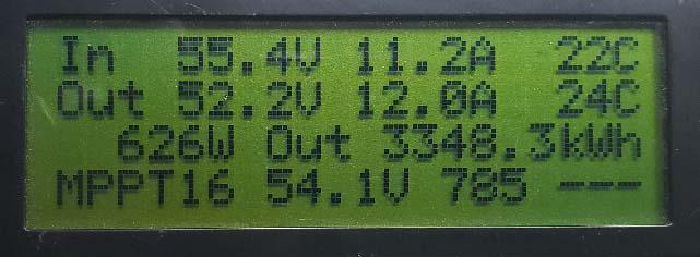

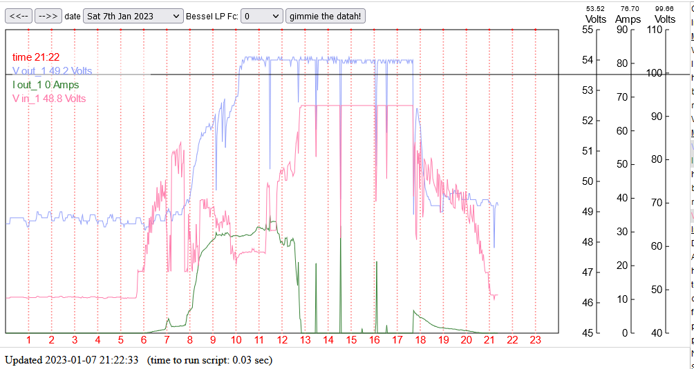

hey poida, got a couple of new lcds for this project, code working like expected,  still unsure why it wasn't at the start...

noneyabussiness
Joined: 31/07/2017
Posts: 527
Posted: 08:51am 07 Jan 2023
and we have liftoff !!
was at the end of the day, and choke was to small .. but its a start..
I think it works !!
poida
Joined: 02/02/2017
Posts: 1507
Posted: 10:44am 07 Jan 2023
let's see the conversion efficiency:
assuming the volts and amps are calibrated to something close enough
for jazz..
IN: 91.5V x 26.9 Amps = 2460 Watts
OUT: 54.2V x 40.0 Amps = 2168 Watts
conversion efficiency = 2168 / 2460 = 88%
which is pretty good given the voltage difference.
When going from 91.5V to 54.1 V that is nearly a 1/2 drop and there
are some losses in this design that get big when the Vin:Vout ratio is large.
This is looking good.
I find with my two arrays, I run them at lower voltage ratios
when under large power loads. More like 75V to 50V and so the efficiency
is a bit better, more like 92%.
I designed the arrays to have max power voltages of about 75-80V.
Open circuit voltages are of the order of 95V.
Since there is a lot of conversion loss, I would be watching the heatsink temperature
and also the choke's temp. That is where all the losses go.

here is today's data for the North facing array.
There is also an array that faces East and it contributes a good lot of energy
in the morning too.
There are two Volts scales. One is the battery. The other is the solar panel array's
voltage. That is why the scales are different.
Vout is battery voltage
Vin is array voltage or mppt input voltage
Iout is mppt controller's output current
9am to 11am it's in MPPT mode, getting as much as it can from the array.
The conversion voltage ratio is ranging from 54V (in) to 72V (in) into the battery that was from 51V to 54V.
Then the max battery voltage was achieved and so there is now no need
for lots of power. This means the panel voltage WILL RISE due to the conversion
needing only a fraction of maximum power. So the panel voltages rise to near open circuit from 11am to 12pm (when my other array kicks in and does the heavy lifting)
and after 12:30pm the North facing array takes over and keeps the battery
at it's bulk charge set point all day.
For the period from 12:30pm to stumps, this array provided all that was needed
and could do it using only a fraction of what was available.
So that is why the array voltage was mid point, around 85V, making about 20-25 Amps.
I know that this array is good for about 3000W but that is not needed in this case
with the battery's state of charge and the system's power load (the pool pump was on all day, pulling about 1kW)
I like these mppt controllers. They get most efficient when the battery needs the most energy (i.e. early in the day there will be low Vin:Vout ratio)
and then they look after the battery once it gets to absorb mode.
here is the data for the East facing array:
with these 2 arrays you can see I have more than enough power available
when the sun is out. I live in Melbourne and so that means the sun is not often
out and not much there when he is "out" during 1/2 of the year. Today was a good day.
The East facing array was simply not used at all from 1pm to 5:30pm
since the other array + controller already had the battery at absorb voltage by its self.
Once it got a bit closer to sunset, then both arrays started to work to keep the battery voltage up, as best they could. But soon there was not enough sun and they both signed off for the day.
noneyabussiness
Joined: 31/07/2017
Posts: 527
Posted: 11:19am 07 Jan 2023
most of that loss was in the inductor, as it was getting stinking hot, mosfets were cold. I've already wound a much better one with way less turns and much thicker wire ( my cheapy tester says 120uh)... will be able to test it better tomorrow if sun out( weather man says yes, but who can trust em).. but so far so good...
Re voltage, there is a significant distance to panels, and using 6mm cable I kept the voltage a little higher to keep the losses in it lower.. ( i can deal with heat where it is, easier)
If I can sort this properly( don't see why not but I never count my proverbial chickens) , I might be hitting you up for another couple of boards if you have any spare??
Thank you again for your help with this Pete ...

noneyabussiness
Joined: 31/07/2017
Posts: 527
Posted: 11:22am 07 Jan 2023
oh and was going to ask, what is the " 545 " and the dashes in the corner mean ?? probably been answered before but can't find it in the last 40 odd pages ...
I think it works !!
poida
Joined: 02/02/2017
Posts: 1507
Posted: 10:48pm 07 Jan 2023
the "545" in bottom right of the LCD is the PWM width used at that time.
The units are clock cycles, and the max PWM width is 795
With a 20kHz PWM frequency and 16 MHz clock, there is 800 cycles available
for each PWM pulse. We control the width by having the pulse ON for some number
of cycles.
The voltage ratio (Volts Input to Volts Output) is tied very closely to
the PWM width.
In the photo, you have 545 which is 545/800 pulse with or
0.681
The LCD shows Vin = 91.5 and Vout = 54.2
54.2 / 91.5 = 0.592
This is close enough and it suggests there are losses large enough to look at reducing them or maybe the Volts calibration is a bit off.
