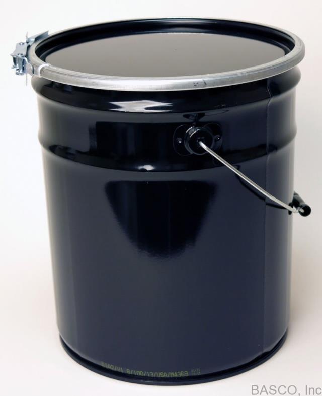

  Solar Mike said   Hi Mark, I used to re-condition large oil filled transformers years ago when I worked for broadcasting at a high power radio transmitter site. Occasionally they would go bang making quite a mess inside the transformer casing.
You need a steel or alloy case with welded seams and a flat right angle section welded around the top where the lid goes; the strong lid sits on this flange on a cork gasket with lots of bolts, the transformer is suspended from the lid and sits in the oil. You will require insulated through connectors (brass threaded rod and a piece of nylon kitchen chopping board would work). There must be an air gap above the oil level with a vent tube to the outside to allow for expansion, a silica gel moisture filter is normally attached to the vent. You probably don't need this with only 240volts.
We used to get the transformer oil from Shell depot in large 44 gal drums, its very thin about SAE #5, best local source would be a power line depot or similar.
Mike
Phuk!!! Sounds like too hard basket, so that's why no one does it in small units
Cheers Caveman Mark
Off grid eastern Melb
Posted: 09:32pm 15 Oct 2018
That is all for a heavy duty commercial transformer that may weigh a ton to hundreds of tons, and may need to be picked up by fork lift or a crane, and transported by truck, then sit out fully exposed to the weather for decades.
All we might really need is a fairly common five gallon steel pail.
Sit the toroid up off the bottom with some kind of spacer to allow the oil to convect freely, and just feed the wires in through the open top.
A lid would be nice, but not essential, at least to begin with.
If the whole thing turns out to be a crappy messy impractical idea, just let all the automatic transmission fluid drain off the toroid and run it dry as it was originally.
