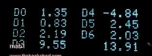

I think i may have discovered a possible 'bug' in MPPTv5_BV_tempco_day_totals ?
At the very end of Void init_controller there's this bit of code:
if (nvd.pwm_freq != 20 && nvd.pwm_freq != 40)
   // set default at 20 kHz
   timer1_period = 833;
   baud_waits = 1;
   ints_second = 19200;
   freq_scale = 1;
 else
   timer1_period = nvd.timer1_period;
   baud_waits = nvd.baud_waits;
   ints_second = nvd.ints_second;
   freq_scale = 2;
If my reading is correct(?!), then if nvd.pwm_freq == 20 it will actually set freq_scale = 2 instead of 1
I dug this up as i seemed to be getting radically longer delays at 20kHz than at 40kHz, and noticed freq_scale = 2:
void dlay(int n)
 int d;
 if (freq_scale == 2)
   d = n * 8;
 else
   d = n;
 dlay_timer = 0;         // a simple delay loop that uses the 20kHz pwm interrupt as a clock
 while(dlay_timer < d) ; // This while loop will only exit if pwm interrupt is working.
Trouble is,i've hacked my version of the code so much i'm not sure what i've messed up, but that appears to be in the original code.
I'm still not sure how i did this to the day 4 total

Hi Mab1
you have found a bug. This is good, I can fix it for us.
Thanks for that.
we need to apply the correct frequency scale factor
which is used in a few places in the code.
The fix is in Red
  baud_waits = 1;
  freq_scale = 1;
else
  if ((nvd.pwm_freq == 20)
     freq_scale = 1;
  else
     freq_scale = 2;
the next bit also seems an error and likely a remnant of testing something or other.
void dlay(int n)
int d;
  d = n * 8;
else
  d = n;
change this to
void dlay(int n)
 int d;
 d = n * freq_scale;
 dlay_timer = 0;         // a simple delay loop that uses the 20kHz (or 40 kHz) pwm interrupt as a clock

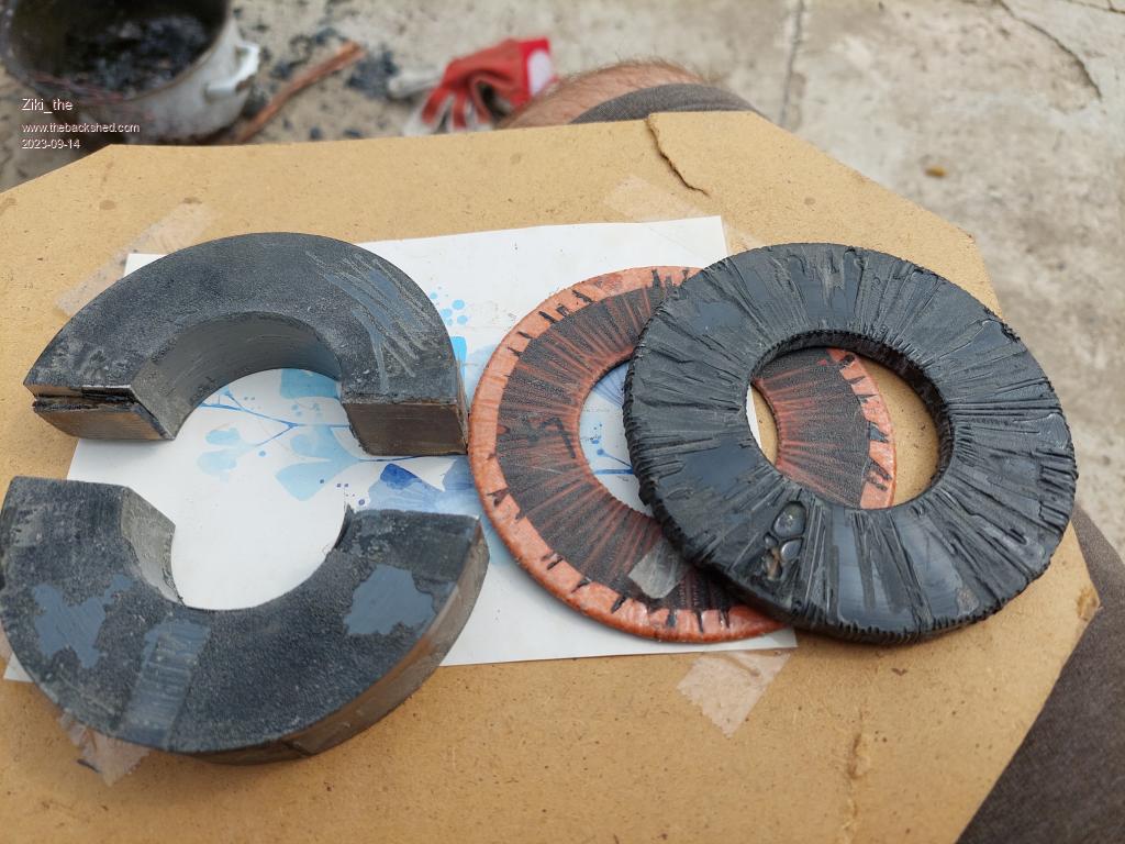

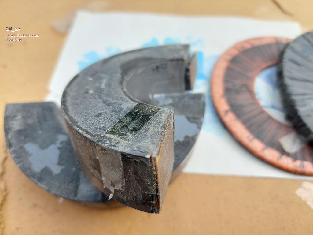

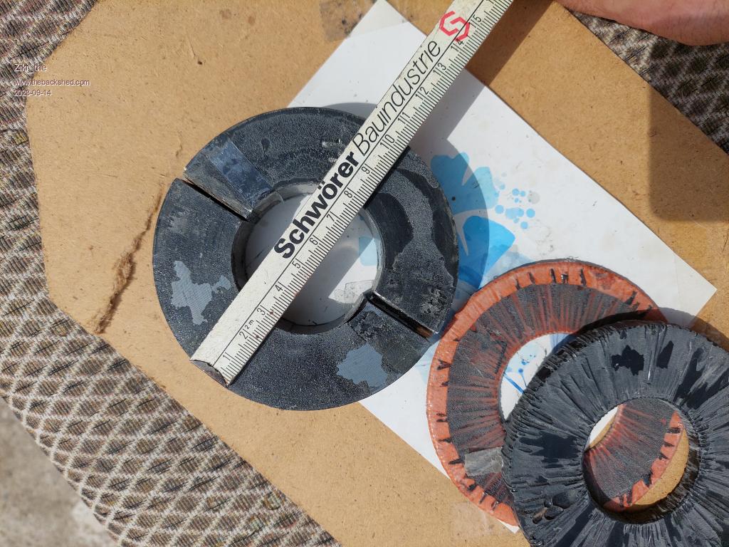

Today I played with fire, the result is extremely unusual. The original choke(epcos) was 1.4mH from the motor inverter 11KW.
An iron torus cut in half.
I will try to wound some wire and give a litle test.
Did someone stumped on something lile this?

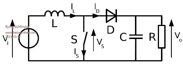

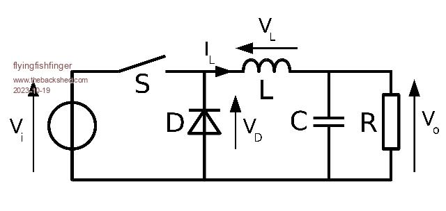

  poida said  NO idea at all if it will work in a boost situation.
It will not, with the existing hardware - a boost converter has a different circuit from a buck converter.
Buck:
Boost:
So the arrangement of the inductor vs the MOSFETS is different as is the control algorithm as already indicated..
