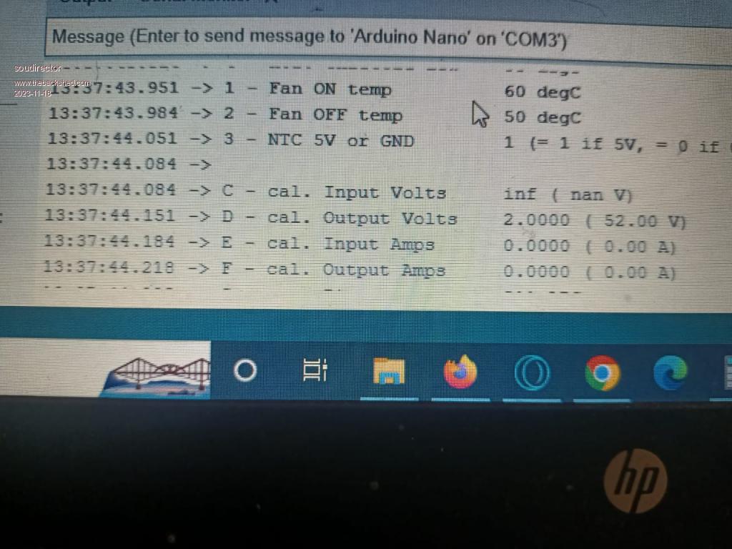

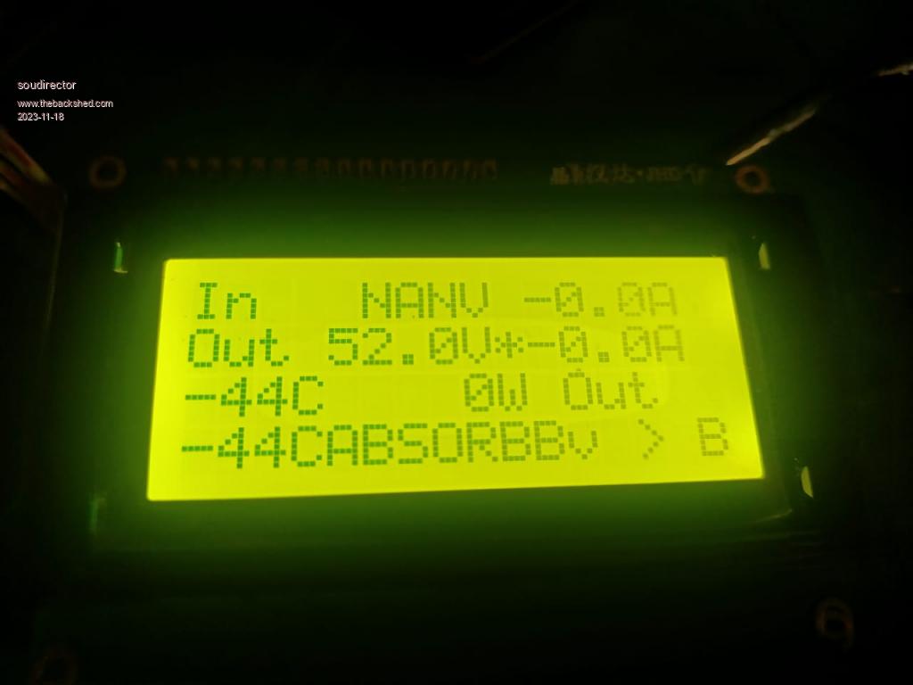

I am have not gotten this to work. When cal. i type in the VIN but i still have NANU display.
in the serial monitor window
it will change to this
13:37:44.084 -> C - cal. Input Volts     inf ( nan V)
But VOUT display whatever i put there.
What am i not getting right ?

  soudirector said  I am have not gotten this to work. When cal. i type in the VIN but i still have NANU display.
[/QUOTE
I think you need to " zero " it first
I think had something similar - one of the cal values 'inf' and wouldn't reset: i think i cleared it by selecting the 'set defaults' (option Z?), but this does mean you have to re-do all the zeros, cals and setpoints again.
