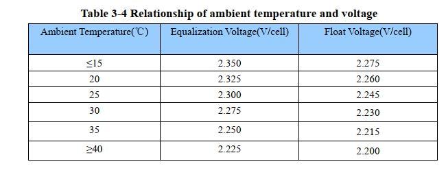

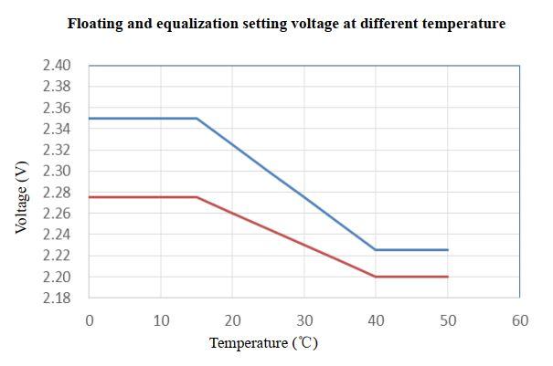

I use the BV absorb tempco for 18 months or more.
My battery needs the absorb voltage to be modified by about -0.12V per degree
over a range of 15 degC to 40 degC
this is from the manual for my battery (blue is absorb/equalisation)
which is this data
Battery temp offset is used to trim the 10K NTC thermistor to within a degree of what
is shown from a K type thermocouple
This is only -1 in my case.
BV tempco is set at -0.12 for my battery
Absorb BV std. temp is needed as well, since I am using a simple linear function.
A linear function needs an offset and a slope.
The battery manufacturer chose 25 degC as my offset.
This setup works flawlessly and continuously modifies the max charge voltage
depending on battery temperature.

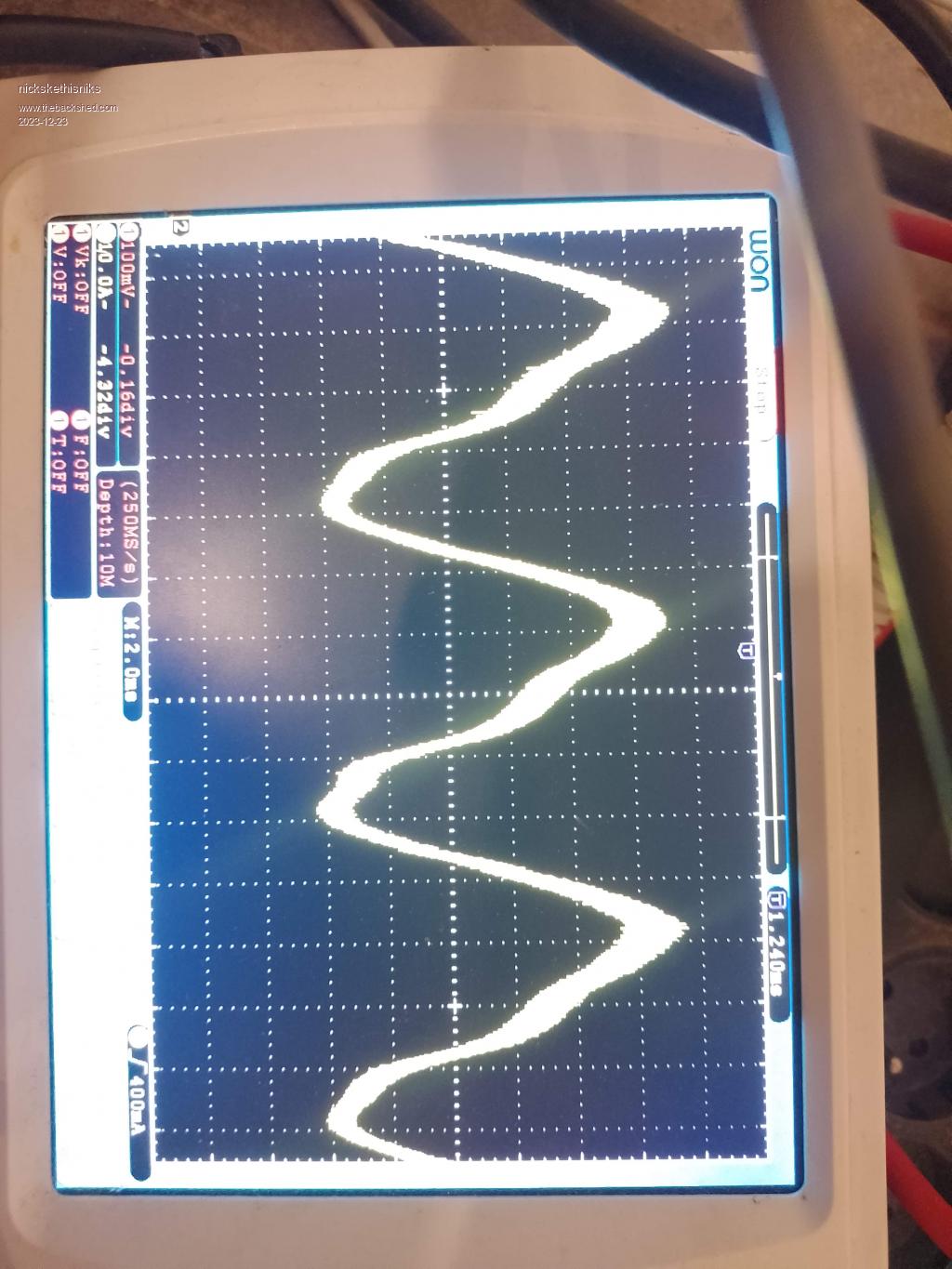

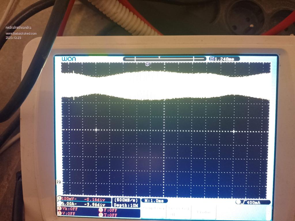

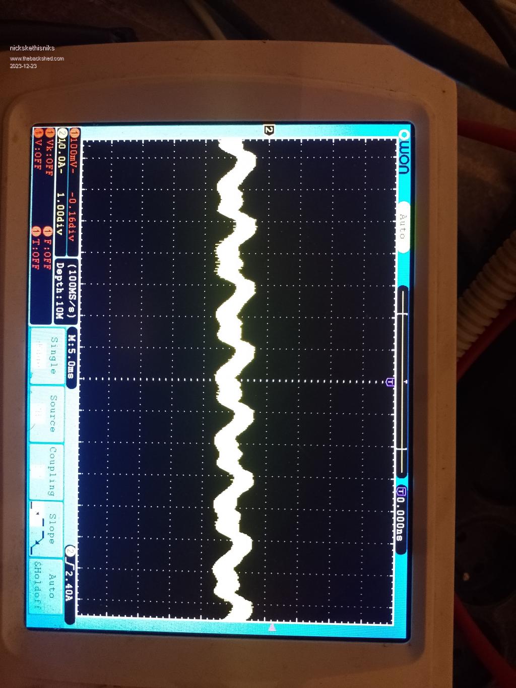

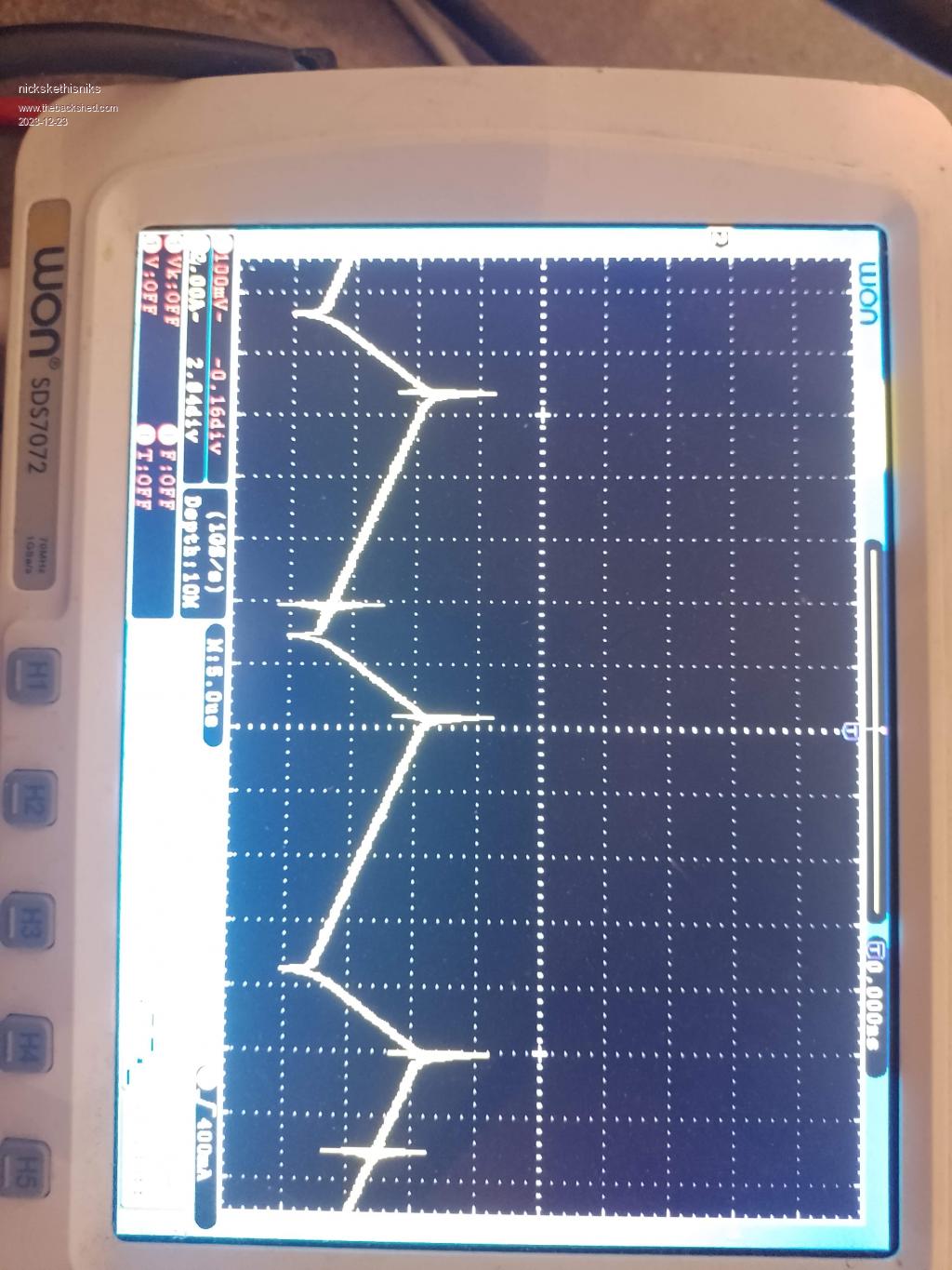

Here there is a waveform of the input current,
(readings are actually 1/10 so around 3-5A at that time, I don't know)
The current probe I'm using is a micsig CP2100B and it's picking up switching noise quite easily, not all noise is actually real.
I think this is a quite usual waveform, although you can already see some 100Hz influence.
Next image is on the outputcurrent (again actual current is 1/10 of the current measured)
What we expect is a rather clean DC waveform but there is a substantial AC ripple current, coming from reactive components and/or current ripple because of long wires between my battery and inverter. Power was only 2-300W (at 48V) at the time.
Next a waveform of the current thru the buck inductor (I had polarity wrong)
Then with longer timebase ( again polarity wrong) you clearly see the 100hz again
Sorry for the turned pictures.....
