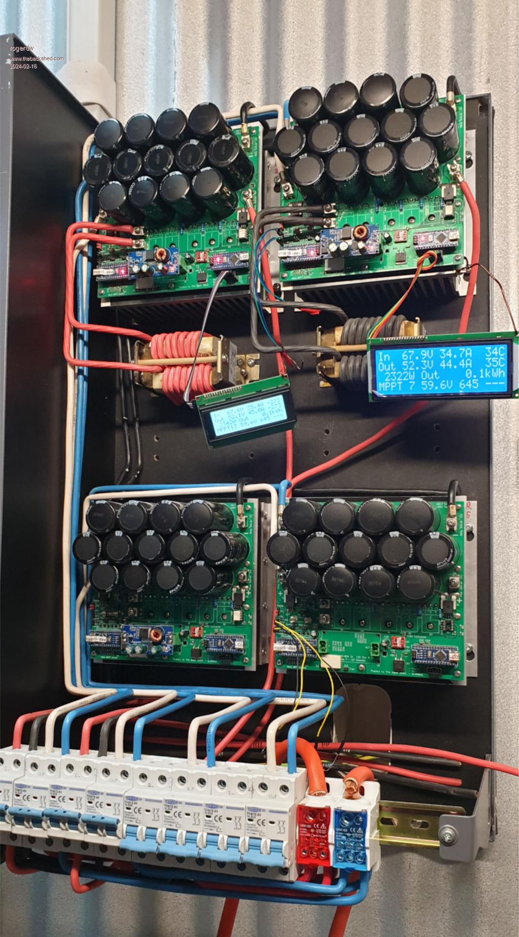

I have built four of these and will parallel them all up once I fit the remaining panels.
I have 4 banks of 3kW  ...  3s4p. Half are older 250watt panels and the rest 275watt.
If I ever decide I need more, I possibly would use an older grid tie inverter and connect to my own mini grid.
Cheers,  Roger

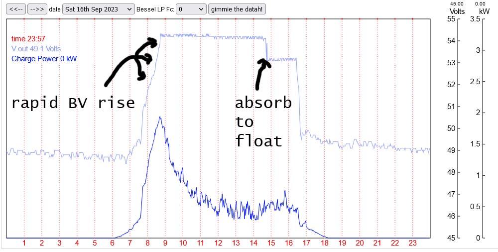

I was educated by looking at my battery as it's voltage rises
as it approaches the absorb voltage.
The voltage rises very quickly.
If I wanted to use the float charge function, I would use a large absorb tolerance.
This is to permit large voltage variations and still remain in absorb mode,
counting down the programmed time.
I suppose a better way would be to time average battery voltage and then
do the BV < (absorb - absorb_tolerance) decision.
That would be nice, actually, now I think about it.
If we sample BV each second over 5 minutes (300 times)
and average this, it will permit short BV drops due to motor startup and
other things to occur without upsetting the absorb period.
your work shown above looks great.
the top right mppt is running at
67.9 V x 34.7 A or 2356 W input from the panels
it's about 98% conversion efficiency.
not too bad at all.
here is when my battery approaches absorb voltage.
See how fast it rises with nearly constant charge power (or current)
and how fast the charge power drops while maintaining absorb voltage!
Dark Blue is charge power
Light Blue is battery voltage
it seems to me that my battery (everyone else's battery will be different)
is very sensitive to charge current when near absorb voltage
and nearly anything will make BV drop.
Edited 2024-02-16 17:54 by poida

Thank you. I was just so pleased and relieved that they all worked okay  ...  so it's even better to see that sort of efficiency.
Thanks for such an excellent design and all the work you've done over the years fine tuning it  ...  and then giving the design away. Awesome work man.

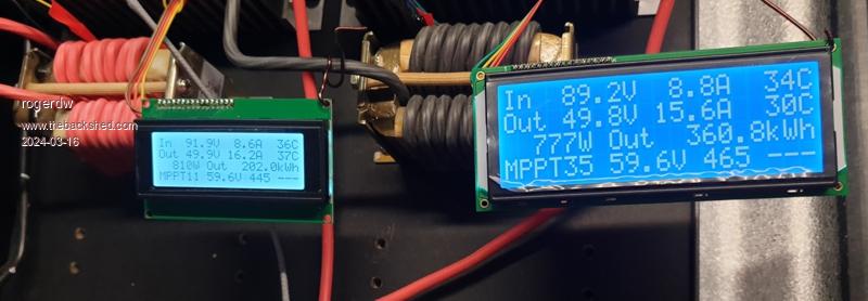

I had an interesting experience a couple mornings ago when I went to check the system  ...  about 8.30am and I was still a bit bleary eyed.
One mppt was showing 777W OUT but the other one was showing "BLOW OUT"  ...  and I'm trying to work out what sort of sick code Poda had programmed in to make it show that    Actually took me a few seconds to realise it was 810W OUT and not BLOW OUT.
Later the same day I walked past and saw both were pumping out 55A each and 3000W plus. Of course by the time I got my phone out for a shot it had changed. Went up and down a lot for a while  ...  cloud edge effect?? Not bad for 3.3kW of s/h panels on each. Very happy.
Spent the day installing another dozen 250W panels, so will hook up the third mppt shortly.
Cheers,  Roger

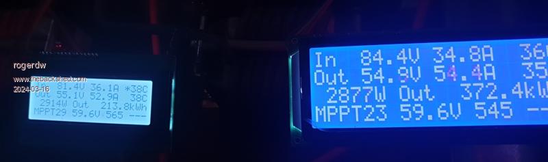

I fitted another dozen 250 watt panels on the weekend and hooked up the third mppt. Only thing that's a little disappointing is that the output is quite a lot lower than the other two that each have a dozen 275 Watt panels.
While the first two might be pumping out 2,800 watts each, the third one might only be supplying 1,800 watts. Now I'm weighing up if I fit the other 12 x 250 watt panels I have here  ...  or sell them and buy some more 275 or 300 watt panels instead.
Cheers,  Roger
A lot depends on the load each mppt sees.
Let's say you have 2 mppt that are pumping 6kW into the battery. Their
Battery voltage calibration are quite close to exactly what the battery is.
And you add one more mppt, but this time, it's calibration sees the battery as
maybe 0.2V higher than the other 2 mppts.
Once the battery gets to ABSORB, the first 2 mppt will be putting in a lot
and the 3rd one not a lot at all, if any, since IT sees the battery at ABSORB or even
0.2V over ABSORB voltage.
In my system I have two mppts, one taking power from a North facing array (3kW)
and one taking power from an East facing array of panels, again 3kW.
Most days, when I have clear skies, I see ABSORB around 10am or a bit later.
One mppt is doing ALL the work while the other is doing nothing much, maybe 100W or less. This is due to the low power mppt thinking that the battery is exceeding
ABSORB voltage and so it throttles back to near zero. As it should.
In your case I think you now have 4 mppts, with 4 arrays. (or maybe 3, I am not
sure).. anyway, if you are getting to ABSORB voltage then expect one or more mppt
to throttle back before the last one does.
But when they are all in MPPT mode, then it's different. If the battery voltage
is well below ABSORB, then they all should be trying to output full power from
what is available from the panels.
Of course, one array of panels might well be oriented in a different direction than
the other arrays and so it should not be able to produce as much.
For best results from the mppts, we need to keep the voltage difference of
the battery and the solar array to less than a factor of 2.
Maybe even 1.5x.
The DC-DC conversion is most efficient when this is the case.
It MUST be well above the battery ABSORB voltage though.
