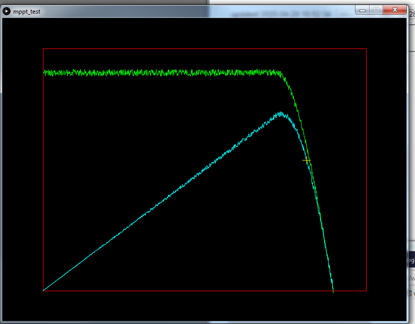

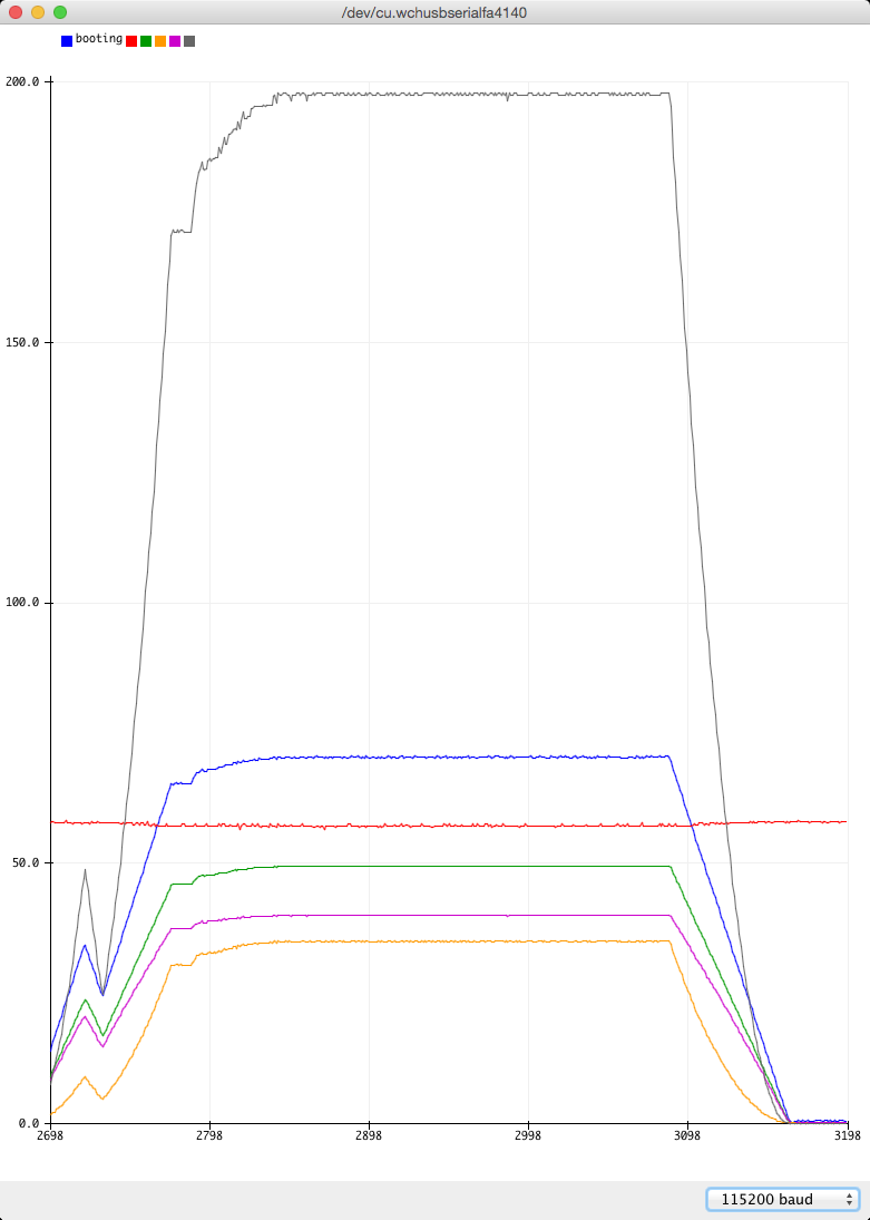

Here is a graph of a 2kW test, showing how good the noise it now using on-board LP filters. No digital filtering is used in this test.
Blue is PWM/10, Red is Vin (Volts), Green is Vout, Purple is Iout (Amps), Orange is Iin, and Grey is Power Out (Watts/10)
I drive the controller via a potentiometer by hand.
There is NO LP filter on Vin, and so it shows some noise. But there IS filtering on Iin, Vout and Iout. Note that this is converting 2kW. 57.8V input. A non-trivial experiment.
It has been a bit of work and some frustration this weekend but things are in a good place for me to start work on mppt code.
I have seen the simulated solar panel, effected from a buck converter and some custom code does not work at all well. I had to chuck that idea in the round file bin and think again.
What resulted is I have hacked into the Manson 30V 5A bench supply and have janked into the current limit circuit. This as it happens rides on the high side of the output, 30V. All I needed was to alter the voltage across the 5K pot.
Thinking why not use a digital pot (they are isolated from SPI or I2C bus, great!) but I did not have any at hand.
The solution and it is an ugly one but it works - was to capacitively couple PWM to the two terminals of the 5K pot. Again, I used an Arduino Uno. Some simple code and a voltage divider giving the code the output voltage lets me produce a solar panel-esq Current v Voltage curve. Much better.
The code outputs a PWM depending upon the bench supply's output voltage.
I get something like 4.5A constant current limit from 5V up to 25V and then linearly reduce the current limit from 4.5A to 1A at 30V. Somewhere around 25V is maximum power (25V x 4.5A) and my mppt code had better find it.
Probably next weekend is the time to develop some working mppt code that uses real world data acquired from noisy and relatively low resolution sources.

initial fun with mppt simulation.
The below code makes a simulated solar panel with a certain current/volts curve.
Green is current, light Blue is power, the X axis is volts.
The cross is where the mppt algorithm is at any time.
The noise can be controlled by pressing "n" or "N" to decrease/increase
It seems the mppt algo has stuffed up and not found max power.
It does find it easily with zero noise.
to run this, you will need "Processing" a free and open source programming environment
I would put it in the CODE /CODE container but that removes square backets and that is a pain.

  // perturb and observe
  // A naive approach - works with noise free data
  // but NFG when there is noise.
  // get the power now
  pwr = volts[pwm] * (amps[pwm] + random(-gr,gr));
  // has it increased since last time? if so, keep increasing voltage (or pwm, same thing)
  if (pwr > old_pwr)
    pwm_dir = 5;
  // has it decreased since last time, if so, keep decreasing voltage
  if (pwr < old_pwr)
    pwm_dir  = -5;
  // alter the voltage as required
  pwm += pwm_dir;
  // and record the current operating power for next time through the loop
  old_pwr = pwr;
  if (pwm < 1) pwm = 1;
  if (pwm >= np) pwm = np-1;
  // draw a cross where pwm is (i.e. operating voltage)
  draw_it();
  stroke(255,255,0);
  x = ox + sx * 0.9 * (float)(pwm)/(float)np;
  y = oy + sy * 0.9 * (amps[pwm]/imax)*(volts[pwm]/vmax);
  line(x-8,y,x+8,y);
  line(x,y-8,x,y+8);

Hi Peter, as you know software is not my forte but I have been looking at and trying to understand the code.
I am not sure about the section that says increase voltage or pwm same thing.
Maybe this is a source of the behaviour that you are not happy with.
To me voltage when charging a battery will remain constant (output side not input) however current and power are variables we can watch and alter.  The input volts are part of the discussion and max power occurs around the knee, altering pwm will alter the current and therefore power however as we increase PWM the current to the battery will increase but as current increases the input voltage decreases.  Output or battery voltage will stay quite stable in this process - if you are using a resistive load then it behaves totally differently to a fixed voltage sink load (battery).
The part that read "increase voltage or pwm same thing" doesn't apply to the input or output volts in normal operation ?  I havent really thought much about it but max power to a resistive load and max power to a battery will probably occur at different places - I have to go out right now will think a bit more about this on my return.
So maybe I just dont understand your code and you already know all this but thought I would mention it in case it helps.
