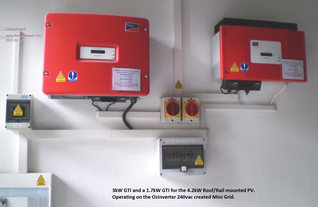

AC COUPLING , or Back charging the batteries
I have not used a HF, High Frequency,  GTI because second hand old heavy toroidal types are easily obtainable and very cheap, plus you get to use the GTI internal MPPT .   'Oztules' and others have experimented with HF types and do not find any real difficulties.
I have always seen AC coupling as the way forward, rather than just DC and many expensive charge controllers.
I originally bought a very expensive, so called Rolls Royce of commercial Inverters, 48vdc to 240vac, Firstly it couldn't do the specified 6kW and constantly only do 4.2kW, secondly it needed a lot of expensive propriety ancillary control equipment to function and back charge the batteries correctly. And thirdly It raised the 240vac HZ frequency from 50HZ to 60HZ and domestic equipment failed.
It went back, and the company put a gagging order on me not to talk about there crap toy Inverter.
'Oztules' stepped in, and like me he wanted a true and real Inverter that would do the AC coupling using a H bridge design without all the fuss.   Our Mantra .... KEEP IT SIMPLE, MAKE IT ROBUST, and importantly MAKE IT COST EFFECTIVE.
A very cost effective solution for handling that 19kW of power from the PV array, is to use what is called 'AC Coupling'.
Houses that you see around the World with PV on the roofs will be using GTI's, (Grid Tied Inverters) that take the PV dc output and change it to ac and feed it back into the Mains Utilities Grid for that Country.  These GTI's are slave machines and need to see the correct ac voltage and the correct HZ frequency, so to get there internal electronics/transformer to operate before they will feed into the Grid a few volts over the Mains Utilities supplied voltage.
There are many Good Quality GTI's available second hand, i use fleebay etc, and i prefer GTI's with a toroid transformer,   see below photo of previously used SMA's........ .       150 to 300 Euros each.
The 48vdc OzInverter creates a very stable 240vac or 120vac at a stable 50H or 60HZ and therefore allows 'AC Coupling' the GTI's back charge through the OzInverter to the battery bank.
Three methods of controlling the  back charging from GTI's is possible for 'AC Coupling'.
A.   Use the Internal codes/settings in the GTI's to sequential shut down when a specified ac output voltage is reached. This works reasonably well with my system as some installations GTI,s are up to 400 meters away from the OzInverter and batteries, and the batteries do push back slightly, but this depends on the cable voltage sag.
B.   Use dc voltage comparators circuit to shut down the GTI ac side with a relay when the DC battery voltage rises above a charging rate voltage. But you will need to run a data cable to all your installations, and again allow for voltage sag.
C.    Use PWM dc controllers that are connected directly to the 48vdc battery bank. These Diversion controllers, (Morningstar Tristar PWM at about 200 Euros each), will regulate the charging and any excess power when the batteries are full and will dump/divert to other permanently connected sources, ie, Air Heaters 2kW each or Hot water heaters, underfloor electric heating.
The above are a cost effective and very reliable system, A is used most and C is my guaranteed safety system. Where i do not have access to the GTI internals, then i use B.
For a 19kW Array I prefer using 2off 1.7kW & 4off 2.5kW GTI's for 14kW, and using DC Charge controllers for the 5kW as these can gently finish charging that precious 48vdc battery bank.
I trust this information helps.

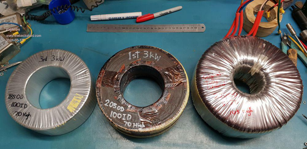

I've only unwound three 3kW and one 1.5kW AeroSharp inverters  ...  and I do recall being surprised that the 1.5kW used 1.8mm wire for the 92V winding  ...  while the others were mostly all 1.6mm.
My collection also inludes some 2kW units, but I haven't actually stripped any of their windings yet.
I agree that they appear well made and I'm not even sure what was wrong with the ones I dismantled. They all came from a solar inverter repair co  ...  though I suspect the company is only called that to attract people with solar issues  ...
...  then they just sell them new inverters.
One of the 3kW units had shorted turns on the toroid  ...  and I reckon one of the others had a faulty IGBT module.

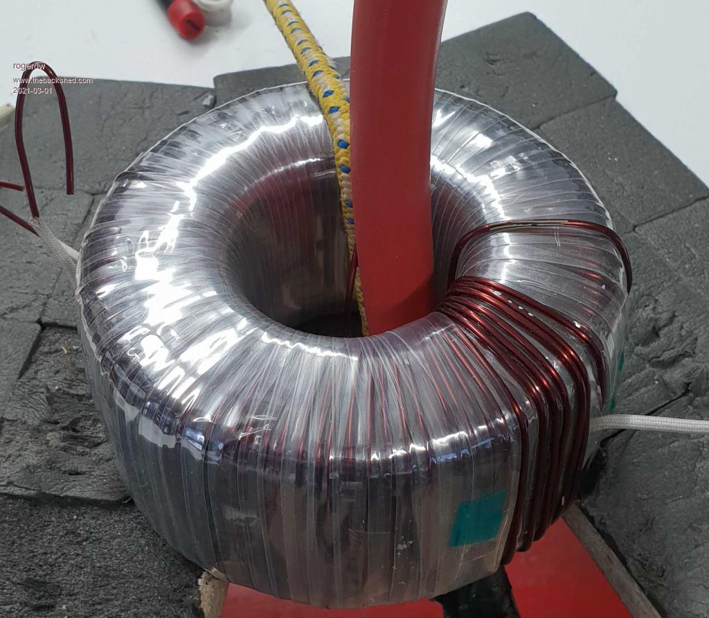

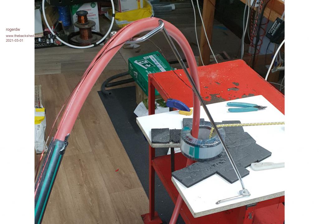

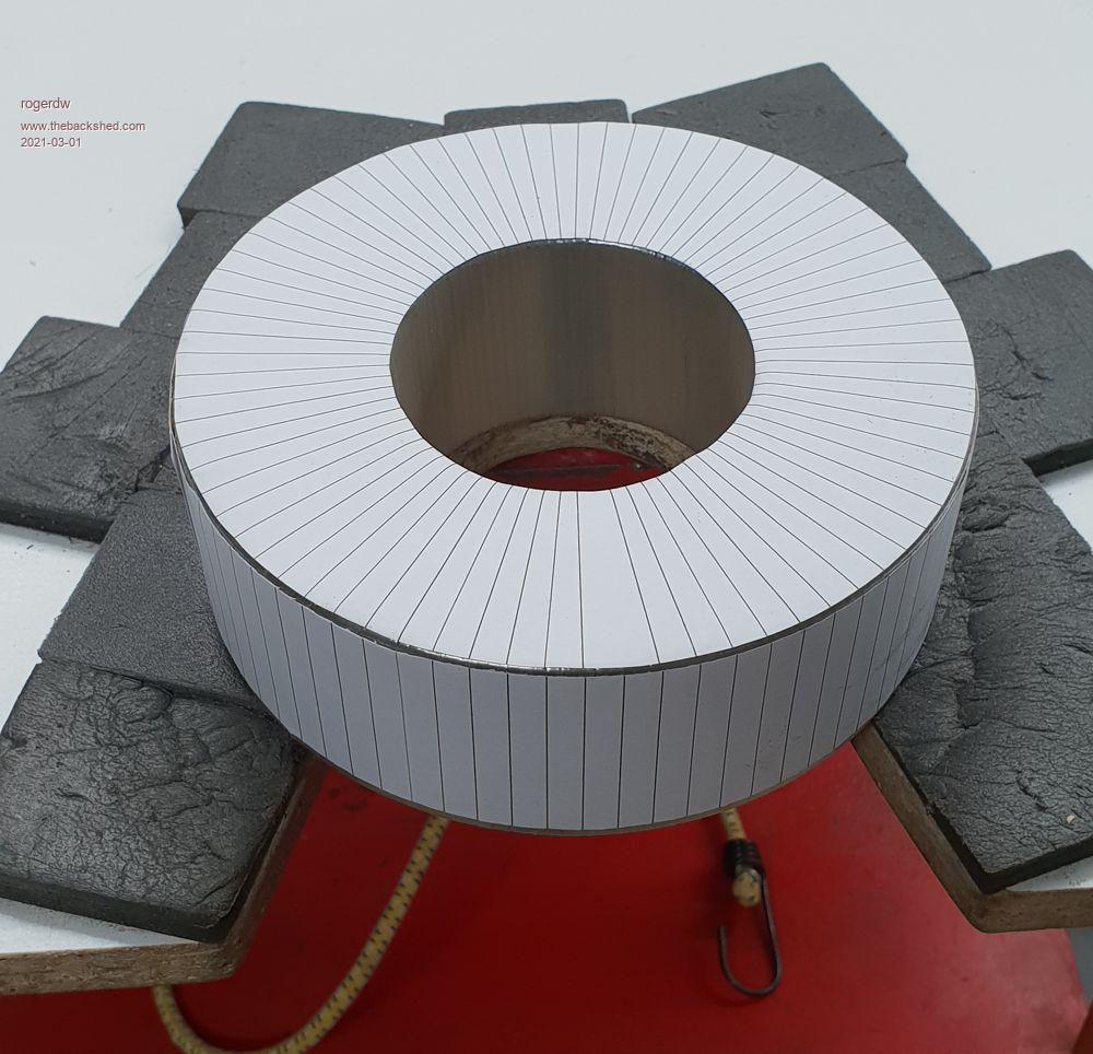

Posted: 09:39am 28 Feb 2021

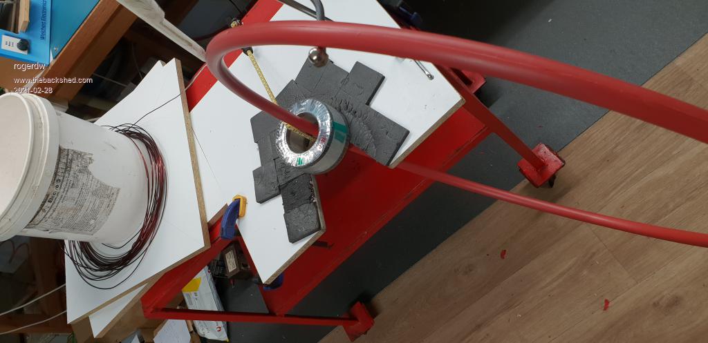

Okay  ...  for those of you wondering if I've given up or not!!!
I'll upload some photos, that'll save some typing
I've taken the lead from Klaus and 'frackers' and am using a hoop through the core rather than small reels.

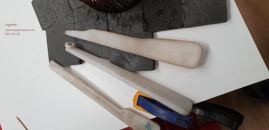

First photo is of some tools I made to help with the winding.
The one on the left is shaped so it sits in the slot of the hoop to help open it, plus push the wire around as I load the hoop. Works great, I seemed to have fluked the shape so it stays in the slot and I just push the wire around and into the hoop which closes up behind it.
The middle tool has a small roller on the end so I can roll the windings into place if they are raised too high for when I wasn't careful enough  ...  and the last one is just a poker/push stick for shaping the windings and getting them closer together.
They're all made out of an old plastic cutting board I've used in the workshop for 20 years or so.
The hoop is an old kids hula hoop which I slit using a plastic cutting disc in my Dremel. The hoop has an OD of about 19mm  ...  and I am surprised just how much wire can fit inside.
Using some 1.7mm wire from an old 3kW AeroSharp toroid which was 52mtrs long  ...  all of it wound easily inside the hoop. I have no doubt I could get at least another 50 mtrs inside it if I needed to.
It is 670mm diameter  ...  so 2.1mtrs of wire per turn
Here I'm loading the hoop with the 52mtrs.
This will be the first winding on my #4 transformer  ...  2 windings of 169 turns.
Not sure why the site is rotating my pictures. Anyone know how to fix that?

Posted: 10:35am 28 Feb 2021
Looking good and a wise choice to start with the small one - i started with the big one .
You might consider sitting the core onto something smooth like you table surface when you wind it as it will slide much easier around. I wound the big double core on a curved support (so I could look into its *horizontal* hole). I found that way safer after it nearly slid off the table while winding it like in your pic. Its *very* heavy even when empty and you won't be able to catch it should it slide off the table.
The smaller, narrower, cores are fine to wind as you show.
I like your 'hoop', great find, and your wire loading tool looks a lot smarter than that wood dowel I used.
When sticking on the paper radial marks to align the wire you only need that on the top as you can't see the bottom of the core anyway. Perhaps spaced lines around the outside of the core help to keep the wire straight.
The roller on your 'pushing' tool might be a nuisance, I would have cut just a groove at the tip to exert maximum leverage.
Have fun, I hope you have strong hands - you certainly will have them after this job

  Murphy's friend said  Looking good and a wise choice to start with the small one - i started with the big one .
Thank you  ...  I'm not always good at listening to advice, but glad I did in this case.
Already the difference between my first transformer (#4) and the second one (#3) has been an improvement.
  Quote  You might consider sitting the core onto something smooth like you table surface when you wind it as it will slide much easier around. I wound the big double core on a curved support (so I could look into its *horizontal* hole). I found that way safer after it nearly slid off the table while winding it like in your pic. Its *very* heavy even when empty and you won't be able to catch it should it slide off the table.
Yeah, I'm not sure why I chose this way  ...  but it seems to work ok for me  ....  but I'll certainly consider changing for the larger transformers.
The black foam is relatively soft, so they don't slide too well  ...  which suits me fine so far. I have fitted an ocky strap through the core to help prevent it sliding off the front if I get too physical.
  Quote  When sticking on the paper radial marks to align the wire you only need that on the top as you can't see the bottom of the core anyway. Perhaps spaced lines around the outside of the core help to keep the wire straight.
Yeah I did exactly that  ...  just one on the top and one around the outside to help keep them vertical.
  Quote  The roller on your 'pushing' tool might be a nuisance, I would have cut just a groove at the tip to exert maximum leverage.
The roller tool really needs two hands to control it to work the best as it can roll too freely  ...  which is a bit tricky when you also need a third hand to keep the wire tight.
I've taken up wrapping my thumbs with masking tape before I put on my gloves  ...  but it's my middle finger that's suffering at present. I'll have to change fingers for the next layer.
I know you said you were able to sit down to wind yours, but I've had to stand to do the job here  ...  and particularly for the first one  ...  I ended up with jelly legs from squatting down to get the wire underneath properly  ...  then standing up to complete the turn. The first few days were a bit painful  ...  but my legs seem used to it now.
I'm actually enjoying the winding  ...  in a perverse sort of way.
Looks like my images still won't show. Dunno what's up there.
Cheers,  Roger

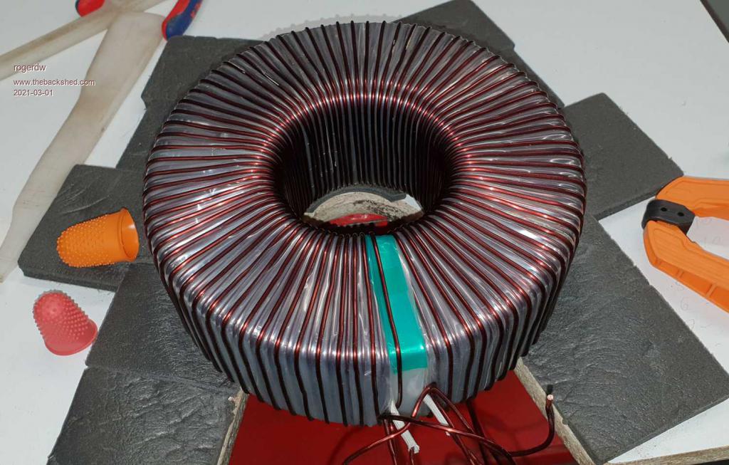

#4 Transformer nearly ready for the secondary
#3 Transformer with template fitted as a winding guide. It helped a lot.
Cheers,  Roger

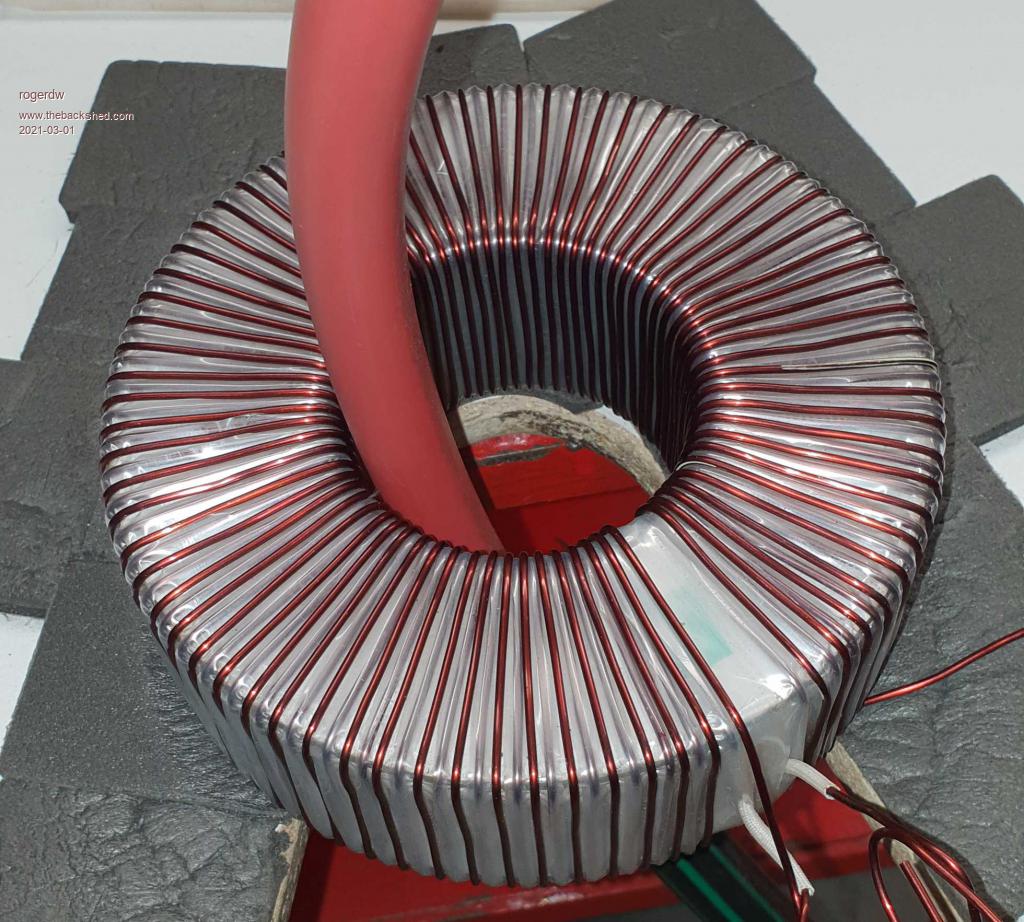

Posted: 01:27am 01 Mar 2021
Two layers done and two to go on #3 Tx.
This shows the support for the hoop. Just pulled some scrap out of the junk heap and screwed it to the base board  ...  and bent it back enough to 'hang' the hoop in the right spot.
Cheers,  Roger
Haxby
Joined: 07/07/2008
Posts: 427
Posted: 03:49am 01 Mar 2021
Great work! Very neat!
Murphy's friend
Joined: 04/10/2019
Posts: 678
Posted: 09:25am 01 Mar 2021
Yes, very neat indeed - much neater than mine was done, your wire spacing is the neatest I have seen on this forum.
I see you did not use a rounded cheek spacers on the cores,  perhaps that is the reason your fingers are sore   . I did not use any gloves nor masking tape on the fingers .
Re doing it standing up, you would not even consider it if you had my bad back. I used one of those B&D workbenches which was just the right sitting height, it even had a foot rest.
Good idea that hoop support with your big hula hoop, my smaller hoop was OK without that refinement.
You might remember seeing a picture of that split PVC tubing I hammered into the hole after each layer but before applying the mylar. The PVC outside was waxed, the epoxy I poured down there securely locked the layer in place while it was pressed against the hole. This allowed only one layer per day but I think was very worth while.
My toroid transformers are very quiet, the only hum comes from the choke if the two halves are not clamped very very tight.

  Quote  Good idea that hoop support with your big hula hoop, my smaller hoop was OK without that refinement.
Yeah, I was really pleased how the hoop stand worked out. Early in the planning I was thinking about all sorts of complicated ideas of supporting it with rollers and all that stuff  ...  but the way its turned out, I can still hold the wire taut with one hand and easily spin the hoop around with the other.

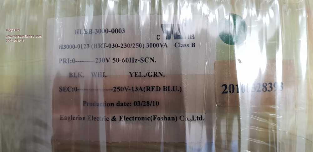

I just picked up another 3kW AeroSharp and have unwound the transformer ready to wind #2 Tx (second biggest) transformer.
Something that I do not recall having seen mentioned anywhere in all the threads on the Ozinverter and Warpinverter is that there can be two quite different size 3kW toroids.
As you'll see in the photos, some have an OD of 205mm while others are only 185mm OD.
The ID and height are the same at 100mm ID and 70mm high.
Obviously that makes quite a difference for the cross sectional area  ...  and for me, if I'm going to go to all this trouble winding transformers, I might as well go as big as possible.

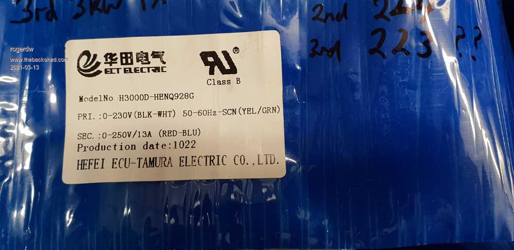

I've got two of each type  ...  and the smaller one has a paper label on a blue plastic tape that's wrapped all the way around and the larger has an off white paper label.
The tx on the right is one of the larger cores and has been unwound now.
This is the label from the smaller toroids stuck on blue plastic tape.
And this from the larger toroid made by Eaglerise Electric.
These are more of a pain to unwind as they are actually wound with three wires being wrapped at the same time  ...  and invariably one wire gets trapped under an adjacent winding and you have to be pretty rough to extract them. I do worry about damage to the insulation in this case.
