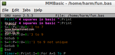

However saw 1 thing that intrigued.
Syntax highlighting is not perfect when line numbers are used...
When the line number is removed, highlighting works. See the top 2 lines of this basic listing. Also the second command on the line is not highlighted.
Maybe do not spend to much time on it. Nobody uses line numbers anymore...
Edited 2021-09-30 05:41 by Volhout

Hi Volhout,
Thanks for the bug report about the syntax highlighting, that can definitely be much better. Nano has a powerful syntax highlighting engine based on regex matching, but the resource/syntax file I cobbled together for alpha 1 is a real dog's breakfast. It looks like some keywords are set to be only highlighted if they are the first non whitespace tokens on the line.
