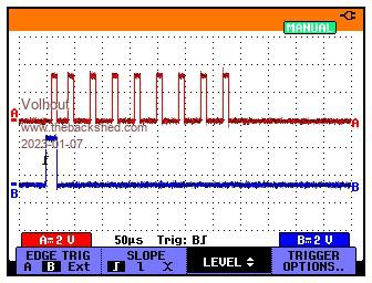

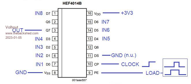

This is extra information, not related to the above exercises. Just for your information. There are also shift registers that need a clock pulse during the load.
Such a device is the HEF4014 (and 74LS166).
I have done the above analysis for the HEF4014. Not that it is of much value, the chip is near obsolete...
Generating a clock pulse inside the load puls is just 1 or 2 extra instructions for the PIO. This is easy.
Happy programming...

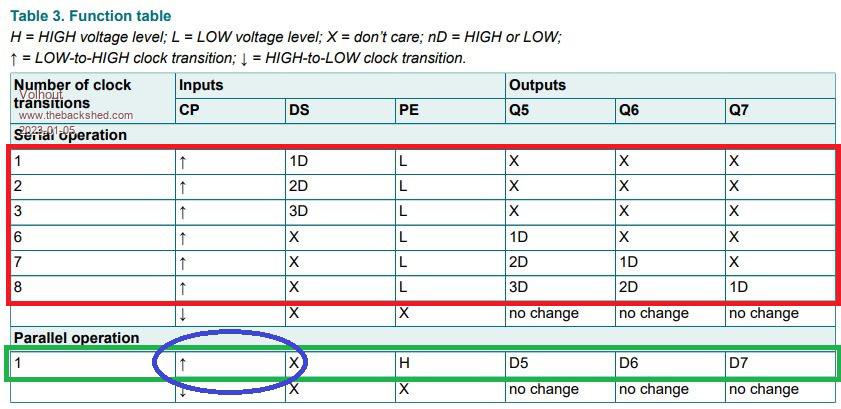

Tried to get data from CD4014BCN (16pin PDIP old). Help needed. This  Shift register does not need a separate "Load" signal. According to my understanding:
a. data is read at the rising edge of the clock pulse.
b. clock pulse needs to be long enough. Min 70ns. I added a delay for that.
c. serial input to 4014 is not used here. Serial input connected to GND.
d. paralell enable pin connected to +3.3V. Does it mean that paralell input is enabled? or is it the oppsite?

Posts: 6136
Posted: 03:04pm 06 Jan 2023
Hi Pluto,
If I look at the 4014 datasheet truth table, I see that the LOAD requires a H level on the PE pin. The SHIFT requires a L level on the PE pin.
See first post of page 5 of this thread...
Attached is the modified 4021 program, that works for my chip (HEF4014) tested. With the wiring as suggested in the 4014 post.

This is the waveform at CLOCK (red trace) and LOAD (blue trace)
Maybe your chip is defective, but I can't understand why you came to the conclusion that you do not need a level change on the PE pin.
Don't give up, I also went to bed several times in despair, and the next morning, I knew what went wrong. It is not always easy....
P.S. We run at 100kHz, that is 10us per instructions. For 70ns you do not add delay. You are 140 times slower without delay. But you added the delay correctly to the instruction.!!

Posted: 03:53pm 06 Jan 2023
I thought that PE was only selection between Paralell in and serial in. That is why I connected it to 3.3V. Obviously that was a wrong interpretation of the datasheet.
Sorry, I have no time to test now. Guests at the front door.
