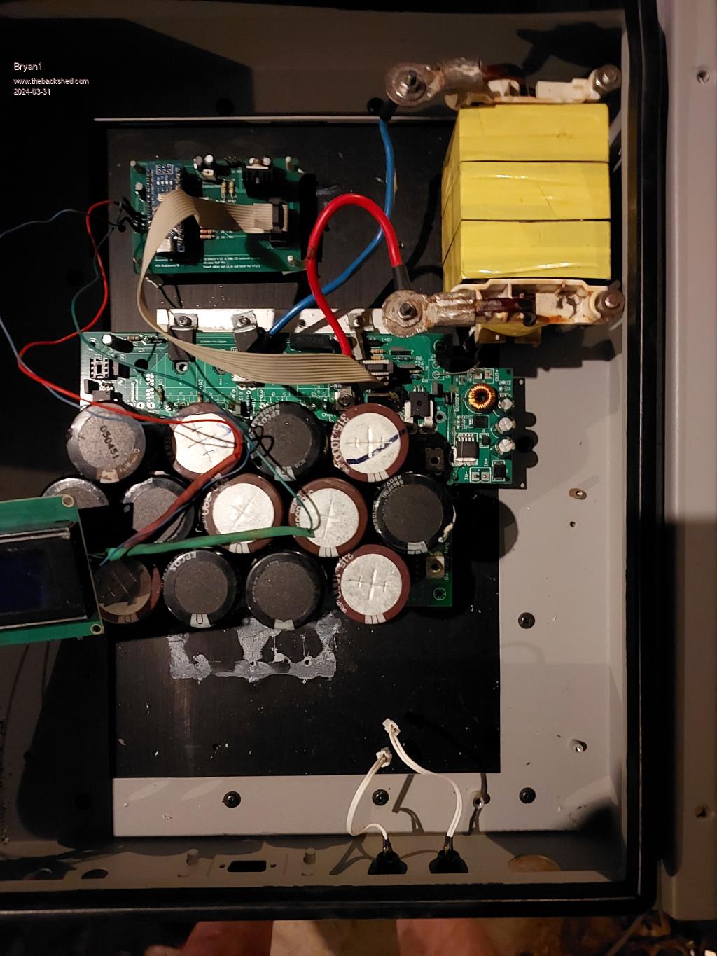

Now a month or so ago I did buy a uH meter from Altronics and got it out of the box today so I could measure the chokes I made. Now the one I made for that first MTTP measured 39uH and that other one only measured 3 uH   so it got NFG written on the top of it so I don't use it again.
As I do have a heap of those small toriod rings I'll make a new choke for the second MTTP using them and now I have that meter I can check. Now I did think about measuring that dual choke I made for my inverter but my longneck was just about empty so called it a day.
Had a look at at my MTTP's and all I need to do is put that earth link on and install the fet driver chip then they are ready for testing.
So in the morning the first job is fix the feet and break open my MC-4 crimping tool and make all the cables. I have drilled and installed the 10 cable glands on the terminal box and I still had just enough brass earth bar left to cut in half so 6x2 termination holes for both rails. I do need to drill/tap some M3 in the back of them so I can mount them on some fiberglass sheet.
I have cutout the face plate on one grid tie box for the lcd and rather than making a solid mount for it I reckon some hot glue will do to keep it in place. As this grid tie box did use clamps on the heat sink I'll use them them to secure the circuit board rather than use screws as the hole placement of the diodes doesn't match the holes on the pcb.

Bryan1
Joined: 22/02/2006
Posts: 2298
Posted: 09:07am 31 Mar 2024
Well it has been a long day working on this project,   now as they are predicting rain tomorrow all I got left to do is install the 10K NTC's and mount the grid tie box then hopefully this MTTP will come to life
As one can see I clamped the board to that heatsink using clamps and I did have to cut one thinner to fit the board and the board is now held nice and firm with the fets and diodes well clamped to the heatsink. Now you can just see on left the plastic sheet used as the isolation sheet and I did put the last of my heat paste as the bloody mice had eaten a hole and when I noticed my finger was white the rest of the tube went on there.
With that little power board on the side I hot glued it on then soldered the wires on so it does sit nicely beside the main board.
I am going to have to make longer wires for the LCD as when taking the cover off there does need some wire slack to undo the wires from the main brain board.
Now the brain board and the LCD are already programmed so it should just fire up when I connect it.
Also I'm going to fit a push button so the weekly totals can be shown with just one push.
Now as these 190 watt panels are 5 amp panels and with 10 of them it going to be interesting to see the input current and to find the correct wires once I got both sets in the shed it was showing 95 volts open circuit so it should in theory be close the max of this design but eh thats why we do build these things to so we can push them to the max.
With the other MTTP borad I did notice one by pass cap had a burn mark off the soldering iron   and I will check with my fluke 865 to see if I did destroy it but I do have some spares if it is gone.
Cheers Bryan
