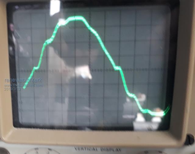

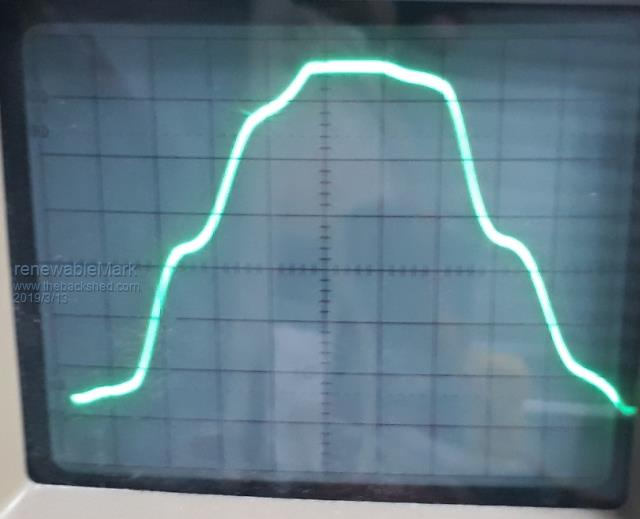

OK update,
went back to old torroid (I don't think that was the problem though)
Built a new power board.
problem seems to have gone.
No surging no flickering of lights.
Sine wave looks fantastic with fridge, compressor, blow heater, elec oven, toaster, any of those and it's fine.
BUT, hair dryer on low it turns to crap, this has been talked about previously as a known cause for crap wave as it chops half the power with a diode.
AND Air con on low settings.
It's a very late model inverter AC unit, on full power sine is fine, but low fan settings it turns to crap, it varies in it's level of crap.
Below are AC on low fan speed.
When the inverter was previously running fine it probably had this crap sine wave too, as I never checked it with the air con going. The air con appears to run fine, exactly the same as it does on mains power, so unless you checked with a cro you just wouldn't know.
I also put the mains back on and tested the sine with the air con going and not going, sine was identical.
It appears that my machine simply doesn't have either the grunt or stability that the mains has.
So questions are,
1. will having such a terrible wave damage the AC unit and or other things in the house?
2. will messing with my chokes alleviate this?
I currently have the double stacked E70ferrites in series with a double stacked 3kw aerosharp iron core. (Warp tested the iron one to be well over 100A saturation) I don't quite understand how any more could help.
3. Would more, or bigger caps on the power board help?
Edited by renewableMark 2019-03-14

Posted: 09:55am 13 Mar 2019
First thing I would try is without the ferrite choke, leave the other choke in.
I have taken the ferrite chokes out of my inverters.
A tip for you Mark, turn the brightness on your oscilloscope down until you can barely see the trace, this produces a sharper picture.

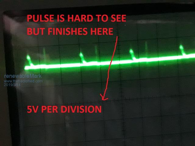

Since I have been having issues the house has been run on mains, last night after I got back from a job, the inverter got turned on again.... BANG blew all the fets.
This is starting to get demoralising .
On arriving home today the radio was giving me that terrible EMI again, so an effort was made to find it.
Turned out to be the Mad pwm controller.
Then the inverter DC terminals got tested while this emi was being produced.
This isn't the battery but the terminals that connect to the power board.
There is a stronger pulse and a lighter one which is hard to see on camera but very clear to the eye.
Would that be a concern?

Posted: 04:28am 14 Mar 2019
Good day Mark
Hang in there Mark the problem will be solved.
I feel no random pulse should be allowed.
Is the torriod transformer, the one that has been in service for months
and is the power board Maddness one, with driver transistors?
What system do you use to start the inverter ?
cheers john

  renewableMark said
Then fit caps, start it up and BANG!
I was previously able to start and stop it as many times as desired, now it just wants to be totally random.
So, has all that soldering and unsoldering damaged the caps? Test them individually on your battery bank (not inside the inverter) via a slow charge resistor. Just a guess though.
When something runs satisfactorily for some time and you then do some modifications, causing it to go 'bang' then you need to analyze *each* step that you took to see where the gremlins could have got in.
It could be something silly like a solder blob in the wrong place or something replaced the wrong way round .

Nup, that was a brand new set. Got more spares than RS components here (except for 4008's).
Don't understand why it ran fine on resistance power then ok for a while with caps fitted then a random BANG when restarted. There was no error from previous either, it was just a plain shut down with on off switch. Upon cap charge and turn on it just went bang. No reason, makes me sus of the 8010.

Well got me stuffed, Poida tested my Mad controller board and restarted it numerous times looking deep into it with his tricked up DSO.
Nothing wrong.....perfect. I suspected dodgey 8010's but nup... all of them were fine.
Something else is lurking in the shed.
