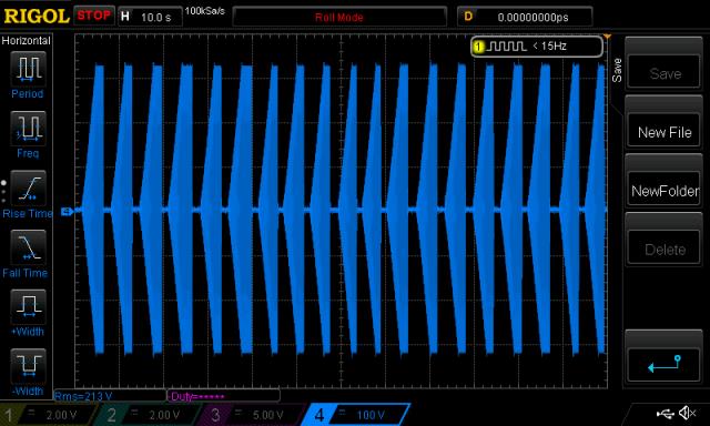

I found Mark's Mad controller board had very strange outputs on the 8010 pins.
I connected a 3.000V source to Vfb, to allow the 8010 to run continuously during the testing without connection to a power board.
The outputs would start at a high level near 4V top, -1V bottom waveform,
then quickly move down to 2.5V top and -2.5V bottom.
No worries, I must have the DSO inputs on AC coupling....idiot.
Nope.
No worries, there must be something wrong with my ground source choice.
Maybe it's hanging off a dud capacitor or something, giving the AC coupling effect.
Nope. All voltage regs are good, good grounds everywhere.
It was the IR2110 chips. Both were removed and the 8010 outputs , all 4, now became
correctly levelled at 0V low and 5V high. I wondered if the 8010 outputs were damaged, so I put a 1K resistor across each and saw all 4 outputs remain at 0V to 5V, as required by specs. They can drive 5mA, nothing wrong here. Specs say 20mA.
I put new IR2110 chips in, measured 8010 outputs, still 0V and 5V.
IR2110 outputs were 0V low and 17V high level, as expected.
I hooked this up to my long suffering test power board (with too small caps, but that is for good reasons) and it ran fine.
Mark gave me 3 other 8010 chips he thought produced the poor waveforms and all 3 tested fine. I have a great running Mad control board, with 3 spare 8010s here...
I stopped and started the board using one of the "dodgy" 8010 repeatedly:
The trace is AC volts out, time base is 10 seconds per division.
We all know it will blow on the 20th startup, right?

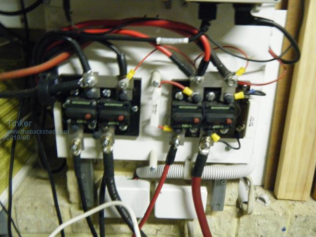

johnmc
Posted: 01:18pm 08 Apr 2019
Interesting idea, that steel washer trick.
With my set up I do not think the cabling was ever an issue nor the cause for my inverter failures.
The set up looks like this:
There are C/B in the positive and negative cables.
On top are the inputs from two solar controllers (one is a spare, not turned on) and the thick wires go directly to the battery bank.
There is a Hall sensor in the negative lead to the battery.
On the bottom of the breakers are the outputs to my two inverters, each powering a different area.
Yes, I do know these breakers are not rated for the voltage and for that reason are oversized so they do not trip. Their function is to isolate the inverters from the battery so I do not have to disconnect live cables when the inverter gets worked at. I do have dedicated DC breakers in my inverters to handle overloads.
All the cables (input & output) are quite short, ~1m max. and fairly beefy.
Both inverters still run the EG8010 / IR2110 combination and have the totem pole drivers.
Shortly the control boards will be replaced with the nano type.

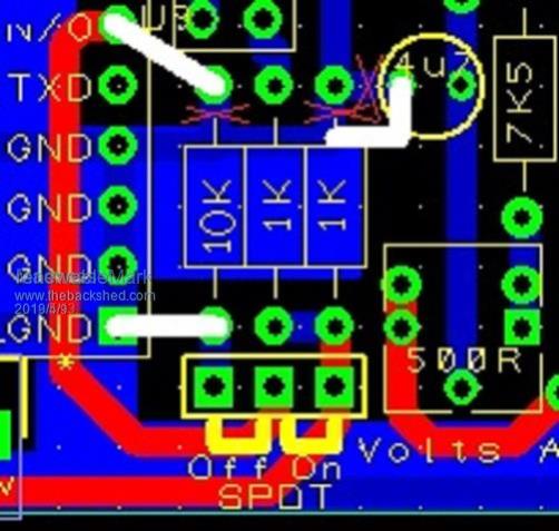

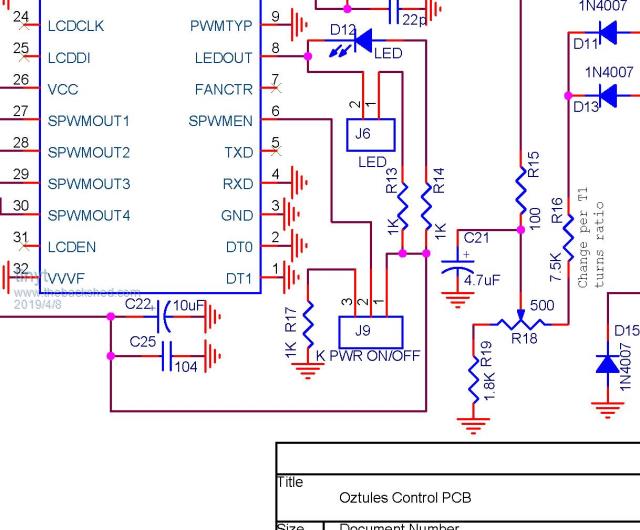

I looked at my reverse schematic of the oztules control pcb. ON - OFF control section is shown with J9 for the switch connection. If you are using this or something similar:
Assuming that an SPDT switch is used and the switch COM is at J9-2 and the other switch terminals are at J9-1 and J9-3 respectively. If the switch is operated, during the short transition time between contacts, switch COM will float to an indeterminate voltage (neither 0 or 5). Maybe this affects the EG8010.
Maybe it is better to permanently connect the 1K pull-down resistor to J9-2 and connect an SPST switch between J9-2 and J9-1 to avoid misbehavior of the EG8010.
Just my guess.

Tiny the Mad control board is different, and there was an update/fix done to the board to sort out the switch issue.
