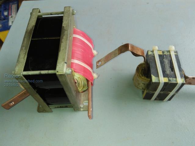

Had a little spare time the other day, decided it was time to try winding the large choke, using just the material on hand.
Started by using the 2 pair of laminated steel U Cores arranged as a double E, (similar dimensions to the large Aerosharps) only had some aluminum strap and some copper bar.
The aluminum strap was 1mm thick and about 35mm wide, so 2 strips of this would fill the space nicely.
The aluminium strap was only 3.1 meters long each, after it is (cleaned) folded around the copper bar and riveted nicely, it made up 13 turns for that size choke core, there is transformer paper between layers.
Very important to make the former bigger.
It Was a good learning process and will see if it works ok...or not.
The little choke (on the right) is 2 pair of ferrite EE cores with 4 turns 2mm X 25mm copper strap, takes some effort to bend it.
I used some hot glue to stick the cores together (not ideal) I can take it apart if its no good, Best thing is that it run's silent when I tested it last.
More details soon.

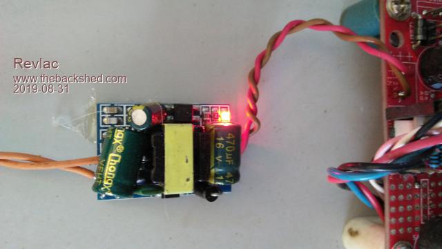

This little 5W AC-DC 12v Module has a bright red led on it, anyone else have this?
A bunch of these would make it look like a Christmas tree.

  Quote  This little 5W AC-DC 12v Module has a bright red led on it, anyone else have this?
Those little supplies all have that.

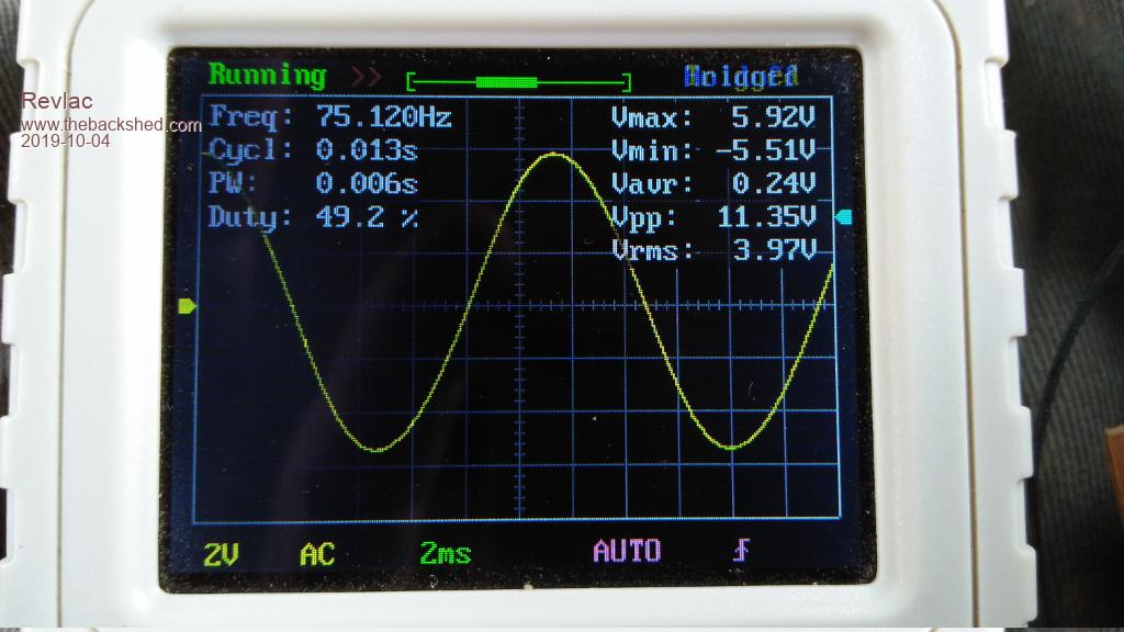

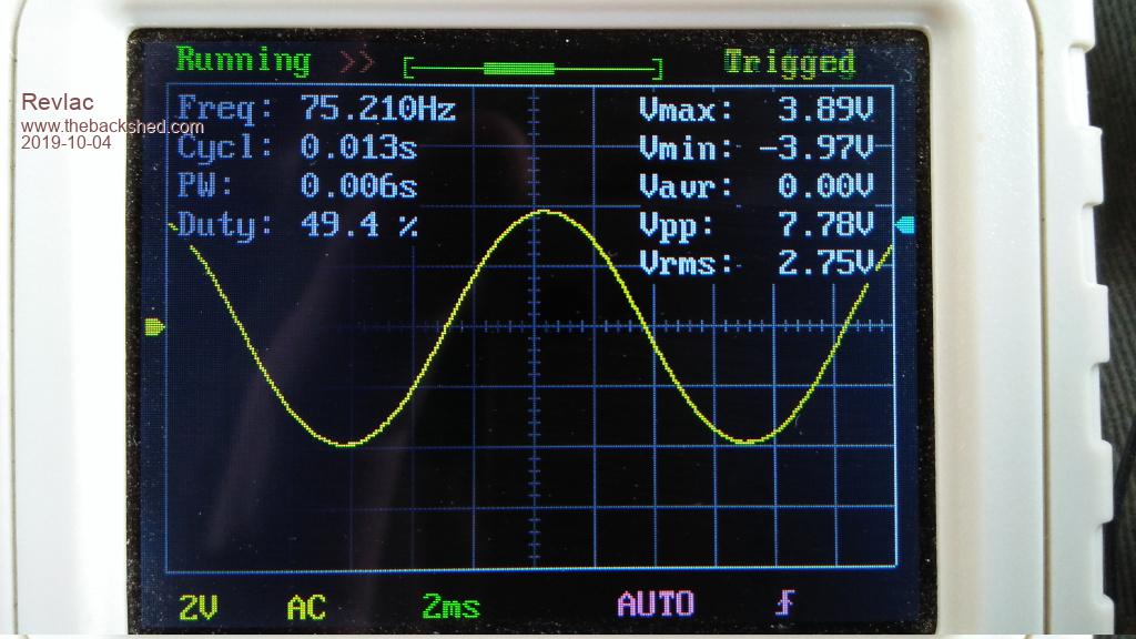

Did a little bit of testing today, trying to find the transformers resonant frequency.
I setup the little frequency generator at 75Hz and connected it to the transformer secondary (with series resistor) then checked the voltage as is, 5.19v is the benchmark with no cap connected.
Connected the 4uf cap and the voltage drops to 3.89v
After several different cap values were tested, the highest peak I could achieve is 5.92v and that was using about 1.5uf capacitance, bit lower than I was expecting.
Just to get a better picture of what was happening I tried to find what the frequency was when running the 4uf cap, turns out to be 33hz, the 8uf I had. must have been something horrible.
Not sure if I have done this correctly or not, but that's the result from using the gear that I cobbled together, using the LM324N and a few parts, its not ideal as the voltage changes with the frequency, easy just to set the frequency and then go through a selection of capacitors.
Also checked the frequency with a meter so it is correct on the little DSO...Corrected using the vertical slider on the right.
Hopefully this makes some sense.
I will try this again on the other inverter just to see how far out it might be.
Cheers Aaron
Off The Grid

Posted: 10:40am 04 Oct 2019
Good work Rev.
The way I remember Warp doing it, he set up a certain test cap on the secondary, then fed that secondary with the signal generator.
The DSO was used to observe the wave and a rotary dial on the sig generator was turned to the left and right adjusting the hz output, to find a peak in the wave.
As the hz output from the sig/gen is adjusted the wave changes shape to flatten out or get taller.
At it's tallest point that is considered the tune for that cap.
At that peak/tallest in the wave the hz was noted, if it wasn't 75, then more or less capacitance was adjusted.
Test repeated till that peak in the wave was achieved at 75hz.
I hope that was explained ok, Warp may need to clarify something.

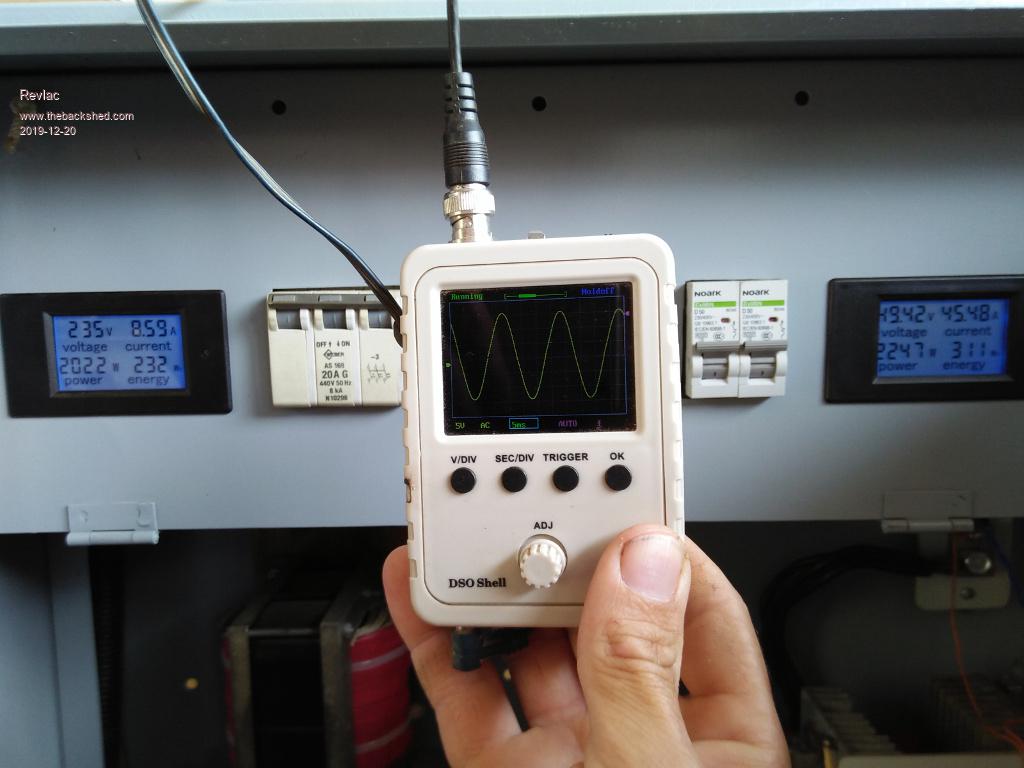

Definitely a good idea to do a tune up.
During testing, with 20fets in place, it will use a few more watts idle power than the previous one fet per leg, I was expecting a little.... However I noticed a lot of heat generated on the control board at the 120r 5W resistor and the TIP35c transistor, after some checking, found I had a 13v volt zenor at the TIP35c on the power board. don't know how I missed it but anyway after fixing that the control board regulator etc. ran cool...now the heat has moved to the power board regulator but not so hot.
I have tried a few different loads on the inverter and so far it is running quite well.
Induction motors are good and the heater is no problem, large power tools with the soft start tend to give some minor little spikes on the waveform, but really nothing compared to what the little generator puts out.
It has the best looking sine wave out of just about everything I have, just a little better than the HF inverter, Much better than my Friends inverter, a thing in a blue box.
Dose not matter how good it is looking, everything still runs well, I was just wanted to get it without any wobble or blip at zero crossing.
It is running a kettle here, this one was built for the shed powertools, starting things not so much long running loads.
Still a few things I want to fix up a little, but its been a fun build....No fets were popped in this build yet.
Cheers Aaron
Off The Grid
Chopperp
Joined: 03/01/2018
Posts: 1139
Posted: 12:29pm 20 Dec 2019
Looks good Aron.
No popped FETs; even better.
Was running the kettle for a cuppa or just testing or both?
Brian
