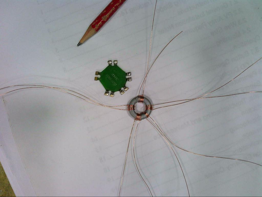

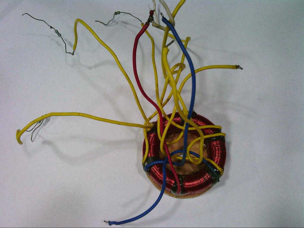

The whole issue of generating multiple isolated dc supplies can be a rather difficult nut to crack.
A couple of years ago I was asked to repair a mate's variable frequency motor drive that had stopped working. I discovered that a small glued in toroid that generated four 12v isolated supplies had broken loose and was just dangling on the very fine wires. One of these wires eventually broke and the drive stopped working. I rewound the whole thing and put it back together and the drive was then back in action again.
That started me thinking, because that little toroid put out some really nice clean well regulated square waves, and it was so very small. Several years previously I had attempted to make something similar using a much larger very high permeability ferrite toroid, and the result was truly awful, and very discouraging.
I reverse engineered that small drive toroid, and it became obvious that the plastic coated core, whatever it was, could not possibly be ferrite. I eventually worked out that it must be amorphous metal. That has enormous permeability, very high saturation flux density and it will run with comparatively few turns for what it does. In the smaller sizes its not that expensive either.
https://www.alibaba.com/product-detail/40-32-15-cased-amorphous-toroidal_1451233913.html?spm=a2700.7735675.normalList.10.78143701y8BLN8&s=p
I never pursued this any further because the little two dollar Chinese postage stamp sized power supplies are a far simpler solution for a high dc voltage inverter. But for some things amorphous metal toriods offer some really interesting possibilities.
A free sample should be available if you are interested.
Edited 2020-01-22 12:15 by Warpspeed

Tony thats a good looking jellyfish its a shame it didnt work better to reward you for your efforts
Cheers Mike
Posted: 02:45am 22 Jan 2020
Ah! but even dud projects can often be instructive.
Mike, love your Tek A6902A isolator, should go very well with your new Rigol cro.

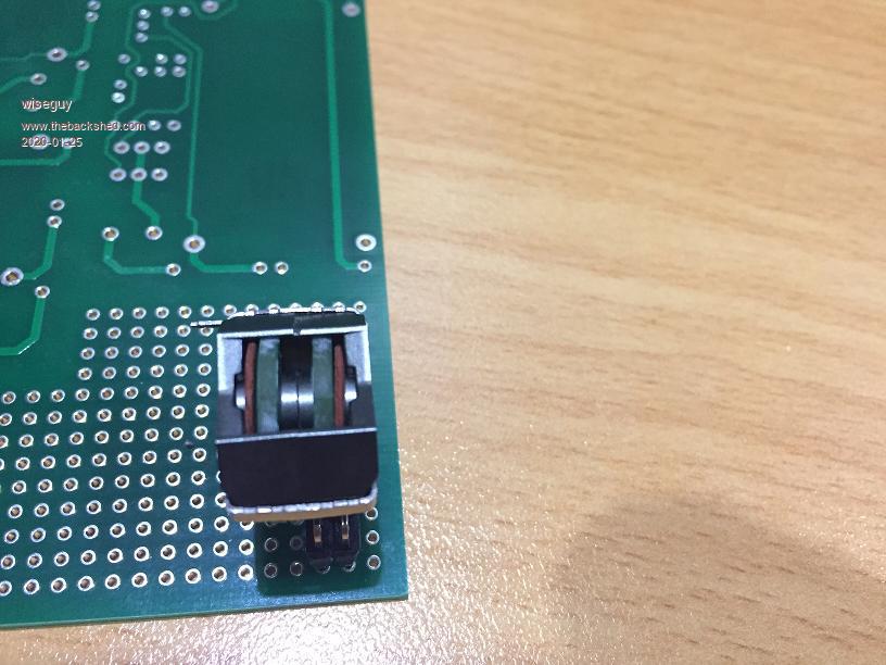

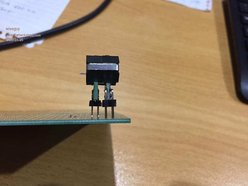

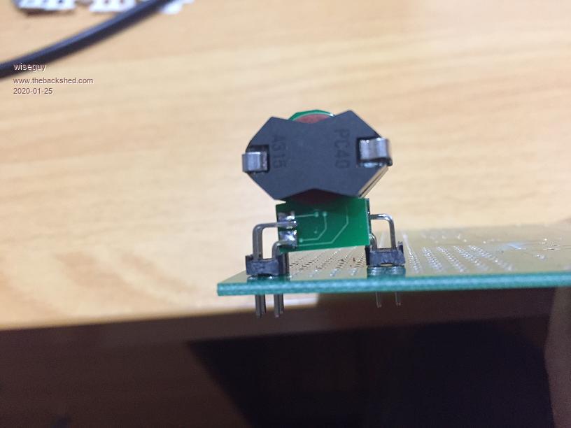

Ok finally received the 90 degree R/A 0.1" dual row header from good ol Aliexpress.  Express hey? more like slow boat from China...
Decided to assemble the little transformer for isolated Gate drive supplies as a vertical mount assembly. Total board area used is 0.7" x 0.3" or 20mm x 10mm.
Here are some pics of the finished assembly, the next step is to mount it on a PCB, add the diodes and caps and some loads to check its performance.
Note in the middle picture the 2 x red fibre washers added for insulation between the windings and the ferrite. Also note the generous gap between the 2 winding PCBs. The gap can be reduced by 2.5mm to ~ 1.2mm to reduce board area slightly (smaller parts under 10mm height can be placed under the transformer assembly closer to the small footprint mounting)
One PCB has the 2 x 8T windings for the high side FET drive circuits, the other has a 7T drive winding and the other 8T winding for the 2 low side FET drive circuits.
