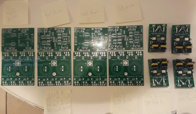

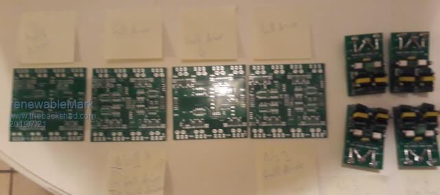

DHL delivered on Sunday afternoon! F me, pretty good service.
Anyway got the boards, they look good.
So this will be the layout.
Three power boards for No1, 1 full driver and 2 half driver boards.
One power board for No 2 full driver board.
No3&4 both have 2x Warp half driver boards.
So when the driver boards are plugged in properly above the power boards they look like this.

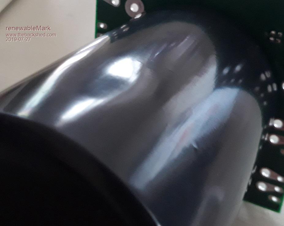

Posted: 03:08am 27 Jul 2019
Hey guys, just noticed one of my caps came with a dent on it, probably only pushed in by 1mm.
I have never used a cap with any damage before, is this anything to be worried about?
I got these from element 14, never had to send anything back yet so dunno what they are like with returns.

Posted: 03:42am 27 Jul 2019
BTW I squeezed it as hard as I could with my thumbs and couldn't put even a tiny dent in it, so it must have copped a decent knock.
I have no idea how tolerant these things are to things like that.

Posted: 05:22am 27 Jul 2019
  renewableMark said  BTW I squeezed it as hard as I could with my thumbs and couldn't put even a tiny dent in it, so it must have copped a decent knock.
I would return it, have had no issues returning fake mosfets back to Element14 and getting a refund.

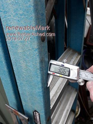

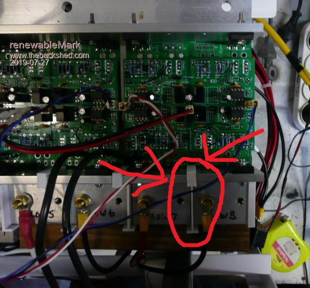

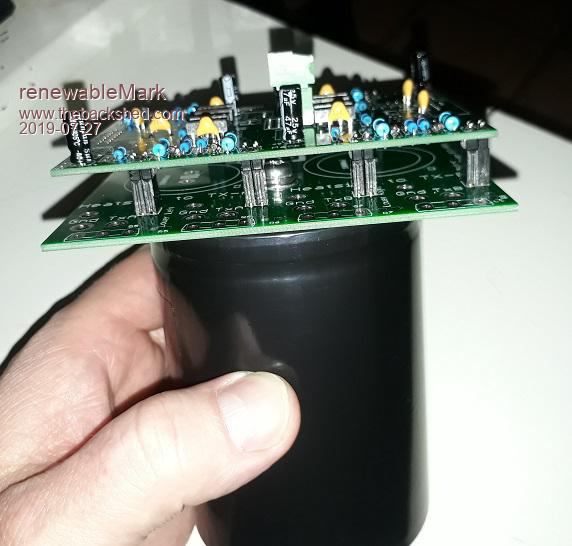

renewableMark
Joined: 09/12/2017
Posts: 1679
Posted: 10:17am 27 Jul 2019
Hey Andrew,
what is that insulating material you used there mate?
I thought I would use this old ladder that has sat behind the shed for 10 years, that should manage the heat ok yeah?
Here is a pic of the two boards together fitted with the cap.
The more I see this the more I like it, very well thought out.
Good work there Andrew.

Posted: 12:38pm 27 Jul 2019
Looking Good Mark
Thanks for the compliment. I'm glad that capacitor fits ok, boy it really makes a 100mm PCB look small
Those plastic insulators are 3D printed.
That Ladder fibreglass would be far superior, but geez that those ladders are worth a bit.
I'm happy to print some spacers up but they may not fit your job.
I cut up plastic containers and all sorts of things when I first put it together. I've not even got my heatsink warm yet, 500 watts just doesn't do it.
The insulators are only needed for the smaller bridges so I don't expect them to get overly warm. And that is because they are not rigidly mounted. I have a big 3D printer going now, so If I did it now I'd make one big plastic unit to go under the last two bridges.
I'll probably shut the inverter down if it reaches 60 something degrees C so the plastic bits should be ok.
Andrew

Posted: 11:15pm 27 Jul 2019
Yeah, the cap fits perfectly in the holes, thanks for doing that.
That ladder is just a fold out A frame, not a nice extension one.
Never get much selling it, so better off using it for something worthwhile myself.
The heatsinks will need something fairly sturdy to hold them, as they will be fitted vertically on a draw slide that will go in a locker.
Haven't worked out that design yet, was about to cut an aerosharp heatsink down yesterday, but it started to rain.
When all the bits are at hand some ideas will come to mind, was thinking something like a rectangular roof truss type layout of the fibreglass to support it all.
This unit will cop a decent hiding, my wife has no idea of spreading out loads, I have given up trying to educate her, just now she put the kettle, toaster and microwave on all at the same time.

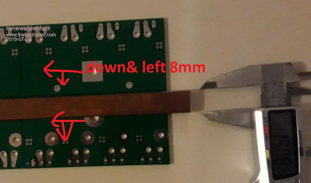

renewableMark
Joined: 09/12/2017
Posts: 1679

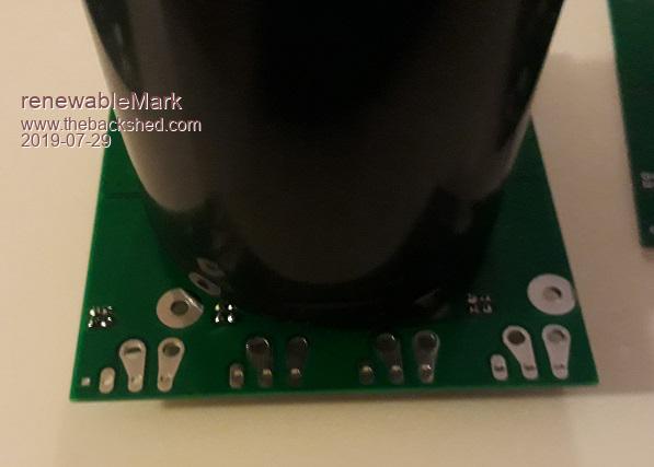

Posted: 09:50am 29 Jul 2019
Just trying to plan out how this will all fit.
Unfortunately due to my big capacitors they block the negative input pads.
I would prefer to use a copper bar anyway, but it can't fit, unless the big cap pads get moved.
So Andrew, sorry to be a major pain in the ass, but could you move the pads left 8mm and down 8mm?
I'll fix you up for your time, that is just something I don't know how to do.
Cheers Caveman Mark

Posted: 11:33am 29 Jul 2019
Don't worry about it
I'll look at it tomorrow - I'm still in PCB drawing mode I'm up to 8 PCBs in my JLCPCB shopping cart - one to go
How are you going to attach the copper bar?
Do you need additional holes to fix the bar?
Do you want an area left un-masked to contact the bar?
Andrew
