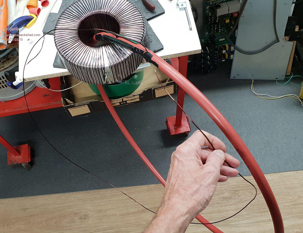

Square or rectangular wire sounds awesome, but I hate to think how much it would cost or where to even find some.
I did follow your comments and photos to twist some wire to make a secondary winding for a spot welder  ...  but of course in my usual fashion of overkill I used 20 x 1.7mm wires. It was only 2 metres long, but I'll never do that again.
Having said that, with the correct size and shape spacers I reckon I could twist it ok  ...  but needs a bit more thought put into it first  ...  and maybe an adult helper too.
  Quote  A hint for that joining, make a PVC tube center that fits exactly into the hole to align both cores as you epoxy them together. You do *not* want any mis- alignment here. You also do not want the cores to come loose as you move them around while winding so epoxying is a *must* in my book
Yes, I reckon I will do it that way. In fact I was considering using pvc tubing as the spacer between the core and the first winding anyway  ...  so I can leave it in there.

Here's a shot of my spot welder cable helper.
Cheers,  Roger

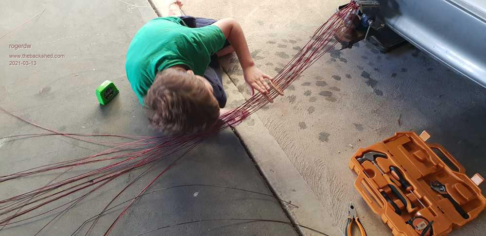

re your 20 strand twisted wire experiment, I tried something similar but fewer strands and quickly saw that holed disk idea was a waste of time if one wants a neat result. I know, somebody here did a many strand primary but it definitely was not neat.
Do do it neat, wind 6 strands around a straight (kept straight) single strand and you end up with 7 stand wire. Do another two of these and then wind the 3 x7 into 1 x 21 wire.
If you are happen to be in Perth WA you are welcome to have my 7 strand winding disk, spools & all but, of course, no wire on them
I think if my disk was much bigger diameter or perhaps had handles to provide some leverage, I might have had a better result  ...  but I like your suggestion of winding some 7 strand wire and then combining 3 of those.
I did watch some rope making videos but that would be hard to replicate with copper wire I reckon.
Looks like it may be time to spend money on some larger insulated cable and be done with it.
It's a bit hard to see from the photo but the loop of wire I'm holding is all that's left of the wire I loaded in my hoop after finishing two layers.
It was a 50 metre length unwound from a 3kW tx and I was sweating as I got close to the end worrying that I might have to join a bit on to finish my layer.
I have another 2 lengths at 52.5 metres and 57.5 metres. They should both do two layers each  ...  but do need to be longer as the diameter grows.
