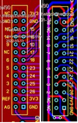

Joined: 24/12/2017
Posts: 1694
Posted: 02:14am 13 Mar 2022
Thanks for that Mick,
I just have a couple of questions:
If you have a look at the two connectors
The one on the left is from the RS485 board and the other is from the sea-of-holes board.
The pin numbers around the keyway are different. I have the feeling that the numbers on the sea-of-holes board are wrong and it has no real consequence as long as you use the numbers on the RS485 board which (I believe) are the MX170 pin numbers.
Can you please tell me what the two holes are just under the connector on the sea-of-holes board? They look like vias side by side that do the same thing (for higher current rating?). It's hard to follow the tracks in places.
I was hoping to use a connector like this:
on the underside of the sea-of-holes board to mate with the connector on the RS485 board. Do you see a problem?
Bill
Posts: 9027
Posted: 08:22am 13 Mar 2022
The number changes go deep. I've always tried to keep the maximum number of IO available but some are always used for comms and there aren't all that many available to start with.
The "sea of holes" board is labelled as all pins being available.
The 485 board needs COM1 RX, TX and EN (7, 21 & 22) for comms.
The I2C board needs I2C_SCL and I2C_SDA (17 & 18) for comms.
I2C is connected to the LH square of pins, 3V3, GND, SCL, SCA so that a 2x2 dupont connector can be used. (The RH square can take 2 vertical links: 3V3-REF and GND-AG if the internal option is set to External)
When 21 and 22 aren't available I've moved 17 & 18 to their position and consequently sacrificed I2C connectivity. That allows pins with similar functions to still be available. In your case 7,21 & 22 are in use on the bottom board so you mustn't connect to them on the top one, but 17 & 18 are passed through (albeit in the "wrong" positions), so you could add a couple of pullups and link the boards over I2C.
You should be able to stack the boards ok. You'll need 11mm spacers (it's a standard size), the holes are 3mm dia.
Good guess at the vias. Bang on. :) They should be filled really, I suppose, but these are toys so I didn't bother with that.
