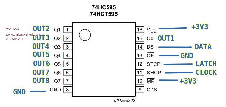

Fially I got the 74HC595 PIO program to work. Maybe not the most elegant solution.

'Connect MR to 3.3V.
'Connect OE to GND.
'disconnect ARM from GP0/1/2
setpin gp0,pio1         'SHCP: shift register clock output. Connect to pin11 on 74HC595.
setpin gp1,pio1         'STCP: storage register clock output. Connect to pin12 on 74HC595.
setpin gp2,pio1         'DS: serial data output. Connect to pin14 on 74HC595.

Posts: 6150
Posted: 07:30pm 09 Jan 2023
Hi Pluto,
I am not sure why it works. I notice that at every clock pulse you also issue a latch pulse. There is technically no objection, but normal you would only change the output when a full set of 8 bits is received. In your code every LED lights at every bit while shifting in. I have been able to make your code work on my breadboard when I make following change:

But honestly I do not like the code in line 4. In one instruction you shift out data AND you have the rising clock pulse. I know it is in the RP2040 datasheet that the SIDE SET happens later than the other parts of the instruction, but given that the pico PIO is so fast (can run at 250MHz) and the 595 shift register is limited to some 40MHz, there is a good chance that the timing is critical for the 595. The data needs to be stable (called "set up time" before the rising edge of the shift clock).
So.. it works.. but I suggest to do the rising clock edge in an instruction after the OSR shift instruction. To guarantee a controlled (by PIO clock) setup time.

Changed operation:
1. clocking in the bits into the Shift Register from OSR.
2. clocking in the bits to Storage Register from Shift Register.
This gives smoother transition on the LEDs. No flickering of the LEDs when output is changed.
Remains still a problem. LSB of the data is present on 74HC595 Q7 and MSB sets Q0.
Have struggled to get reverse order (LSB=Q0..MSB=Q7), but without success. I think this order would be more logical.

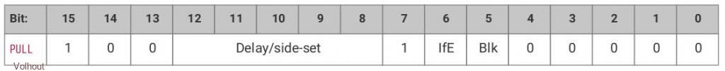

Once the data is written in the FIFO the PIO can fetch the data using the PULL instruction
The PULL instruction has a few flags and a delay parameter.
DELAY/SIDE SET : we have discussed this before
IfEMpty: we will not discuss this here
Block: When 1 the PULL instruction halts the PIO until there is data to pull from FIFO.
We have used the BLOCK flag in an earlier exercise where we generated the GATE signal for the frequency counter.

Above information results in below connection diagram for the chip.

Let's assign GP pins: CLOCK = GP0, LATCH = GP1, DATA = GP2
GP0 and GP1 will be controlled from SET instructions, GP2 from the OUT instruction. So this gives following configuration(see above):
PINCTRL 0,2,1,,,GP0,GP2

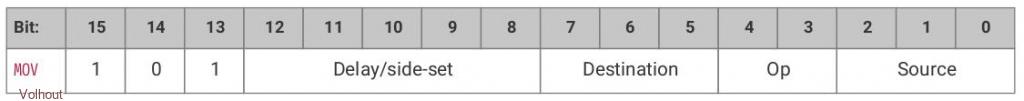

OUT pindirs 1 = 011 00000 100 00001 = 0110 0000 1000 0001 = &h6081
But we can only shift a logic "1" out OSR when there is a logic "1" in OSR. So first we have to program OSR with a "1". That may not be easy, but we can (in 1 instruction) fill OSR with all 1's, by MOV'ing an inverted NULL in it.
DESTINATION: "111" = OSR
OPERATION: "01" = INVERT
SOURCE: "011" = NULL
MOV -NULL-> OSR = 101 00000 111 01 011 = 1010 0000 1110 1011 = &hA0EB

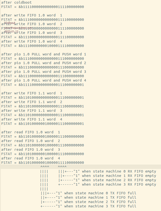

Some additional information for exchange of information exchange between PIO and MMBasic.
MMBasic has a function that can check the status of the FIFO's:
b% = PIO(FSTAT a)
a/ the PIO number (0 or 1)
b%/ 32 bit variable that holds the 16 flags of the FSTAT register.
I wrote a small program that writes and reads data from the FIFO's to check the behaviour of the flags in FSTAT.
'Check flags in FSTAT register for flow control
 dim d%=&hAA55AA55
'configure pio1
 p=0                                   'not used
 f=1e4                                 '10kHz
'address    code    mnemonics         comment
'  0      2000      WAIT GP0=0
'  1      2080      WAIT GP0=1
'  2      8080      PULL noblock
'  3      8000      PUSH noblock
'  4      0000      JMP 0
'PIO clear
pio clear 1
'program pio1
 pio program line 1,0,&h2000
 pio program line 1,1,&h2080
 pio program line 1,2,&h8080
 pio program line 1,3,&h8000
 PIO program line 1,4,&h0000
'write the configuration
 PIO init machine 1,0,f,p,,,0
'Halt the PIO from GP0 from MMBasic
 setpin gp0,dout
 pin(gp0)=0
'start the pio1 code
 PIO start 1,0
'check FSTAT behaviour when writing and pulling data
 print "after coldboot"
 print "FSTAT = &b"+bin$(PIO(FSTAT 1))
 print
 for i=1 to 4
   pio write 1,0,1,d%
   print "after write FIFO 1.0 word ";i
 next i
 print
 for i=1 to 4
   pin(gp0)=1:pause 10:pin(gp0)=0:pause 10
   print "after pio 1.0 PULL word and PUSH word";i
 next i
 print
 for i=1 to 4
   pio write 1,1,1,d%
   print "after write FIFO 1.1 word ";i
 next i
 print
 for i=1 to 4
   pio read 1,0,1,d%
   print "after read FIFO 1.0 word ";i
 next i
end
There are 8 flags that sound usable to me:
4 flags (one for each state machine) that show when there is data in the FIFO's to read from MMBasic:
RX_FIFO_empty = 1 , not empty = 0
So at a logical zero, you can read data from FIFO
4 flags (one for each state machine) that show when you can write data to the FIFO because it is not full.
TX_FIRO_full = 1, not full = 0
So at a logical zero, you can write data to FIFO

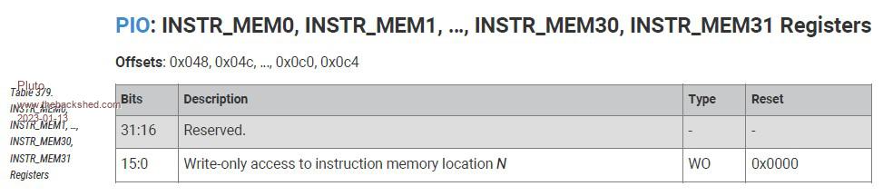

Wish I asked about the program
memory before!
Pluto
Joined: 09/06/2017
Location: Finland
Posts: 412
Posted: 06:26pm 12 Jan 2023
I hope you did not mean these.
Write-only access to instruction memory location N.
I have tried to read, but all I get is 0.
I did not find any other locations.

Hi @volhout,
A solution to your problem with FIFO being full at program restart might be here.
The FJOIN_RX and FJOIN_TX bits in the PINCTRL register description below.
When 1, RX FIFO steals the TX FIFO’s storage, and
becomes twice as deep.
TX FIFO is disabled as a result (always reads as both full
and empty).
FIFOs are flushed when this bit is changed.
Putting a POKE to set the bit and another to clear it at the start of the program should have the affect of clearing the FIFOs

@disco4now: good find, peter may use that to clear them.
Posts: 3392
Posted: 10:54pm 12 Jan 2023
Something like this for PIO 1,0 ?
addr% = &H50300000 + &H0D0
POKE BYTE addr%, 1
POKE BYTE addr%, 0
