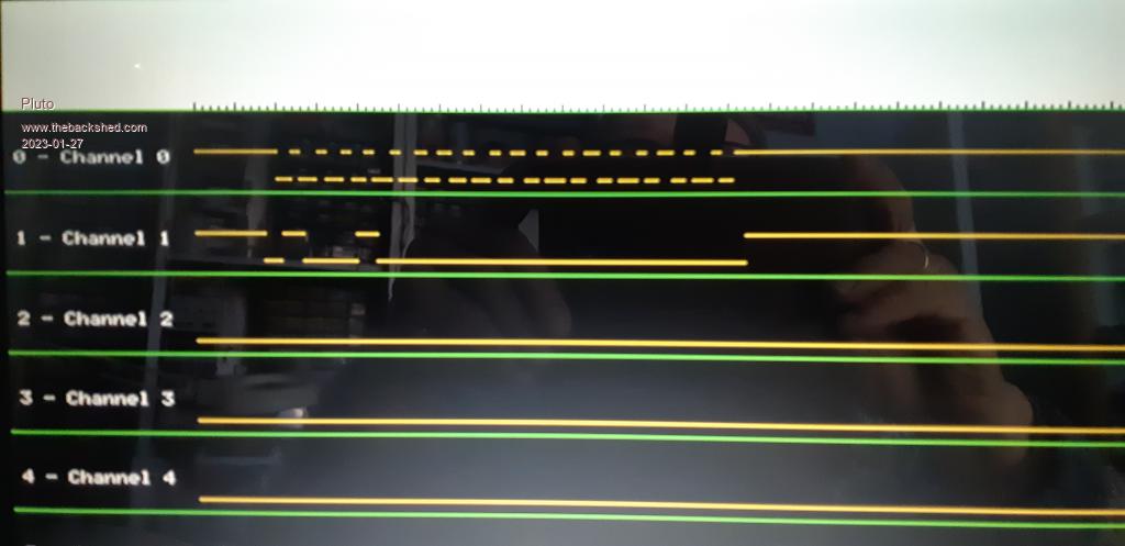

Posted: 12:13pm 27 Jan 2023
Combining Martin H's VGA idea and Volhout's PIO for Logic Analyzer:
PIO 1.0 @6MHz  PIO 1.1 @63MHz
samples% = 1024 (much more than needed for the part visible on the screen; scrolling of data in mind)
I had only a few GPIOs free on my PicoMiteVGA; using GP2 toGP7.
Picture: I2C to address &h48 with data &h00 , 400kHz. (ADT7410 I2C Temperature Sensor). I2C communication is running on a second PicoMite connected to the temperature sensor. The PicoMiteVGA-Logic Analyser is just listening to the SDA and SCL lines.
PIO 1.0 (collecting data) needs to be at min 6MHz in order to see the bits properly on the screen.
PIO 1.1 (trigger) is superb. Thanks Volhout!
Next step would be to try to scroll sidevise on the screen to see what the temperature sensor sends back. Decoding of the I2C (and other protocols) would also be nice.
Thanks to Peter, Volhout and Martin for your support and ideas!
/Pluto

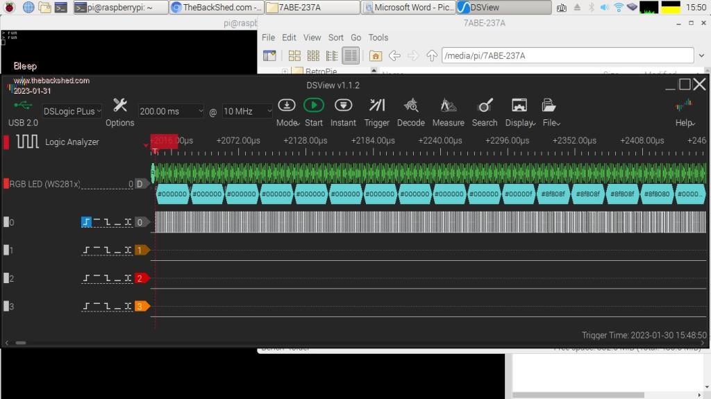

Posted: 04:30pm 30 Jan 2023
Hi Peter or Volhout,
I'm attempting to use the PIO DMA TX command to drive WS2812 LED strings.
My code used to be:-
Sub update()
Local Integer x, y=0
' Pack 4 sets of 3 bytes (RGB) into 3 32bit array elements
' So each 3 array element contains 4 led colour defs.
' RGBR,GBRG,BRGB
For x=0 To 45 Step 3
 fifo(x)=disp(y)<<8 Or disp(y+1)>>16 And &HFFFFFFFF:Inc y
 fifo(x+1)=(disp(y)<<16 Or disp(y+1)>>8)And &HFFFFFFFF:Inc y
 fifo(x+2)=(disp(y)<<24 Or disp(y+1))And &HFFFFFFFF:Inc y,2
Next
' Write out the LED colour defs to the PIO 8 at a time, buffer is 8 long.
For x=0 To 40 Step 8
 PIO WRITE 1,0,8,fifo(x),fifo(x+1),fifo(x+2),fifo(x+3),fifo(x+4),fifo(x+5),fifo(x+6),fifo(x+7) 'writes led colour
Next
PIO WRITE 1,0,1,0' Flush FiFo
'Memory Pack fifo(),pfifo(),48,32
'pfifo(24)=0' Flush FiFo
'PIO DMA TX 1,0,50,pfifo(),,,
End Sub
This produces the following logic sequence from the PIO
The first 12 LEDs are blank the the next 5 contain &H011F1F Which is correct.

I now get the logic sequence :-
Here the first 10 LED are blank and then the data is scrambled. It looks like the data is rotated or shifted in some way?
I've tried various other methods of packing the data, but so far, haven't managed to get the DMA TX to drive the LEDs correctly.
Any ideas/suggestions.
Regards, Kevin.
PS, this is using the latest VGA.

Posts: 6136
Posted: 08:32pm 30 Jan 2023
Hi Bleep,
I do not see your complete program, that would definitely help. I am most interested in the PIO program, and especially the FIFO configuration. From the "working" part I understand you are chaining FIFO's. It would definitely help to do without chained fifo's (just to make sure thatit is causing a problem). The DMA is fast enough.
I have checked the "PACK" with my own data (not RGB) but the pack seems to work Okay.
The problem I see is in the OPTION BASE
Since you use X=0 as lowest index in the fifo() array, I expect you use option base 0 (the default). The fifo array should be integer, as is the pfifo array. In my code I make sure they are integer because I add the % to the name.
Option base 0
DIM fifo%(47) 'contains the 48 32 bit values
The pfifo%() array contains the 64 bit DMA values (2 32 bit values per cell)
This array MUST be integer, because 64 bit floats cannot be stacked (2 per cell).
DIM pfifo%(23) 'contains 24 64 bit values
Now the arrays match, and the pack will line up.
But how can you (in your code) flush pfifo with
pfifo%(24)=0
This should give an error.
So I expect you have not dimension-ed the arrays correct. In which case the DMA may become confused. And if you are sending 50 values that do not line up with multiples of 24bits for the WS2812's, you can expect strange behaviour.
Please provide the complete code. Maybe there is more I can find.

Posts: 11914
Posted: 10:56pm 30 Jan 2023
It would be much better to start with a integer array of 64 elements pack it and then DMA it to the PIO. Once that is working then the rest is just Basic . Are you shifting in 24-bits per time or 32? 32 - would be by far the easiest to interface to.
i.e. send each pixel as a 32-bit value and in the pio pull in the word and shift out 24 bits with the relevant timing then pull in the next. DMA will feed as fast as you need.
Posts: 6136
Posted: 09:34am 31 Jan 2023
  matherp said  It would be much better to start with a integer array of 64 elements pack it and then DMA it to the PIO. Once that is working then the rest is just Basic . Are you shifting in 24-bits per time or 32? 32 - would be by far the easiest to interface to.
This is a good suggestion, but since Bleep is using autopull, it will be a complete re-write of the WS2812 PIO program.
Kevin, there is a requirement if you use the DMA (I have no experience with TX DMA< but this is a requirement for RX DMA, so I think it is needed for TX too).
Every time you start the DMA, the DMA will start the PIO. But the DMA will not configure the PIO. When PIO is stopped it will be at a certain instruction. DMA only starts it, it does not start at address 0.
So before starting DMA do a
PIO STOP 1,0
PIO init machine 1,0,fr0,p0,e0,f0,0
That may solve the issue.

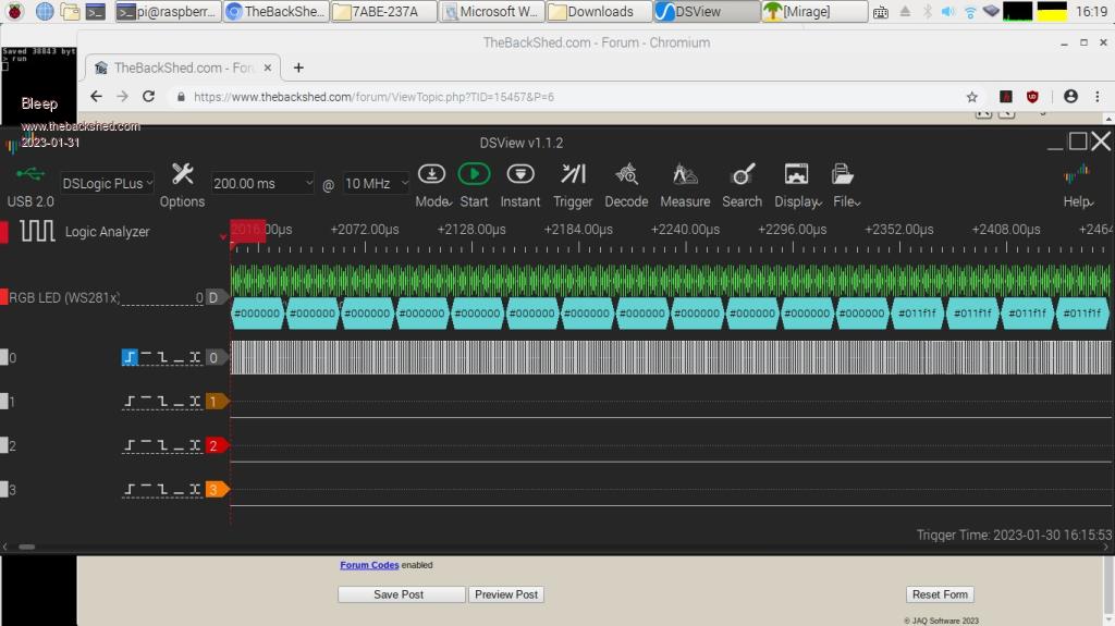

Bleep
Joined: 09/01/2022
Posts: 854
Posted: 10:45am 31 Jan 2023
PIO STOP 1,0
Hi Volhout & Peter,
Volhout has hit the nail on the head :-) it was that the DMA was starting the PIO at the wrong point, re-initialising it for each data burst is now producing the correct bit sequence.

Hi Peter Volhout,
That's worked :-) I have had to move the RGB data up by 8 bits, in my display array, which I can do while filling it, but then all I have to do is PACK it and set the PIO to auto pull after 24 bits so the last 8 bits are discarded. So I've, or rather Peter, has managed to get rid of a whole load of byte shuffling, very pleasing. :-)
And yes it's going significantly faster using the DMA. :-) So fast I had a crash, because the DMA had not finished sending, by the time the Basic was ready to send the next array of screen update!
