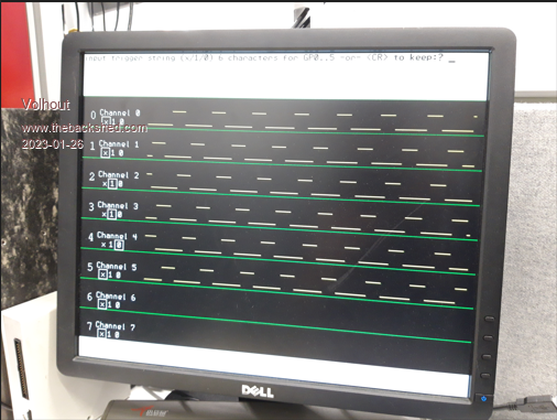

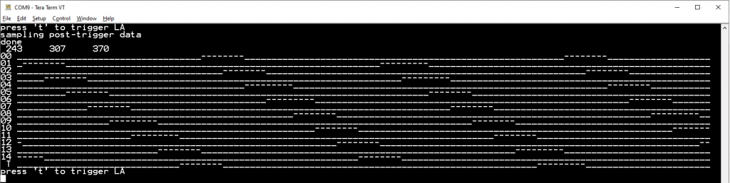

Posts: 5021
Posted: 08:35pm 24 Jan 2023
Wauw Peter,
You make me re-think the way I write PIO code. So now we have 3 ways to write PIO code: MMBasic embedded, MMedit+MMreplace, and hand assembly.
For now I just want to share the status of the logic analyzer, which is done the old manual assembly way.
The trigger is build in for the VGA picomite. There are 6 input channels (may become 8 later, but then you loose audio), and you can trigger on any logical combination of the 6 channels.
The user interface is still terminal.
For trigger you can choose "x" (don't care), "1" and "0". Type that in a string for the 6 channels.
i.e. 100001 means trigger when GP0=1, GP1=0, GP2=0, GP3=0, GP4=0, GP5=1
i.e. 1xxxxx means trigger when GP0=1
With the build in test signal some combinations will wait forever (i.e. 11xxxx) since this does not occur.
Next : add edge trigger
Next : add GUI (thanks Martin, will use yours)
The current trigger triggers guaranteed when the trigger condition is stable for 300ns. This is caused by the way the trigger works (it requires 20 PIO cycles maximum).
'problem: trigger always fires 2x in MMCC, not in putty

Edited 2023-01-25 06:41 by Volhout

  Quote  'problem: trigger always fires 2x in MMCC, not in putty
You probably have CRLF set for sending. I find LF alone is the most compatible but it does depend on the MMBasic version you are talking to.
adding a input buffer flush allows for any setting to work as expected.
   IF LEN(z$)=6 THEN
     setup_trigger_pattern
   END IF
   DO : LOOP UNTIL INKEY$ = "" ' add this line to flush keyboard buffer
Posts: 5021
Posted: 12:53pm 25 Jan 2023
Hi Jim,
Not sure what is happening. But if I choose TX is CR or LF only still it triggers twice. Maybe something linux is doing under water.
Your SW fix helps. But do't spend any effort on it since this is most likely the last version that uses terminal. VGA is soon to come.
P.S. Maybe I stop here ;-) . This logic analyzer looks like a good entry for the 2023 programming challenge, it requires no external circuits or hardware. I'm not going to be disqualified this year... Tom, are you with us...??
Edited 2023-01-25 22:55 by Volhout
