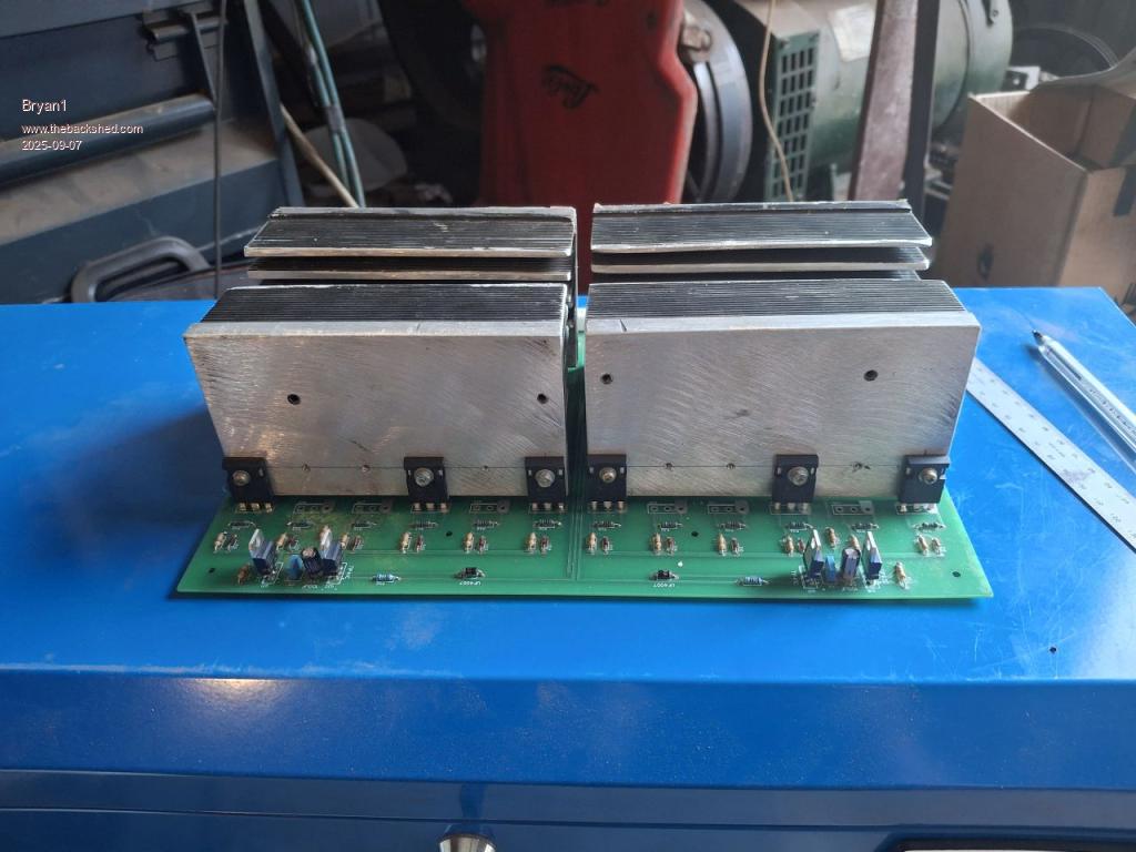

Anyway dusted all the cobwebs of the inverter board and the driver board and had jacked red back to contend with
Now as I do have the HY5608 fets I'm only going to 3 on each leg to start as if I do blow them it's only 12 fets gone to fet heaven.
Got all the passives soldered in and this morning put all the 5 watt resistors on ready to solder in.
Now with the fet spacing for the heatsinks it has been that long the grey matter has kicked in so if one does have that measurement  it could save me from doing it more than once due to incorrect spacing.

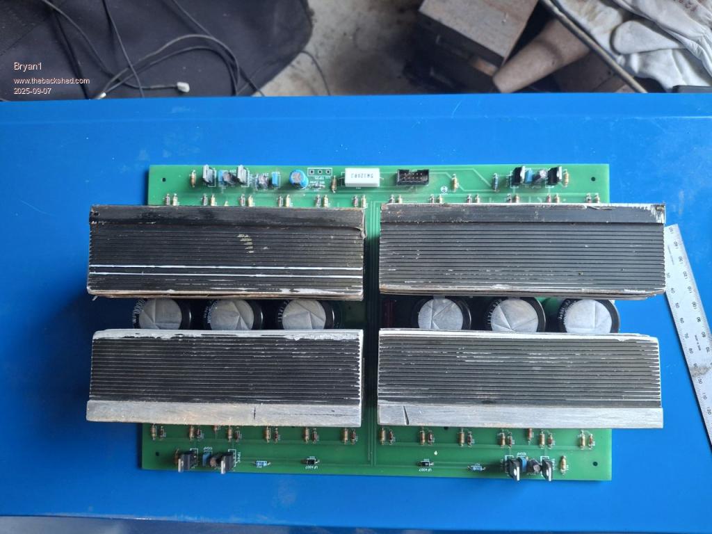

Well finally got the main board all finished   now silly me after drilling didn't take the heatsink off the mill and sure enough on the 11th hole broke a tap   O'well my 3mm taps have lasted well over 20 years   so from then on took the heatsink off and deburred it and got the rest of the holes tapped. On one heatsink the original mounting hole on the Aerosharp got in the way but eh there is no real need to use 6 HY5608 fets each rail.
I still need to make some brackets to clamp the heatsinks and it does say the low side has to be isolated but this black duck doesn't know what side that is   so once I do know I can join the heatsinks on the high side.

my 4 x 4 FET inverter is still going since about Aug 2019.
I've seen 90+ AMPS at 50V into it. probably more.
It might be a how to say.."not quite perfect design" but it does not die.
IF..
if it has enough inductance at the highest DC current input and then some
on the primary choke.
And at high frequencies too.
if there is not enough, the short high current spikes will munt the FETs.
(munt being an Un Zud saying - waves to Solar Mike)
best of luck and keep a few coldies in the fridge.

Hi Bryan, For some reason I thought you had the original Red MAD Boards, anyway I forget things as well, I have a set of these green PCB's that Poida posted on the forum some time back, haven't built the power board yet, but  have completed 2 of the controller boards, On the Power PCB (the side that has the 10 pin connector) under the heatsink on the PCB it is marked VS1 and VS2 and are split heatsinks.
Your build is looking good.

Poida our house Selectronic SA32 has been going 24/7 since'04   and my shed Kipoint inverter where I sent an email to them in '05 with the same spec's of the Selectronic they designed a 3Kw around the spec's. I also mentioned don't bother with a LCD as it die over time so it was left out.
Now as I do have a heap of those HY5608 fets I will put one more on each leg so they run nice and cool under load.

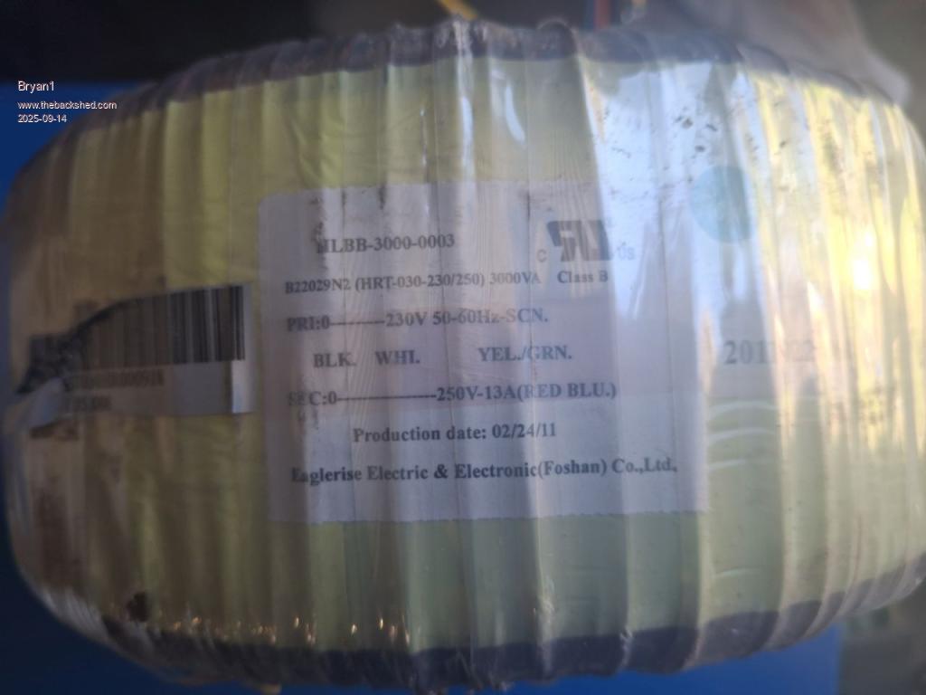

Well finally got those 2 aerosharps home and man are they heavy so tomorrows job is opening them up to look at all the goodies and get the toroids out. I reckon I will use one of the cases for this inverter project too as the case looks to have plenty of room to fit everything.
Edit: Well got the first toroid out
Now for a bit of cleanup and do the other one
Edited 2025-09-14 09:49 by Bryan1

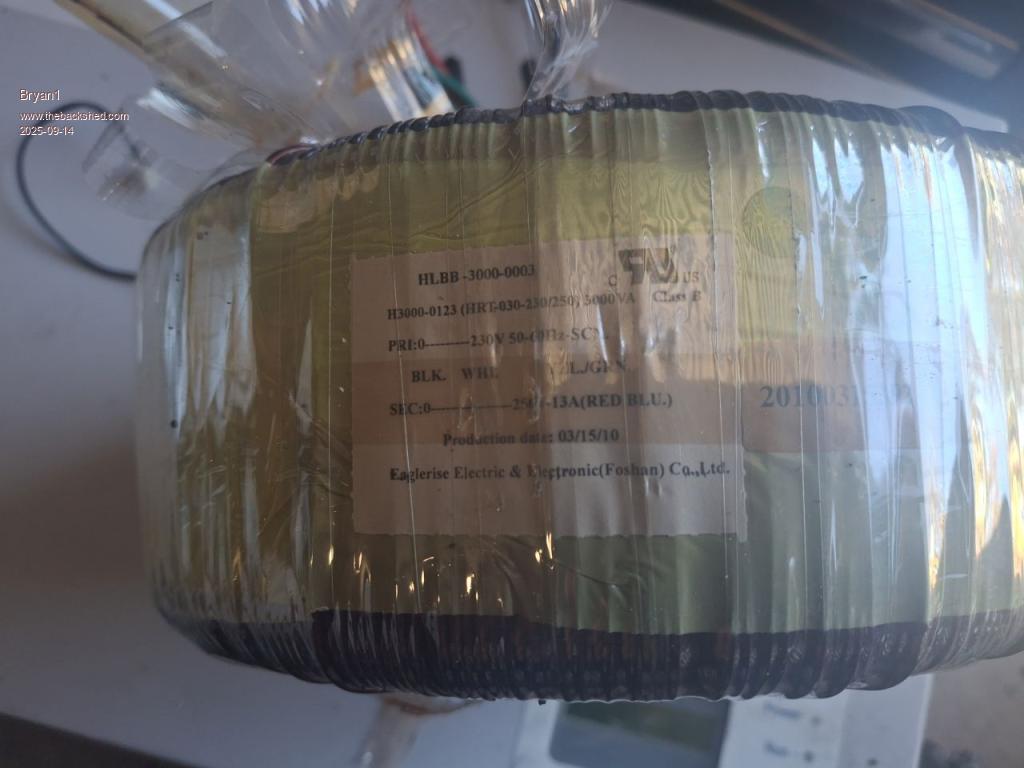

Well got the second toroid out and while stripping it I did notice it was different to the first one with the large choke being a potted one.
Now doing an ohm's check on both secondaries the difference betwwen them was 0.01 ohms where the first one was 0.26-0.27 ohms and the second 0.27-0.28 ohms
As one can see each grid tie has different build dates so I don't think it is worth the risk of stacking so just one toroid will be used.
Now once I do get this Madboard inverter finished and working the other toroid can go one one of Mike's inverter boards where I still need to get a heap of parts for that build.
Regards Bryan

It's a shame that the 250V windings are not the first winding on the cores, in any case I've started huge loads in testing with my own test aerosharp setup, using the 230v winding and 14 turn input winding, again, constant power level is only limited by the 230V winding size and how well you control the maximum core temperature under high constant loads. Of course if you decide to rewind from a bare core then you remove most of the limitations.
Very Nice cores

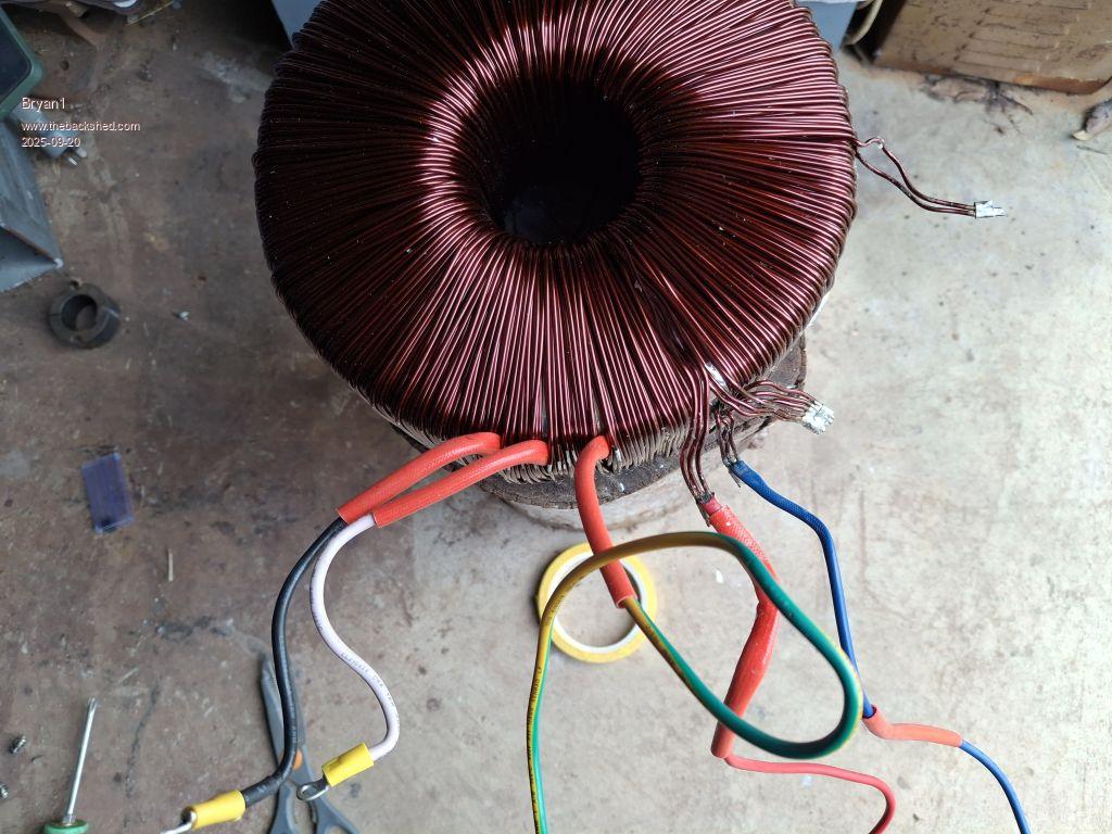

So if I have this write the 230 volt primary is wound over the secondary so I can remove the primary to make more room for fitting the new primary for the inverter

I think you will find that the 230V primary is the first winding on the core, the 250V winding (which would be ideal to use) is wound over the top of the 230v.
I could be wrong, but from memory I think this is the PRI/SEC definitions they use.

Thanks for that information Keepis   I will take the insulation off one of the toroids for a look see some time this week. I got in touch with Poida and he sent me the ino files so one step closer to getting finished.

So basically unwind the 250 volt winding to expose the 230 volt primary then splice the primary and add 10 turns the same way as the winding. Then the message states hooking it up to my inverter output to check the voltage but until I do read this all again I won't any add more detail as more than likely it will be wrong.
So this weekend I'm going to unwind one of the toroids so the primary winding is exposed then follow to the letter that PM as like I say it too good to keep private

So now each member that has one of these toroids has the information.
Regards Bryan

G'Day Guy's,
           Well got all the insulation off the 2010 toroid to show the connections and it does look like it is wound 3 inhand.
So now the task of unwinding the 250 volt wire and will update pic's as I go.
Regards Bryan
Edit: Well so far unwound about 60 metres and the tummy bones are singing out stating feed me
So to be continued in the morning
