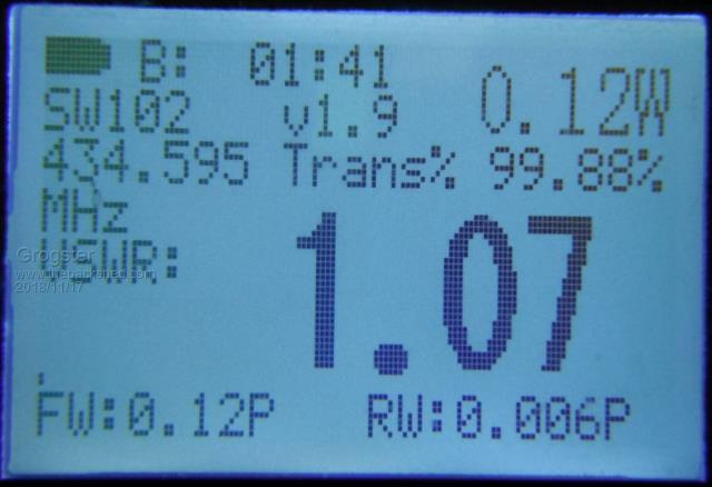

Well, I have had a chance to test both modules, and the genuine one registers fine on my SWR meter, but the clone has such a low output power, that it does not even see it - not a good sign.
Here is the genuine HC12 result:
This module is set for FU4 mode, +20dBm output, and channel 4(434.6MHz).
So, the SWR meter says we are actually getting 120mW out of it.

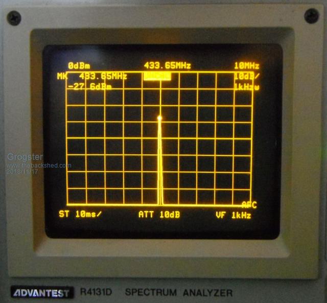

Here is the clone on the spectrum analyser:
So, yes, about -30dB down. On this scope image, the very top line is 0dBm, so the marker is showing -27.6dBm - not very good.
Data was just a stream of asterisk characters. I would manually stop the data-stream every so often, to prevent overheating the HC12 on-board regulator.
Spectrum analyser shows the CF about 433.65MHz, even though this clone module was set to channel-1, which should be 433.400MHz or so - quite a wee way off frequency, this one.... Edited by Grogster 2018-11-18

Well, that's... probably good that you've confirmed my findings, but bad in as much as the clone units - even if "on frequency" are basically useless bits of junk!
[quote]
[/quote]
What safe input can you feed your SA?
My Tek is good for +30dBm, the Rigol only +20.
Even if you did an AT+P1 to set the power to -1dBm would be a good test... (or do you absolutely trust your SWR meter? It showed the frequency WAY off... Edit: OOps, I hadn't noticed you set it to 434.6, as you were!)
I'll keep my test rig as it is and drop a 10dB attenuator in when I get the genuine modules this week and hope I see a signal of around +10dBm !!
That will really set my mind at rest!

Have a re-read of my edited post above. Both modules were set to different frequencies, as that is just how I picked them up. I don't think that invalidates the test though.
The GENUINE one was set to 434.6MHz, and the SWR meter says it thinks it is 434.595MHz, which is close enough when compared to the clones.
The CLONE one was set to 433.4MHz, and the SWR meter could not see it's transmissions at all. The spectrum analyser could see it on 433.65MHz - but at 30dB down....
I suspect that that sub-standard crystal is behind all of this. Not only is it badly off frequency(see other thread), but it is also less then half the amplitude of a genuine one. I fully expect that the crystal is used for both the frequency of operation, and as a reference for the modulation - which would explain why the signal is so weak coming out of it.

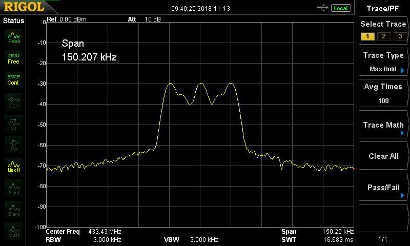

Here's one of the clone boards, original crystal. Off-frequency by 31KHz (high), and output just on -30dBm:
And after replacing the crystal, frequency is very close, signal unchanged:
Also, the range test with a beacon... I really struggled to get 40-50m range with a coil/spring antenna one end and a small whip antenna the other. Using the "halve the distance every time you reduce power by 6dB" guideline, and allowing for a modest antenna gain one end, I calculate about 14-28m range would be expected at -30dBm!
That is scarily close to what I measured (compared to the expected 1000m+ in open air, which I had for the test)
Edit: The beacon test, at 9600bps calculates out to 3m range, I was only getting 5m (indoors, but no direct obsticles, of course multipath and other noise may have come in to play).Edited by RossW 2018-11-19

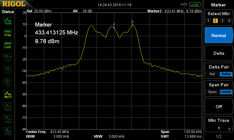

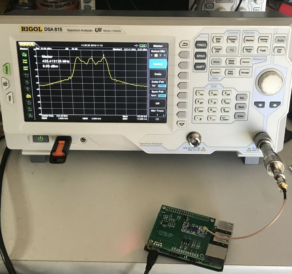

Well, the evidence is in.
The answer is now absolute.
Our shipment of genuine HC12 modules arrived a hour ago.
I've dropped one onto a board and fired it up.
As you can see, it isn't pretty:
* short IPEX->SMA(f) tail
* SMA(m)->SMA(m) adapter
* SMA(f)->N adapter
* 10.0dB precision attenuator
Connect to the Raspberry PI, check the module:
$ ./hc AT+RX
OK+B9600
OK+RC001
OK+RP:+20dBm
OK+FU3
Check firmware version:
$ ./hc AT+V
www.hc01.com HC-12 v2.6
Set it to 1200 baud and re-check parameters:
$ ./hc AT+B1200
OK+B1200
rossw@raspberrypi:~ $ ./hc 1200 AT+RX
OK+B1200
OK+RC001
OK+RP:+20dBm
OK+FU3
And then started transmitting data...
Note, it shows only 8.78dBm here (plus the 10dB attenuator makes it +18.78dBm), whereas in the photo above it had risen a little to +9.03dBm (+19.03dBm)
Given the five connections, I'd say that's about bl00dy perfect, mate!!

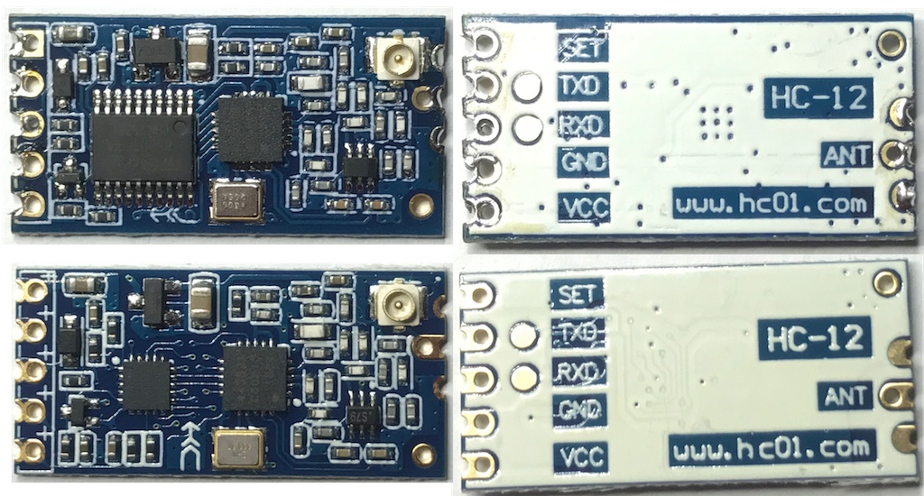

An update. Our newest batch of genuine boards straight from HC01.com is easily identified from the fakes/clones by virtue of the different processor chip!
Fake/clone at the top, Genuine at the bottom in this picture:
Additionally, we did some additional testing on some other boards.
Seems there are "degrees of bad". Some other, older, clone boards which appeared to operate with reasonable distance were found to be somewhat off frequency (25KHz or so), but replacing the crystal brought them back on spec. Checking their power, again into the spectrum analyser - and they're at about +6dBm. Down 14dB on what they should be, but still 30dB or more above some of the other clone boards!
There are clearly multiple levels of "good", "mediocre", "rubbish" and "just give me my money back!".
Hope this helps someone else!

That's interesting that they have changed the processor chip. I note several other component positional changes too. Perhaps this was done in an effort to distinguish the genuine ones from the clones. That would work in the short term, but the cloners will just clone the newer module and before too long, we'll be back in the same state of affairs. But for right here, right now, this is a good thing, and makes the genuine ones really easy to spot.
