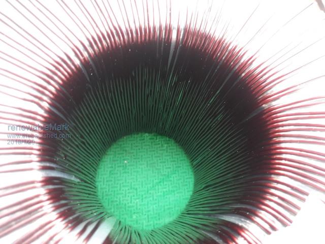

Hey Warp, I ended up unwinding that 136 as it got a bit sloppy when I slid them around, must have stretched a tiny bit. I rewound it with 128.
I see your point, but Oz reckons they don't get too hot, even Mad in the cauldron of QLD reckons his fans never go full speed.
I have already strayed from Oz's trusted design, I'm a tad wary of straying too far and my abilities to diagnose and rectify issues are no way near the capability of most people on here.

renewableMark
Joined: 09/12/2017
Posts: 1679
Posted: 05:55am 29 Jan 2018
This is the inside of the 3rd winding. Starting to look pretty tight, bit worried if I tried another the turns may need to overlap in the centre and not leave enough room for the primary.
Cheers Caveman Mark
