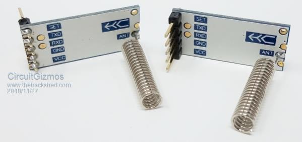

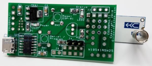

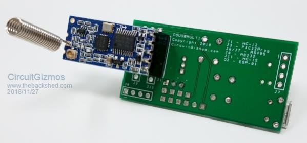

I don't doubt that I have counterfeit modules, so I should probably get some genuine modules to work with.
In documenting my CGUSBMULTI module I have some modules with the spiral antenna on the top side of the module, and some with the antenna on the bottom of the module. I don't think that this should make any difference, but I was wondering what Ross/Grogs/others might think of that.
Posts: 10109
Posted: 10:13pm 26 Nov 2018
I'm no RF expert, but I can't see any reason why that should not work. They are sold with those little helicals and that is how you are probably supposed to mount them.

RossW
Joined: 25/02/2006
Posts: 495
Posted: 10:29pm 26 Nov 2018
From the boards point of view, I don't believe it would make much difference which side the antenna came out - I have some small boards where I have it coming out the end, along the axis of the board (which is mounted vertically)
Most of my applications have the boards inside an enclosure, or metal case, so I use a "real antenna" anyway and use an IPEX->SMA tail.

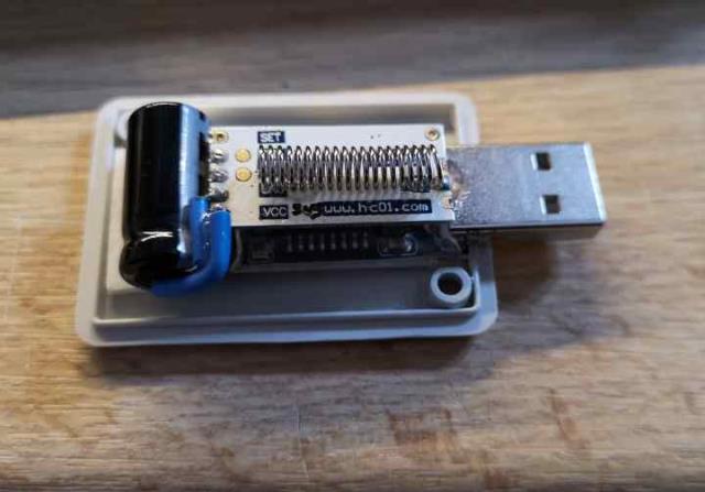

Posted: 11:15am 27 Nov 2018
I have dozens of genuine HC-12s with the antenna mounted along the back (space problems). Here is another example in my super-simple USB-433MHz adapter. I know this is far from ideal but they all work just fine so for me it is't a problem.

Posts: 10109
Posted: 10:45pm 27 Nov 2018
I see you have a big juicy electro on the power supply pins. Did you fit that, or did the USB dongle come like that?

  Grogster said   I see you have a big juicy electro on the power supply pins. Did you fit that, or did the USB dongle come like that?
I noticed that, and thought "Someone actually read the documentation!"
(It says: "It is recommended that a reservoir capacitor be provided across the power supply of at least 22uF, preferably 1000uF." which seems waaaay overkill to me. A lower value cap of decent ESR should be quite adequate unless you've got a real soggy power supply!)
Posts: 10109
Posted: 11:11pm 27 Nov 2018
I often provide a 100uF 6v3 cap on the HC12's 5v supply, but I have run them with no cap at all, and I have never had any issues....
I always use a 100uF/100n arrangement close to the HC12 power pins if I can possible get it in there - usually I can.
I wonder if there is a typo in the manual - perhaps they meant 22uF - 100uF?

Posted: 12:50am 28 Nov 2018
@Grogster, @RossW
The stack here is very simply a CH340G underneath with the HC-12 mounted on top with hot glue (I know, don't hate me!). As you noted, the PDF warns of big current req's in high power mode so I went for the biggest can I could get in the tiny case. There is also a 100nF in there too but not visible.
Four components to get a PC talking on the 433MHz network and about £5... most expensive part was the case!Edited by CaptainBoing 2018-11-29
