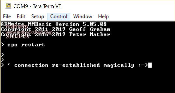

Posts: 12244
Posted: 12:00pm 28 Jul 2019
One further point. My version of W10 is fully up-to-date and there seems to have been a change in USB CDC handling.
Teraterm no longer drops the USB connection when the the STM32F407 is hardware reset, software reset, or even re-programmed. Or rather the USB connection is re-established transparently with no user involvement.
