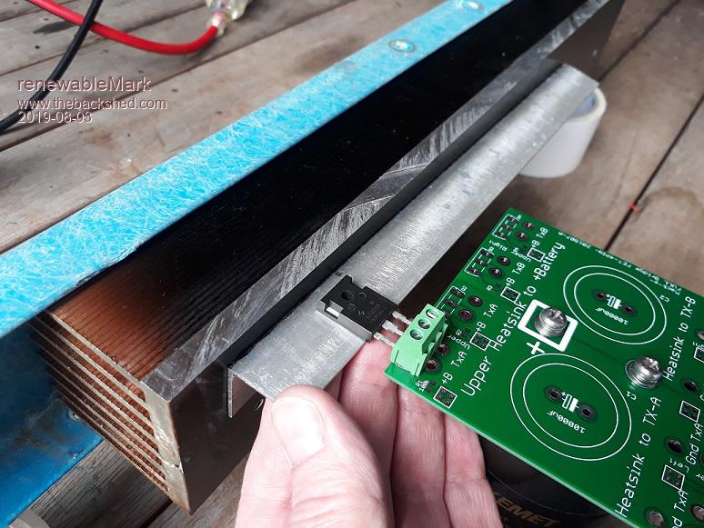

Like this, but with much thicker angle.
I like the layout of them better that way.

Screwing the fets to that angle could probably done with pan head self tappers with a spring washer too.
That would be even easier than bolting to the angle.

What I would do, is tap the holes, then use high tensile unbrako alan headed screws.
Thread them in up from underneath so that the threaded part sticks up vertical.
Those will never need to be removed. What you do then, is drop the mica insulator and mosfet onto the projecting thread, then just fit a nut on top.
The high tensile thread will never break, stretch or be damaged, and its much easier to work on just from the top as you may not be able to get your fingers underneath.
Small threaded holes into aluminium are a curse, and will strip far too easily in the smaller sizes.
If you want to make absolutely sure, a dab of epoxy under the head will guarantee it will stay secure.

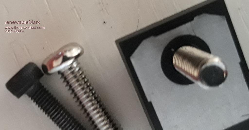

I find its easier to tap 4mm holes in the alloy and ream the 3.6mm mounting hole in the mosfet out to fit with a 4.1mm drill.

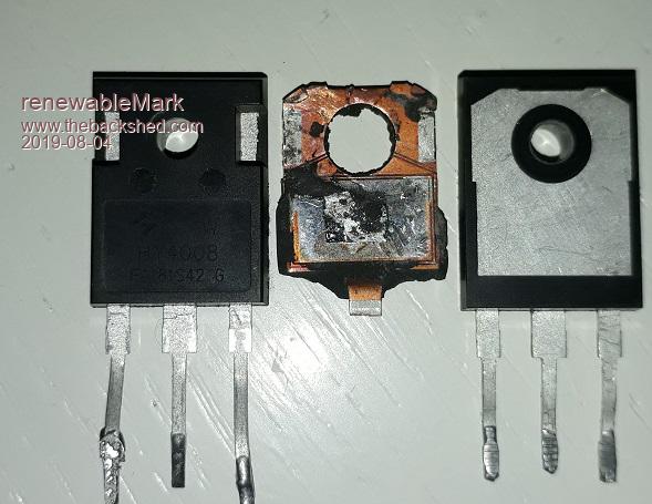

I just smashed apart a dead fet (4008).
So inside it is made of a fairly solid bit of aluminium which is connected to the drain, the front seems to have a layer of crap where the shiny bit is and the gate and drain connections sit on top of that.
So that black plastic layer at the top where the mounting hole is has no purpose?
It provides a very useful insulated sleeve between the drain and the screw when you wish to run the heat sink grounded.

That sleeve is around 1.8mm thick, so drilling like Solar Mike does should be no problem at all.
4mm tap is much more solid than 3mm.

the only different between the hy4008-B-P-W is the package case and heat dissipation. Just cracked open a hy4008B for fun.
Hy4008b - 345W max
HY4008P - 345W max
Hy4008W - 397W max

Got a 4.2mm drill bit from buggerings.
Silver bolt is a 4mm, black one for comparison is 3mm.
Fet has been drilled 4.2mm and shows plenty of the plastic insulation material is left.
Cheers Caveman Mark
Off grid eastern Melb
Posted: 02:11am 04 Aug 2019
4mm screw (just) fits through a mica insulator, so it all looks good.

Thanks Solar Mike, that's a much more solid way to mount than with 3mm bolts.

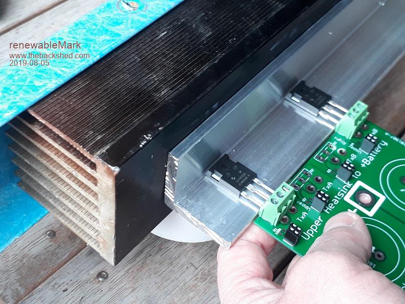

Got some 6mmx40mm.
will lay it like this, that will allow good access to the bolts and have the fets close to the main heatsink.

That Aluminium angle has a cross sectional area of 444mm^2, equivalent approx to a 200mm^2 of Copper. Well and truly good enough for a buss bar without needing to take the heatsink into consideration, no need to strip the anodising off etc.

I'll still put a copper bus bar underneath as it will be a level platform for the caps to sit on. I ended up buying a whole length as it was $20/metre or a 4m length was $40 odd. So there is plenty to use.

Hey Mark, those mosfets have a thermal copper contact surface area of approx 180mm^2, so a piece of alloy bar 6mm thick has to be 30mm long to have the same area pressing against your big finned HS. Allowing for thermal losses in the 2 junctions between the mosfet and the rt angle/HS you will need prob 40mm length of the Rt angle per mosfet. So provided your mosfets are >80mm apart its a good solution.

That is true if you wish to push the whole thing to the absolute thermal max.
One solution is to bolt the mosfets down onto a copper bar (which Mark already has). Then bolt the copper bar on top of the aluminium angle. That will spread the heat a lot better into the aluminium.
I had this problem when I bolted mosfets down onto a large 3mm sheet of aluminium. The thermal gradient directly under the mosfet was rather higher than I would have liked. A slab of copper made a very worthwhile improvement.
