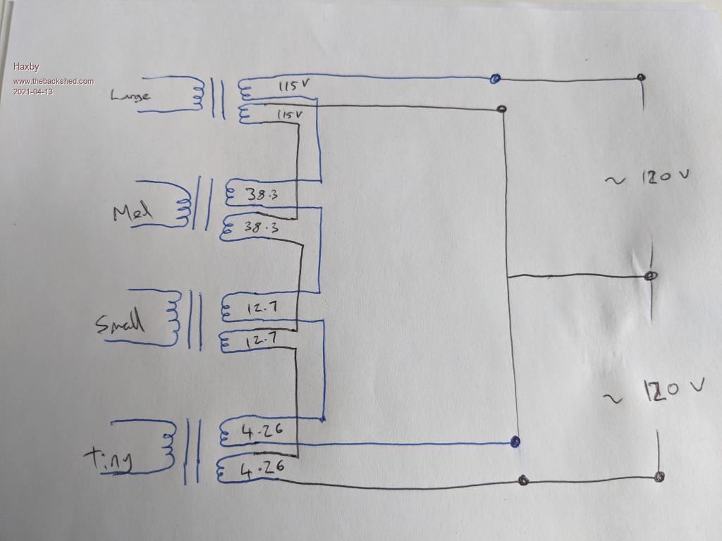

I also don't want to hijack the thread but as I read BenAndAmber's post it got me thinking about whether you would have to wind 8 transformers for a warpverter design in the USA for split phase.
Then you mention using a store-bought 1:1 toroidal isolation transformer and adding the low voltage windings through what's left of the existing hole, which gave me an idea.
If you were to use one of these transformers in a warpverter design, you would get a split phase output quite easily and you wouldn't have to wind 8 transformers for a split phase output. You would use 4 transformers but wind them as follows:
Posted: 05:14am 13 Apr 2021
Yes Phil, that is the ideal way to do split phase for an American Warpverter.
Two quite independent 120v outputs that could be connected either in parallel or series as required.
Edited 2021-04-13 15:17 by Warpspeed

Would it really be ok connected in parallel?
Haxby
Joined: 07/07/2008
Posts: 427
Posted: 05:56am 13 Apr 2021
I guess just have to be very careful with matching the windings
Posted: 06:38am 13 Apr 2021
Yes indeed !!
Very important that the turns are exactly the same on each of the secondary pairs.
But that should be easy to verify during winding.
Its no worse than running multiple layers in parallel which is what people are doing now anyway.

Yeah that's breath holding time when you power up one and check each of the others. Big sigh of relief when they all measure the same.
