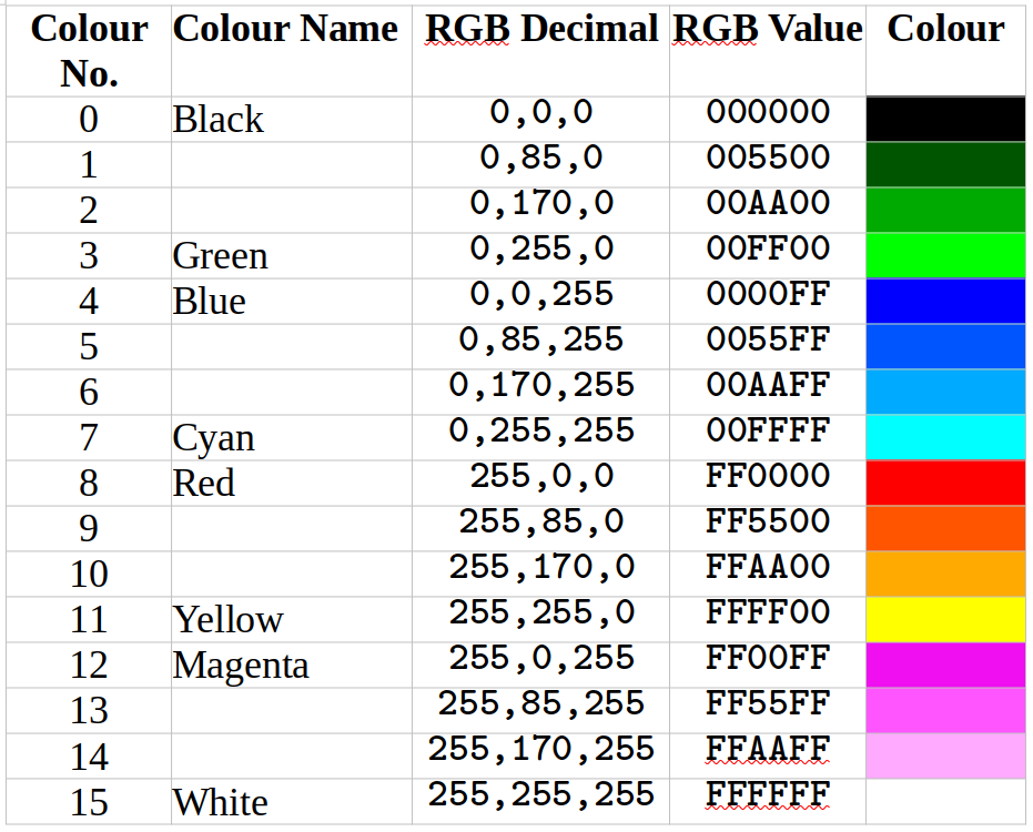

I've been playing with creation of graphics for the PicoMiteVGA.
Can I also suggest that an updated version of the manual include the colour palette mapped to the RGB values, the names, and the numbers (if that bug/feature) has been changed?
Also, I have seen conflicting information in the existing manual regarding the number of sprites supported.  Is it 32 or 64?

The RGB values are a bit pointless as they are 32 bit integers IIRC. It's far easier to use RGB(redvalue,greenvalue,bluevalue) and pop the ones that you want into an array at the beginning of your program. Then use something like cc(1) instead of RGB(yellow). There are only 16 colours anyway and no palette to choose them from.

My comment was more around the fact that there is no visible indication of what the palette looks like, just the names of the colours in the text.  I'm happy to create a table if it would help.  The 32bit values are useful if you want to create a palette in a paint program to use for preparing your graphics for use with the PicoMiteVGA.
I ended up Googling for the answer, but it would be more complete if the information was in the manual as well.  Also, some people, when converting the bits to RGB values got them wrong, assuming 0, 1/4, 3/4, 1 for levels of Green, when they are really ), 1/3, 2/3, 1.  Having it in the manual would remove any confusion.
Can the numbers of the palette entries also be used, the same as the names?  I saw a reference earlier that there is a difference between this usage on the PicoMiteVGA vs other Mites.

Here's an example of the palette table I was thinking of.  It could even include a column that shows the output levels of the corresponding pins from the Pico.
I'm not sure if this is the order that the palette is defined in or if the "Colour No." is relevent.", if indeed the colours can be specified by number.
Also, I only allocated the names that were obvious to me without Googling.  Another reason why a picture with colours would help in this situation.

Here is a colour counter that shows the colour numbers for R, G and B for each unique colour.
'Display Colour Counter - requires MISO connected to LCD_SDO
Dim a$(2)=(" Blues"," Greens"," Reds")
Dim integer b, c, n
Print
For b=0 To 2
 n=0
 For c=0 To 255
  Pixel 99,99,c<<b*8
  If Pixel(99,99)=c<<b*8 Then
   Inc n
   Print c,
  EndIf
 Next
 Print :Print n;a$(b): Print
Next
And the output for the PicoVGA
0       255
2 Blues
0       64      128     255
4 Greens
0       255
2 Reds
So for green  the 4 colours are 0  1/4  1/2  1 of maximum.
That is the top two bits from G in a 24 bit RGB value
Edited 2023-04-29 12:35 by phil99
