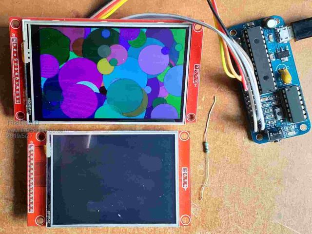

The 3.5" ILI9488 display is 480x320 pixels and RGB666 and is shown against the 2.8" ILI9341 display for comparison. Drivers are attached for the MM2 and MM+. The pinout on the display is identical to the ILI9341 and it is available from here
The MM2 driver supports all the normal drawing commands. In addition the MM+ driver supports transparent text, image load and blit.
There is one very strange thing I found on my version of the display: Touch and the SDcard share the SPI port with the display. I found that the SDO(MISO) pin on the display (SPI input from the display to the Micromite) interfered with the SD_MISO and T_DO pins even though the display wasn't selected (CS high). This could be fixed by connecting SDO(MISO) to the Micromite through a 680ohm resistor - very strange.
SDO(MISO) should not be connected for the MM2 and is only needed for the MM+ if blit or transparent text are needed. Otherwise leave it disconnected.
The display isn't very fast as there is a lot of data to move over the SPI bus (480 * 320 * 3 = 460,800 bytes) for a full screen refresh but if you need a higher resolution display on the MM2 it works nicely.
