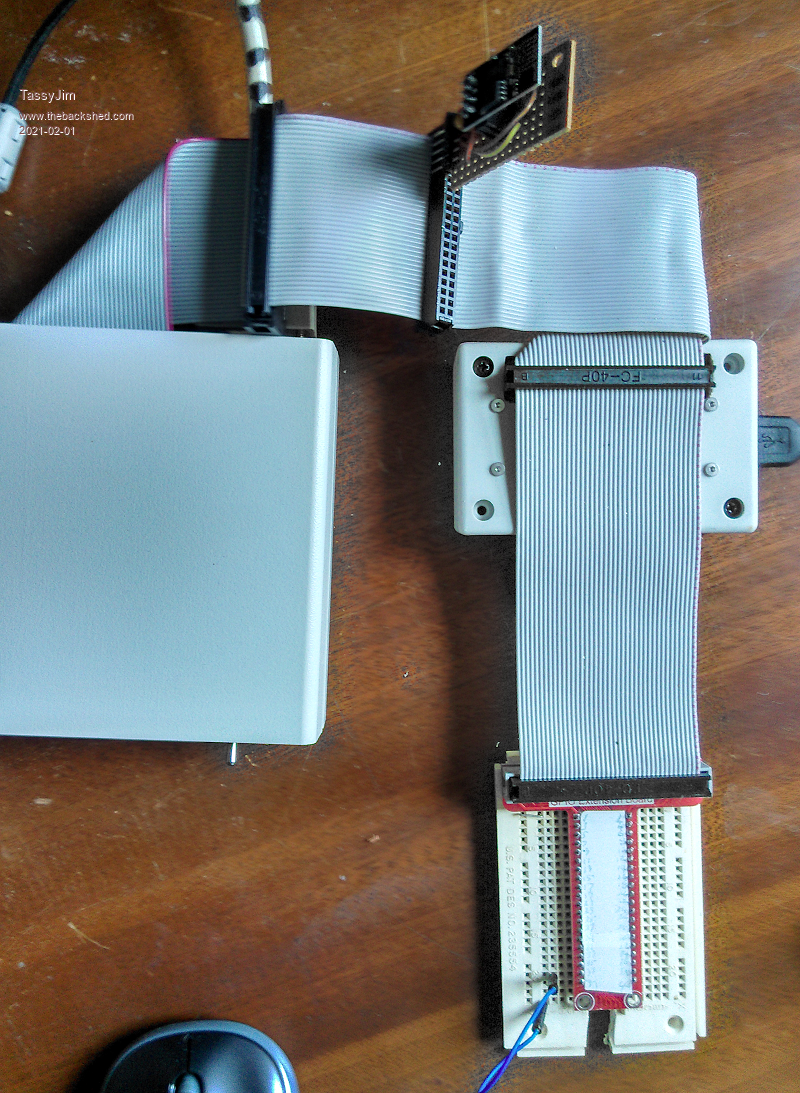

I have a supply of old IDE cables and the connectors are cheap so:
There is a short IDE extension cable attached to the CMM2 to save the main connector from rough handling.
On the first socket is the ESP8266 then comes the mouse. It's permanent so gets a box!
I might add the ESP to the mouse house.
Finally the breadboard.
I can add as many IDE connectors as required and I can always find a longer cable if needed. Just need a bigger desk.
One thing I have learnt is to only use as many pins on the strip-board as you need to connect to the IDE. Plugging in all 40 pins gets to be very tight and an unnecessary strain.
You also have to be careful using pin 40 and now pin 37. They are checked on boot-up so any load to ground should be avoided.

Posts: 6626
Posted: 09:25pm 31 Jan 2021
If you do use IDE cables, make sure it isn't an 80 core one. They are not a good choice even if the connectors do have the correct number if pins.
They have all sorts of internal bridging that will not play nicely with the CMM2.
Also, some IDE cable have one pin blanked out as a means of orienting them correctly.
There are still plenty that have all 40 pins/cores available.
Having the correct tool for adding connectors helps but I have been know to use multigrips or a vice instead.

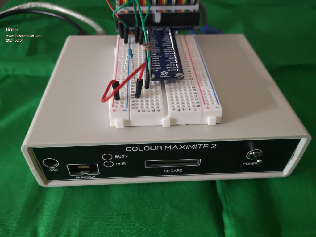

Nimue
Joined: 06/08/2020
Posts: 450
Posted: 12:08am 01 Feb 2021
My CMM2 looks like this -- ribbon cable to breadboard glued to the top of the CMM2 case -- keeps it tidy for simple prototyping..

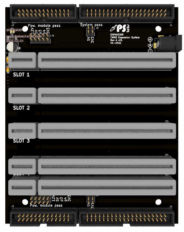

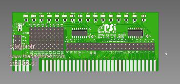

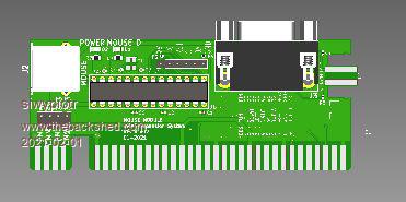

siwypiotr
Joined: 18/08/2020
Location: Poland
Posts: 127
Posted: 09:42am 01 Feb 2021

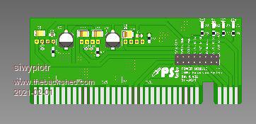

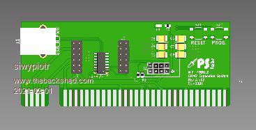

Dear Maximite fans!
In fact Im working on expansion system now. In 1 week I should have first prototype delivered.
This will consist of expansion board that will use bottom half of maximite enclosure (it will nicely stack on maximite):
Expansion can be daisy chained toogether.
It will be connected with ribbon cable with maximite. As You can notice there is additional ribbon cable. This one will carry multiple voltages and most importanly additional signals so daisy chained expansions can communicate with each other.
Module will be powered using 12 V, 12 volts rail will be available on expansion card bus, mainly it will be used for power module.
Each expansion card will have the jumper so You can choose which power supply You want  to use, from maximite or from power card.
With the first prototype order I will receive following modules:
Prototyping card
Power module
This will deliver 5v and 3v3 volts from highly efficient step down converters. This will be efficient enough to run for example relay array
Mouse, joystick and additional Nunchuk
This will use HT chip for mouse
WiFi with ESP module
This will also i nclude USB to UART chip so You can easily flash the ESP
Led array using shift registers
This is mainly to experiment with shift registers this will give a ground for card like relay arrays, they will communicate using additional ribbon cable on expansion board.
Soon I will give to public github project. This will include everything You need to design Your own expansions.
My target is to have this available in my shop in 4-5 weeks:
https://sklep.pslabs.pl/Maximite-c91
Edited 2021-02-01 19:53 by siwypiotr

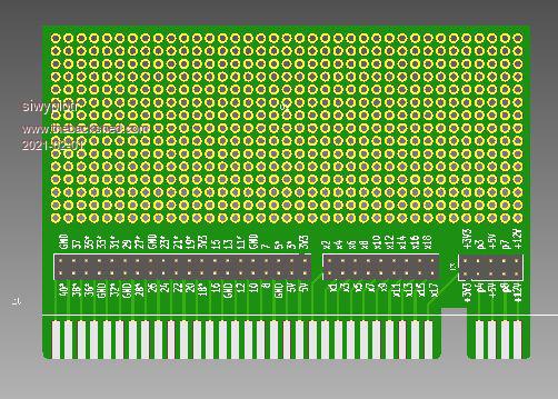

siwypiotr
Joined: 18/08/2020
Location: Poland
Posts: 127
Posted: 10:04am 01 Feb 2021
Schematic for expansions system:
exp_syst_REVA_v02.pdf
pins x1 to x20 wil carry additional signals for expansion modules communication, signals x1 to x18 are also available for next expansion system You connect.
p3, p4, p7, p8 - are free power lines that can be used in future
On jumpers J8 and J9 You can decide of the 3v3 anf 5v rail from maximite should be chained. J6 and J7 you decide if voltage rails from power module should be chained.
Edited 2021-02-01 20:10 by siwypiotr
