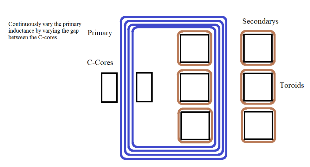

While you are still in the experimental phase, an idea to consider re series inductor:-
Extending the idea of getting some inductance by bunching the primary turns together you could then put a pair of C-cores around them for more inductance. Vary the amount by varying the gap and / or not putting the cores around all the turns.

I also like phils idea. By the way phill thanks for the observations and drawing, I will try that along the way.
At the moment I like "some" resistance between the Toriod and the driver board, I think some of the blow ups might be due to 0 gauge primary and very heavy wound chokes under nasty load glitches.

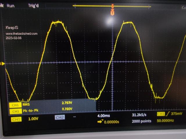

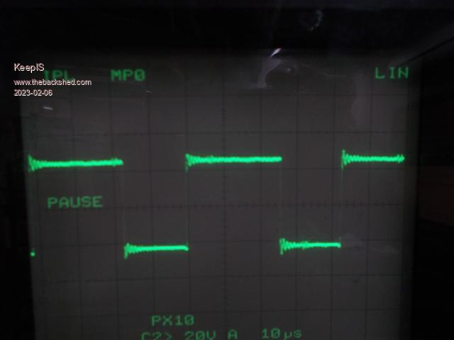

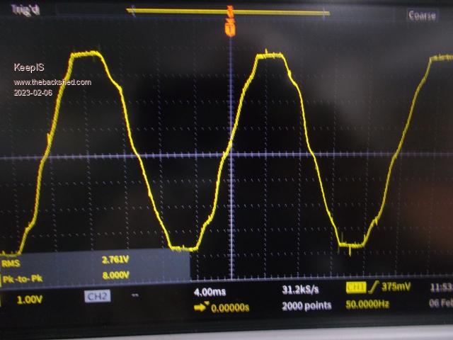

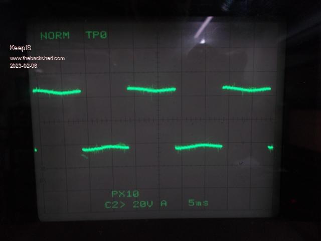

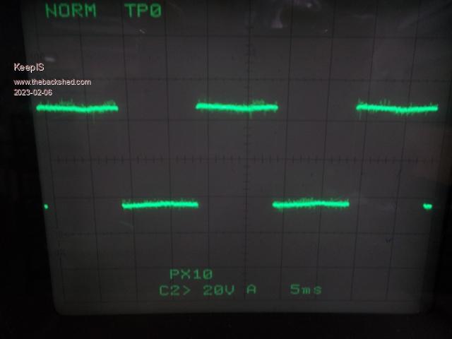

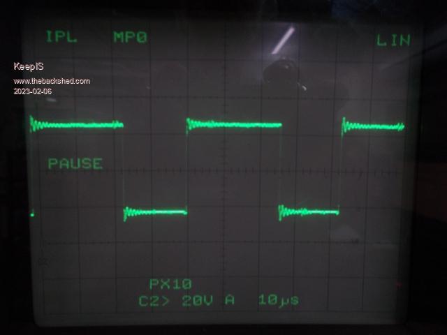

AC wave form under multiple loads:
The test inverter has been running the workshop, Inverter Air conditioner, 600w exhaust fan, computers, a few SMPS units, bit backup UPS for the computers all running and more.
(1) Normal Load is sitting at around 1.2kW
(2) Switch in another 1.8Kw for a total 3kW for 5 minutes at a time.
Tiny 55mm 12v fan sitting on the inverter board, no ducting blowing across the caps.
After continuous running time of 3.4 hours:
1: Hi side heatsink runs from cold to barely warm, barley warm being 3kW.
A: The only sound is from the E-Core choke
B: Toriod choke is silent
C: The 3 stack Toriod Transformer cores are cold and silent.
NOTE: At almost 14kW startup, the AC waveforms are NOT flattened on top or bottom.
The 3kW AC is rounder than the 1.2kW AC waveform.
Waveforms: Thoughts ?
1.2kW load.
3kW load.
1kW HI side.
3kW HI side.
1kW LO side
3kW LO side
Edited 2023-02-06 11:41 by KeepIS

Thoughts ? I reckon stop probing & poking around and put it in a box with a lid on it before you slip with a probe and it goes bang lol. I don't think you could improve it much more.
It looks like it is a totally bullet-proof inverter with quite good looking waveforms considering the various loads, and it also appears the higher the load the better the waveshape, congratulations - job well done !
Cheers Mike

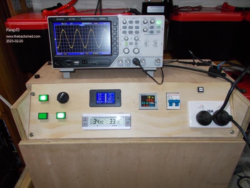

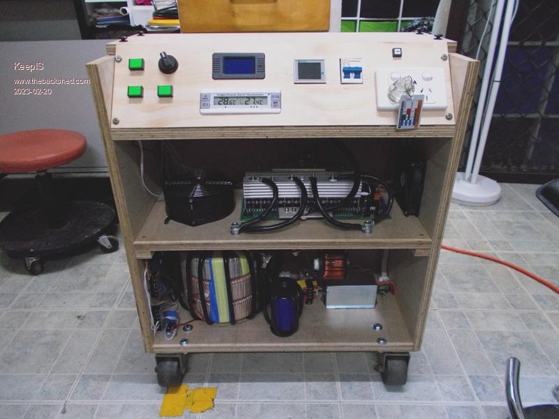

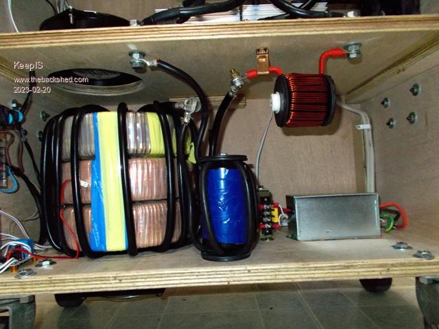

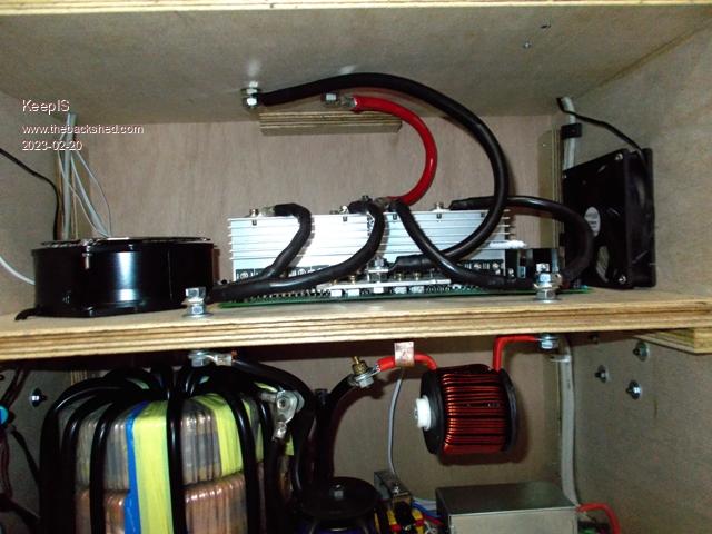

After going over all options, I decided to build a Cabinet for the Inverter out of 18mm Marine Ply.
I have used this for many large electronic builds over the years, if you don't know how to protect high current equipment then maybe it's not for you, I don't have a problem using it. I have found over many years of RF work that a metal cabinet does not automatically lead to low spurious radiation. It's a lot more complex that that.
The advantages of marine ply are a very dense material leading to high sound and vibrations insulation. The Inverter running at 3kW is silent -- I mean silent!
The airflow is through a filter and inlet fan on the right hand side of the middle compartment.
The outlet is from the bottom of the Toriod stack through the bottom of the lower  compartment.
The inlet fan is a 120mm silent fan, it runs from an auxiliary 240vac to 12vdc supply.
A second fan at the other end (LH side) of the inverter driver compartment is a large 150mm 240vac fan, it's switched via a relay driven by the over temperature Fan output of the inverter driver board. This second fan moves a lot of air and is very quite inside the sealed enclosure, it sucks air in through the silent fan inlet and drives air down into the lower Toriod compartment and through and around the toriod.
A 3rd fan is mounted on the bottom of the cabinet below the toriod, the fan is controlled by the toriod core temperature, it sucks air through and around the toriod as the hole below the toriod is 150mm diameter and the center of the toriod is completely open. I seriously doubt it will ever run.
The back and front panels are held on by finger tight 8mm raised bolts. These are hand tightened and screw into steel nut inserts. So complete access is available to work on the unit. The center shelf is removable, again using steel screw inserts.
The inverter module can be removed without disturbing any of the cabling in the Toriod and dual choke compartment. Conversely the Chokes can be modified or replaced without touching anything in the Inverter drive compartment.
Th HI and LOW connections along with the DC input are via threaded bolt connections between compartments.
The top cover, behind the sloping front panel is removable (4 screw inserts) and gives access to the Battery connection terminals and main AC connection block.
There are no connections behind the unit and nothing to move to get access to all connections.
There is a dual 15A socket on the front panel for testing and local connections.
Large heavy duty wheels make moving simple.
I've had this running all day connected to house and shed, it runs cold. The only time you can hear anything is when the stupid heat gun is on low with that bastardized waveform from a diode in series with one side of the mains.
Another day of running and testing before I convert the rest of the solar system over to 55V.
Front panel removed.
Note: Front panels and case have to be rounded over, finished and sealed.
With just the Silent inlet fan running, the air exiting the bottom of the cabinet is quite strong. The airflow path has proved to be very efficient.
Edited 2023-02-20 19:34 by KeepIS

Thanks, the 120mm Silent fan is 12v, noise is 20dba, basically I can't hear it.
The other two are 240vac.
  Murphy's friend said  I see you were having fun building this, how big is it?
3 fans?, well my first inverter required 4 . Reason, the cabinet was way too crammed.
But all the other inverters I built since have now only one fan in the cabinet. It blows air upwards, from a screened inlet at the bottom to an outlet at the top side.
That fan only cycles when ambient temperatures in my workshop are over 35 degrees   when the load is high.
Now you need to build another inverter from scratch . None of that hot running Chinese gear,
Anyway, welcome to the inverter builder club, you are one of the very few who got it going without a bang, or did you?
No I have not blown a single component, I have let the smoke out of a few cables and a CRO probe earth though. You know that just jinxed me
I wanted plenty of room around each section to make modifications, fault finding and upgrades simple.
The Cabinet is 600mm x 600mm x 300mm deep.
I gave up on drawing air from below after years of working on dust covered internals of equipment, even with filters, which end up being out of sight out of mind.
The extra two fans can also be run in series and make for an almost silent higher airflow path. The toriod transformer in this inverter is capable of easily running at 5kW for extended periods, so the extra cooling fans are for those humid 38 deg summer heat wave conditions with multiple air conditioners and fridge freezers running.
I have everything ready to build my own inverter driver. That's why it was important to make the Cabinet and inverter driver compartment as fool proof as possible when changing driver boards, no chance of disturbing and wiring in the rest of the inverter, I already have the current sensor installed ready for the new driver board.
Surprisingly this Chinese inverter runs almost cold, I have separate temperature sensors feeding the front panel readouts, one in the Toriod Core and one in the HI side heatsink just above the FETS (the warmest spot I could find)
It was 31 deg yesterday and the HI side only got to 34 deg @ 1.7kW after a few hours.
The Toriod core was basically air temperature + 1 deg, only the silent fan running, most likely the heat from the exhaust air flow cause the toriod felt cold.
Idle power is 17.6 watts. The 240V -> 12v Aux supply for the Silent Fan and temperature sensor control board consumes a total of 4.2 watts, so the total no "external" load power is 21.8 watts.
